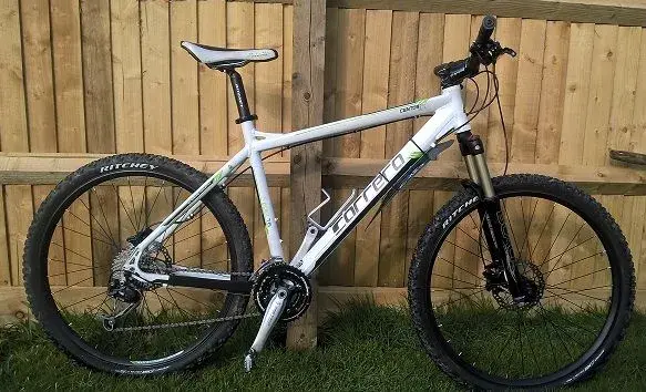

Recycled Carrera
Weigh in on creaky spring balance this evening . 13kg (28.6lb in old money). It was a whopping 15.7kg in standard spec. The Top of the Carrera range Fury was 13.1kg for this models year so I don't think I can improve much on this weight. Happy with this though 2.7kg is a lot not to be dragging around!
Change of brake to Shimano m396. Much better. Maybe need to shorten the front hose by an inch or two. I think it is finished now..maybe...at least for a bit.

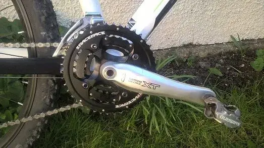

XT m770 42t ring if it stays 3x9 this will replace the Blackspire 44t
M615 Deore 2x front mech may try a 2x9
Truvativ long pin 38t and 36t 2x rings and and m770 XT 38t ring and a sram 24t inner.
Sram single ring bolts.
Not sure which way to jump really with the 2x/3x so will pobably fit the Shadow mech and lose the 44t outer initially as I am not nuts about the overstated white writing on the Blackspire rings and I don't need a 44. Still have to find a more subtle 32t one though as the only other one I have is bit worn (or try to lose the lettering).
The 2x-3x question has been closed, decided to stay 3x. Kind of swayed by ishaws nice Raceface rings....
...which look nice on m752 XT cranks, popped a new SRAM 24t inner on that was hanging around though.
Have fitted the Deore Shadow rear mech, being of uncertain heritage so I am not certain it is all straight though...more road testing will tell.
(I have no idea whether anyone is interested in this - but it is knd of nice to keep a project documented even if it only for yourself!!! :D )

if you can find a 29T or a 27T to replace the 32/22 go for the 2x9 setup. I have 42/29 on my modern GT and for the south downs I find it just about spot on
I hadn't thought of that combination. I didn't fancy 38/24 or 36/24. I have 50/34 (13-26 8sp) on one road bike wich I am not mad about and 52/39 (12-30 7sp) on the other which I find a better jump between rings. 42/29 (11-30 9sp) would be a lower equivalent (and I won't need to swap frount derailleurs either)
I thought I had finished this.
The Shadow mech seems to be ok, a very nice smooth/quiet shift so thats staying.
I like those chainrings they look nice do you have a full side on shot?
I have a deore shadow mech i like it i tried 1x9 but i went back 3x9
