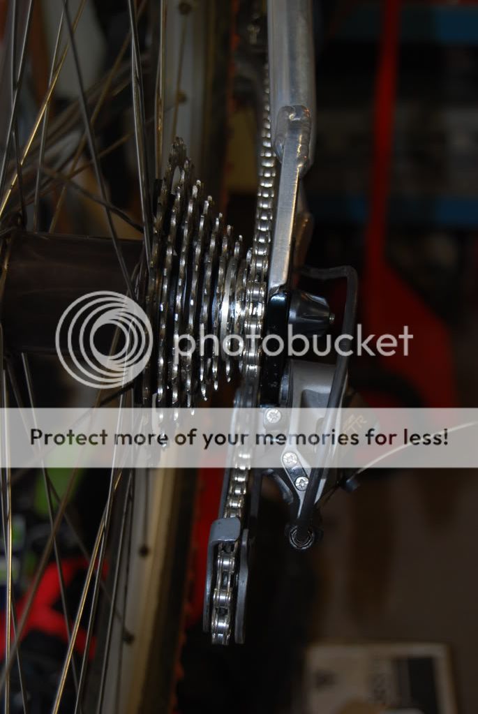

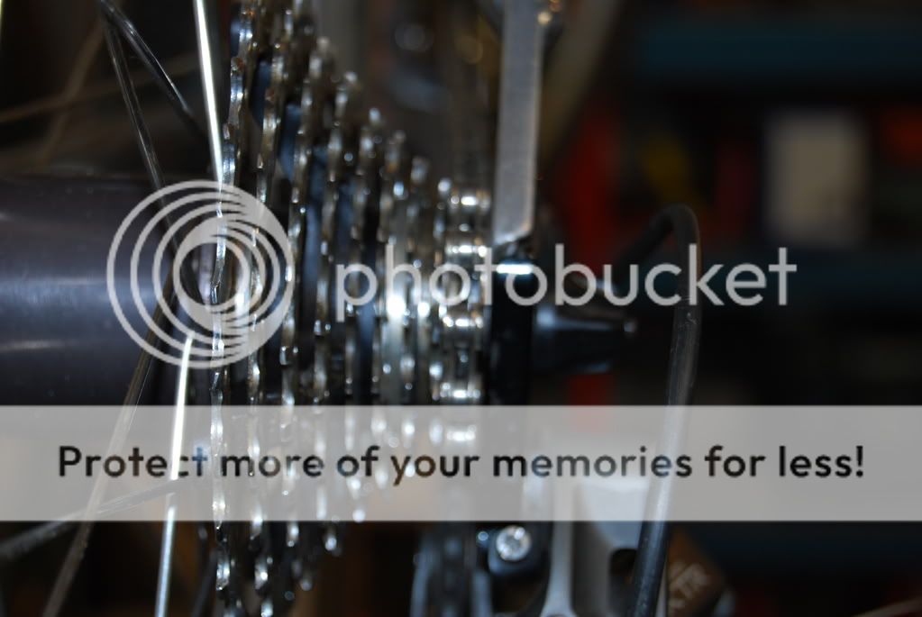

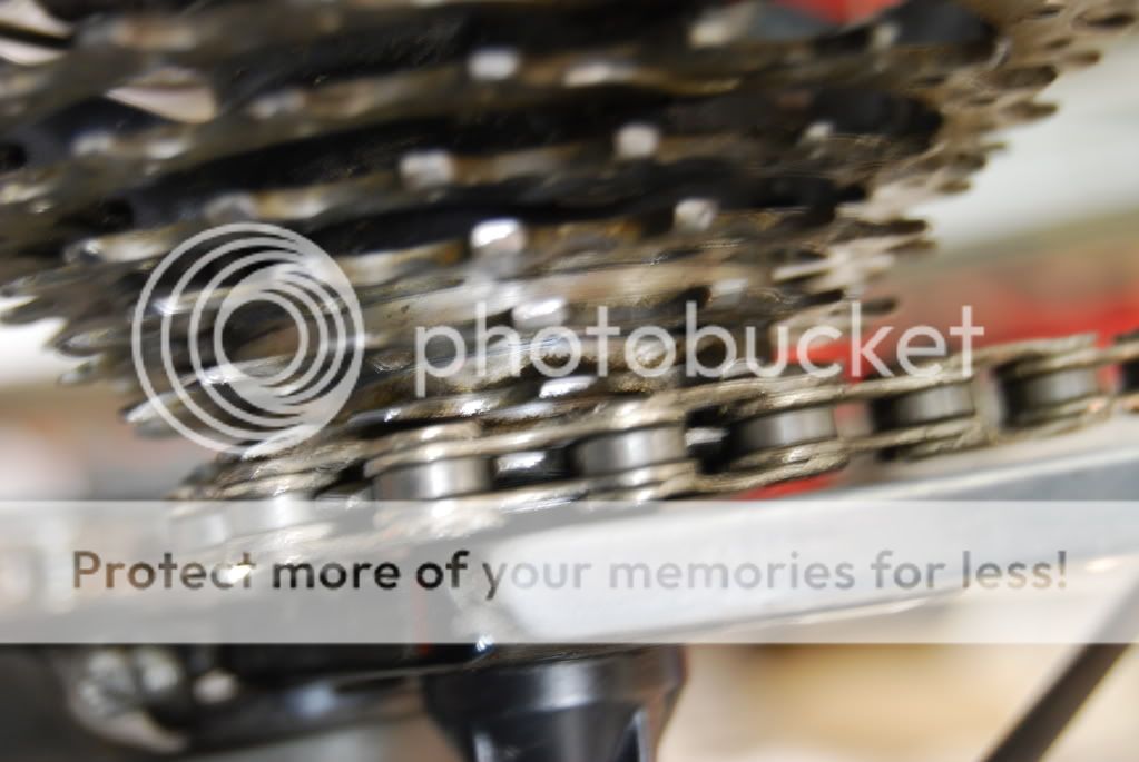

Well I have done this and all seems well but to me the chain looks VERY close to the frame/mech hanger. It doesnt touch but its a nats whisker?
Posted some pics let me know what you think?
