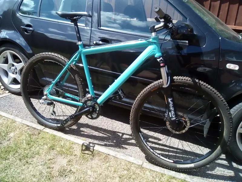

Proper paint can get expensive. I restored a pedal car for my 3 year old was a pain in the rear and cost a fortune. I have the use of a booth (more like spray room) and did it in there using 2k direct gloss, even the cheapest paint was £37 and I used works hardener and thinners.
All I can say is aerosol is fine but I would lacquer any colour you choose this will stop the colour scratching off easy.
2k direct gloss would be ok without lacquer but will only really be a solid colour.
I had my frame powder coated its a Carrera Kraken I'm guessing it was aluminium and its lasted 7 years now fine. It does chip but it was a RAL colour so in theory I could get a touch up.
