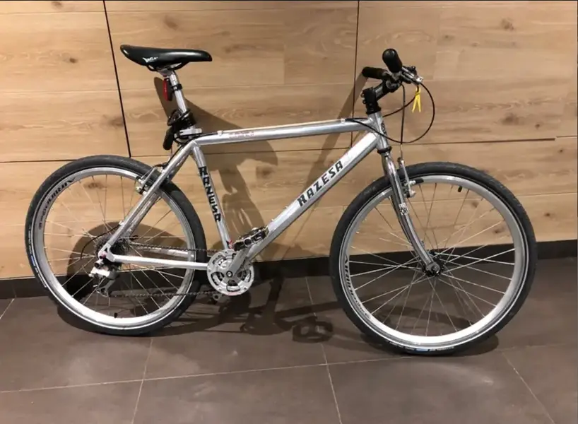

Searching on wallapop, this Razesa appeared, it was close to home, it fit the budget and the truth is that it caught my attention in the photo in the advertisement.
It was about this
So, I decided to go for it.
I saw that it had several 'buts', they had changed the stem in the ad photo for an adjustable one (a little ugly) and the purple aluminum rear closure for an old Shimano.
Also (I already knew this), the teeth of the large chainring had been filed and the front derailleur did not work, it was like a single chainring. The bike rolled and shifted very smoothly, so I decided to keep it.

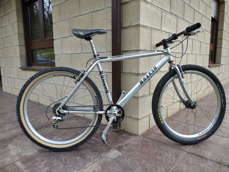

In any case, I have been putting it to my liking in the month and a half that I have had it more or less.
I replaced the Schwalbe Road Cruiser tires in 26x1'75 with some Maxxis Holly Roller tires in 26x2'2 that I had used.

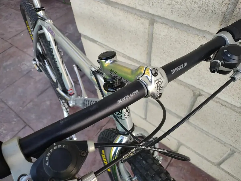

The adjustable stem gave way to a silver Ritchey Comp Lite.

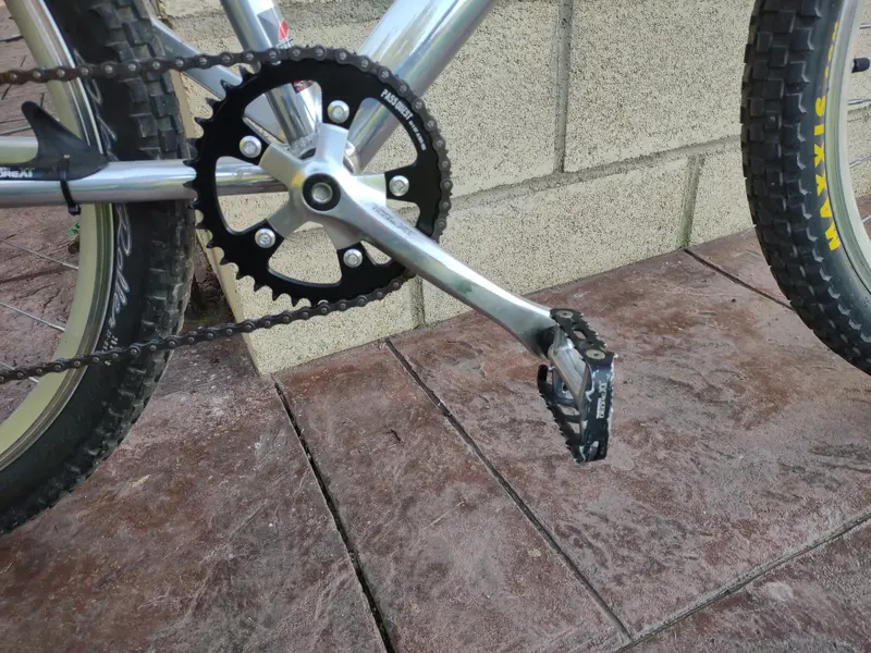

The double height handlebar was replaced by a straight Sunn Brute handlebar, but being 560mm it was shortened so it ended up with a 620mm Bontrager Super Stock
The chainrings have been replaced with a 38-tooth single chainring from Aliexpress
Shimano XT M737 Crankset
Shimano XT Pedals
Selle royal saddle
Sunn Brute seatpost adjustable in inclination
Shimano XT Shark Finn
Eleven saddle closure
I have yet to ride,
Magura HS33 brakes John Tomac edition (red) Ritchey lock grip rubber grips
The final idea with this bike includes a 1x10 gearbox and a MAG 21 fork. But little by little...

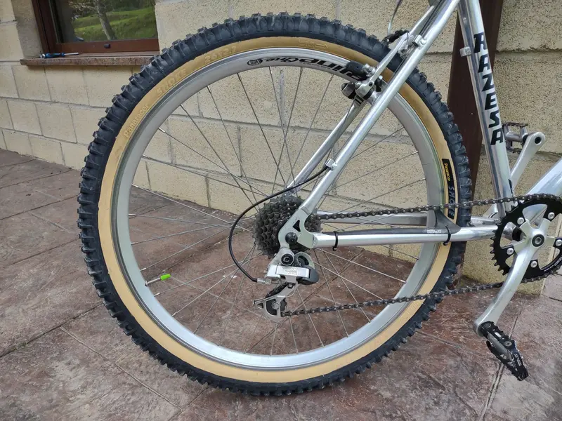

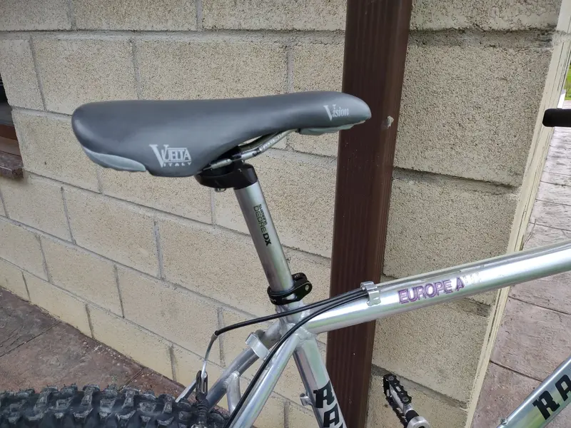

Little changes today,
Changed seatpost and seat. I think these will be the definitely ones. Seat post is Shimano DX SP-M650 and seat a Selle Bassano Vuelta
Changed rear tyre, the used Maxxis in 2.2 has been replaced with a new Panaracer in 2.1
Stem has been provisionally changed with a generic black one. Need to sell some parts and I would like to buy a Thomson Elite stem for this bike.
I've started the conversion to Magura HS33 too, but I don't have photos. Unfortunatelly the brakes where competely dissasembled and needed to take time to look internet phots and videos as I didn't have any experience with this kind of brakes.
Hope could update soon. Roadmap for this year is to finish brake conversion, change front wheel with a Dart one and get a decent stem.
Thanks for reading!

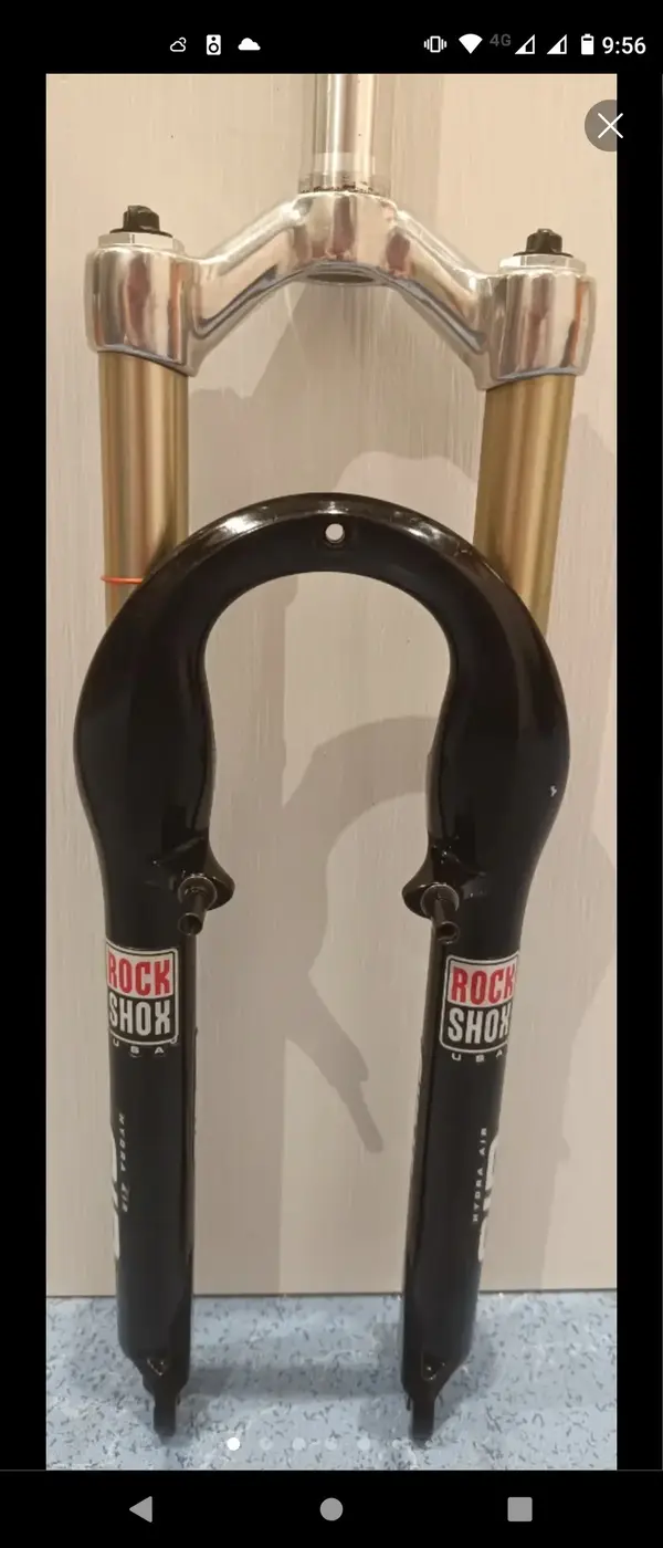

Good morning
I was almost sure of purchasing a MAG21 for this bike, but yesterday I saw this SID XC in black.
Is from year 2001 and is fully serviced for 91€+shipping
I would appreciate your opinions, if I get that SID or continue with the idea of the MAG21. The picture looks like it's from 98-99-2000
Thanks!
Finally the fork of the last reply 'flew away', and I didn't purchase it.

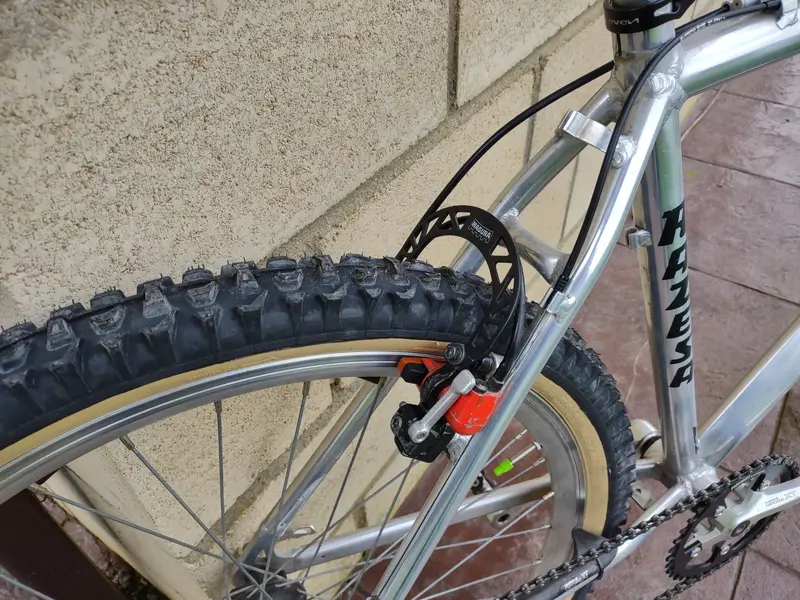

I took time today for finishing the road map of this year,

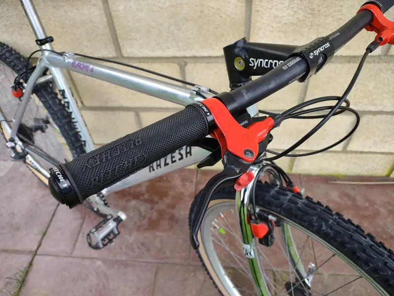

Stem was changed with a Syncros one
Front wheel changed with a Panaracer Dart
Ritchey grips
Magura HS33 brakes installed.
Rear shifter has been changed with a Shimano Altus generic one.
Original Magura pad's had been changed with a Kool Stop ones (red on the rear, black on the front). Front brake bridge is not installed as the screw provided was too short. Need to replace it with a longer one the next time I go to the country house.
Road map for 2025 is 'easy'
Change fork and direction: Probably RS Judy+Crane Creek or Ritchey
Update to 1x10 with a Shimano M4100 upgrade kit
I think I could be finished, and very usable, with this changes
Thanks for reading!

Did some little progress those weeks.
Front brake booster was installed with some larger screws.
Bougth a Crane Creek direction
I was waiting this fork;
https://www.ebay.es/itm/39601517278...tWb2EhfRlS&var=&widget_ver=artemis&media=COPY
But seems that has been lost in the shipping. So probably will spend the refund money on the Shimano M4100 upgrade kit.
I have been riding the bike too, the brake power of the Maguras is a great upgrade from the V-brakes, need to adapt to them.

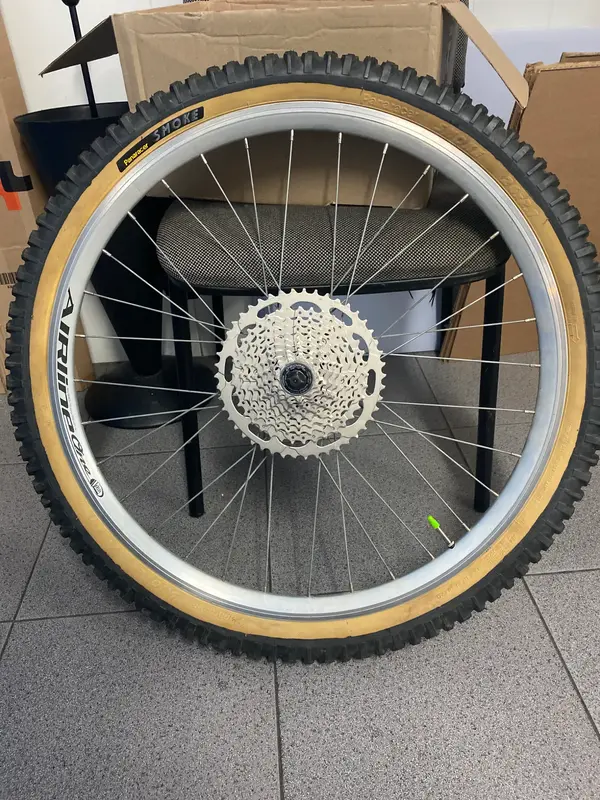

Hi there!
After some months without any work on the bike (just use), I’ve finally bougth an Shimano M4100 10V kit, so started to mount.
Luckily casette has been just bolt on, as the hubs where compatible (someone upgraded the hubs in the past)
But I’ve facing some issues with the rear derailleur as I’m not able to bolt it to the end. Need to check it with time.
I will update with news
