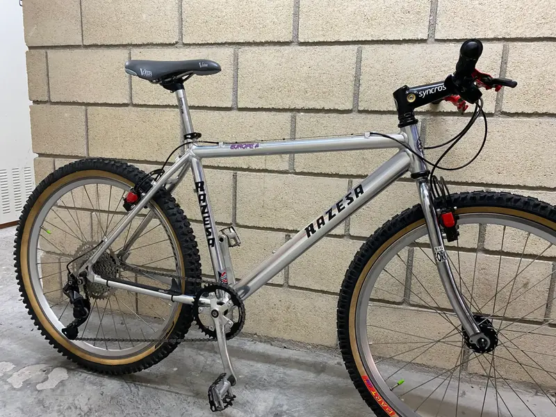

Razesa from late 90's or early 2000

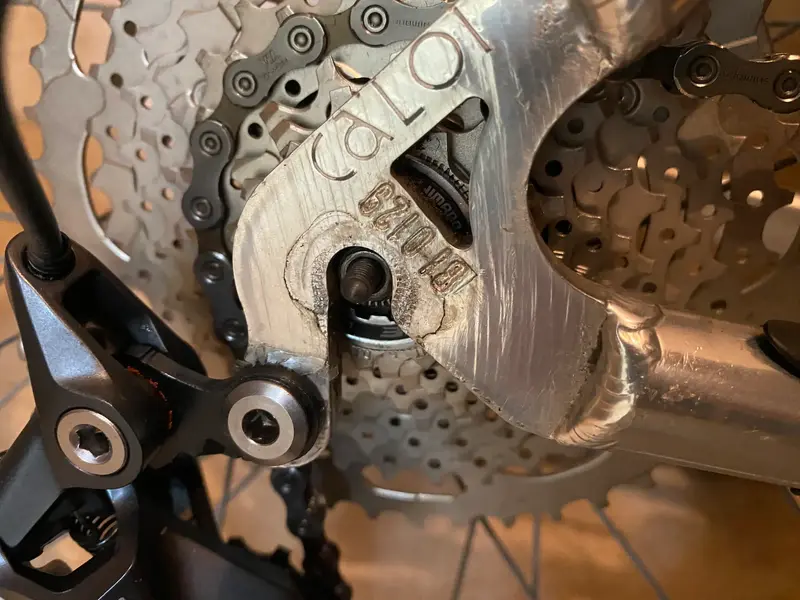

Did you find a frame number on it? Might help with the date and manufacturer. Certainly be useful for my records.
Frame number could be B10129 or BI 0129 as you say. Either way, its not the Asian style number I was expecting. I think I need to look into Caloi some more.

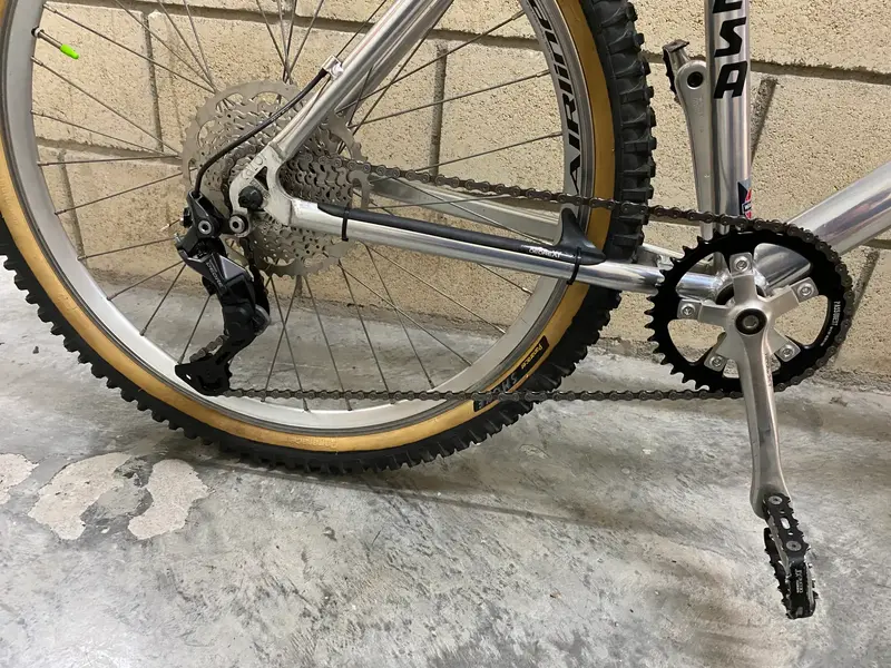

Due to the rear canti hangar, I'd say the frame is no later than 1997. The lack of any head/down tube gussets and non-replaceable mech hangar would also date it earlier, it could be anything from 1990 to 95 age.

Thanks for your input. It would be great to know the year of production, just for reference, although the bike should be at least 25 years old.
I have used the photo and sent it to Caloi, in case a technician willing to investigate the records can give me more information about the frame, since, initially, Caloi has not been a brand with expansion in Spain and I would like to know what the traceability of the frame has been.

Maybe this SN style? (Is on the other side)

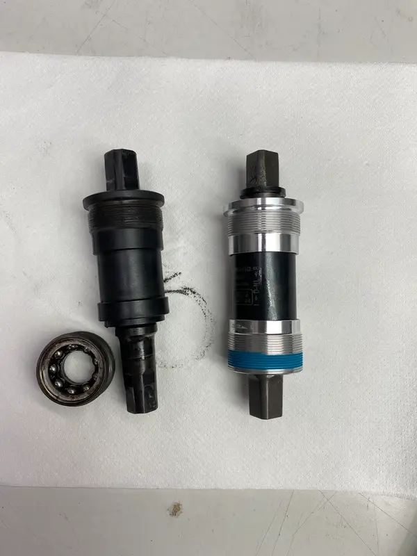

Hi,
Few changes, new Shimano bottom bracket with sealed bearing instead of the unknown BB with open bearing
