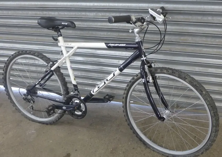

I managed to find this 2000 - 2001 GT Palomar for £35 for the complete bike.
This would be my foundation. Believe me it’s looking a lot more interesting now 😬

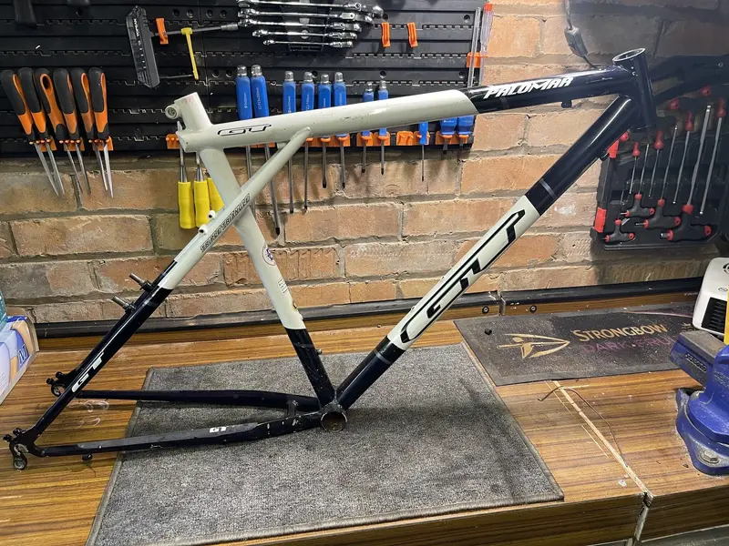

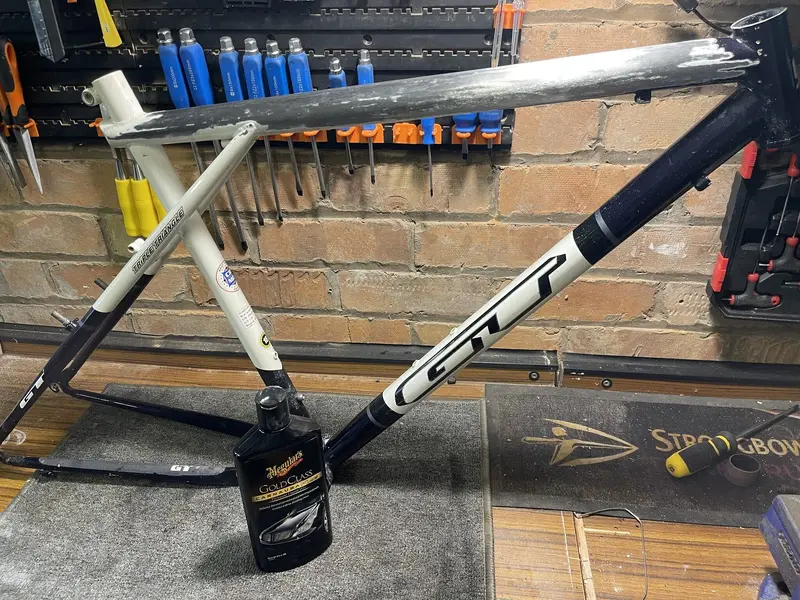

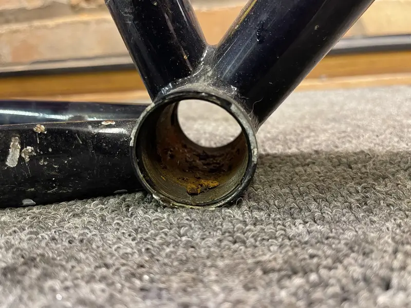

The first job was to strip the bike down completely
1. So I could service any parts I wanted to keep
2. So I could do something about the paint job, which I’m not a fan of.

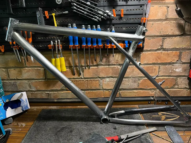

At this point I decided ‘sod it’ and attached a sanding wheel to my drill…
“Placeholder for a witty comment about how strong the polish is”

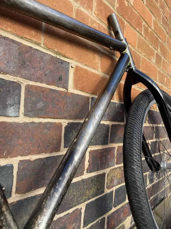

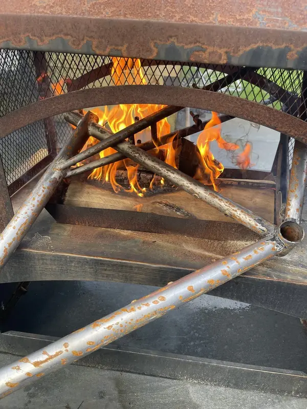

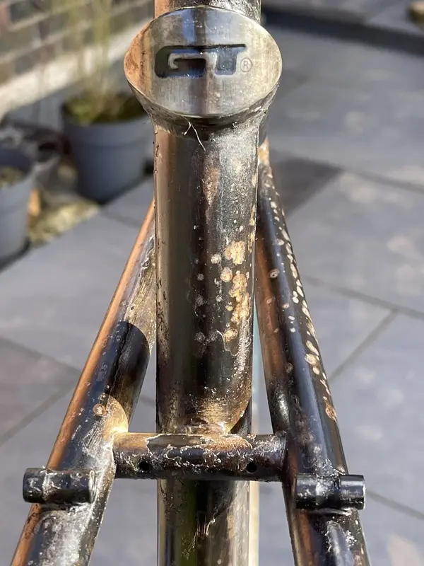

On a serious note, I figured with little budget for a paint job I’d go down the rat look route. I’ve done this in the past with a steel trials bike frame. But I actually stripped that, left it raw in the garden for a few weeks to get some natural rust then clear coated.
But this build has to be complete by the 29th of Feb, I didn’t have time on my side. So having read about what I needed to promote rust, I improvised, using a mix of 2 parts bleach to one part malt vinegar 🤣 - smothered it in the frame, left it over night and sure enough in the morning it had ‘blobs’ of orange rust all over it. But I wanted more, something that wasn’t uniform. I’d seen methods using a blow torch to heat the steel to cause discolouration. With no easy access to a blow torch I decided to improvise again - so lit my fire pit and gave the frame a bit of a flame grilling.
Once done, I wiped it down with water, dried it off and gave it a few layers of clear coat.

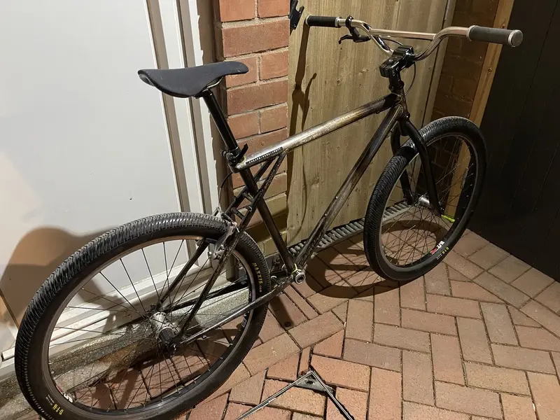

The results far exceeded how I thought it would turn out. The pictures really don’t do it justice:
It’s almost a marble effect in some places, with mixtures of light and dark grey, black, blue and golden brown. The clear coat left it with a nice shine, which I enhanced with some light polish.

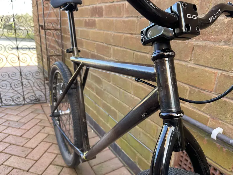

Next up was deciding on components, I managed to bag a couple of local bikes for free being given away on Facebook market place. A giant that has had the worst diy paint job I’ve ever seen, and a kids GT bmx (which I think I’ll do up and give away when I have a bit more time).

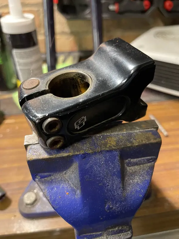

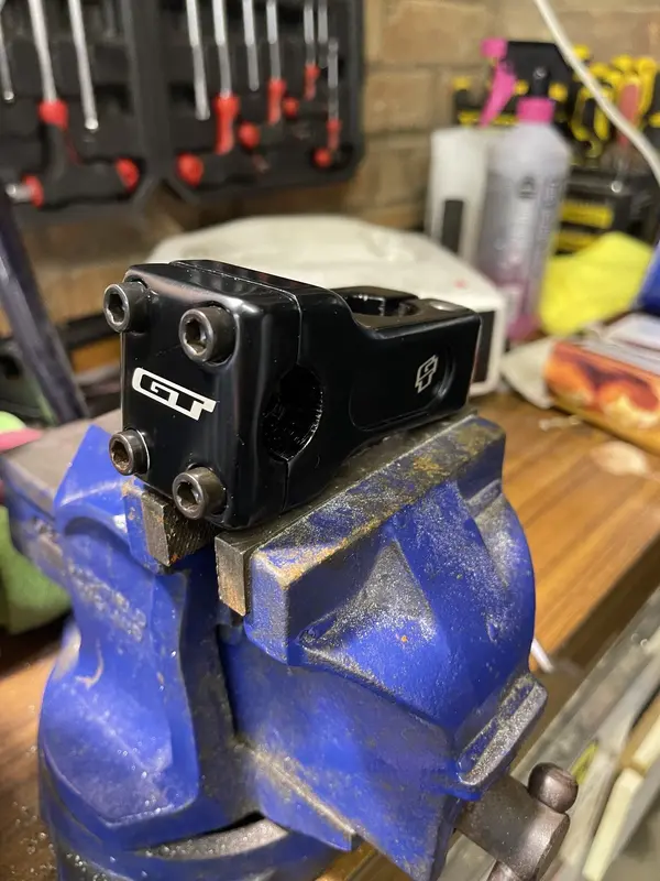

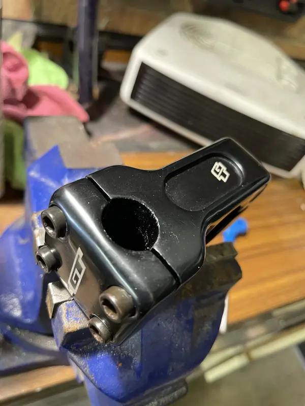

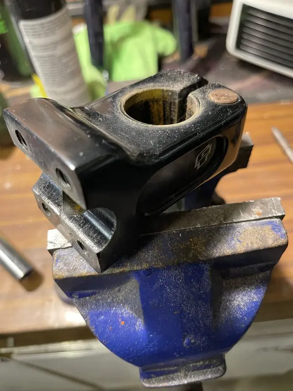

The stem on the GT looked ideal for what I was aiming for, a kind of streety BMX inspired build. And it cleaned up nicely:

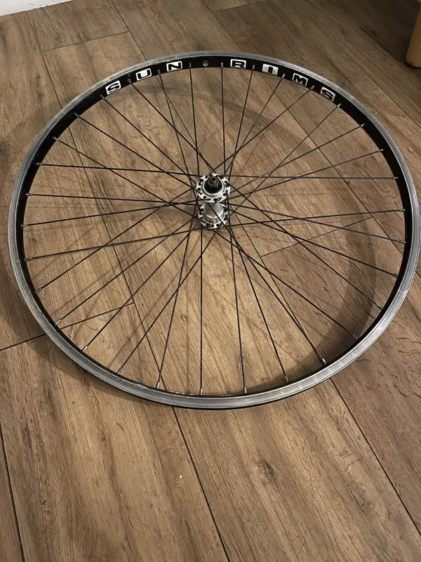

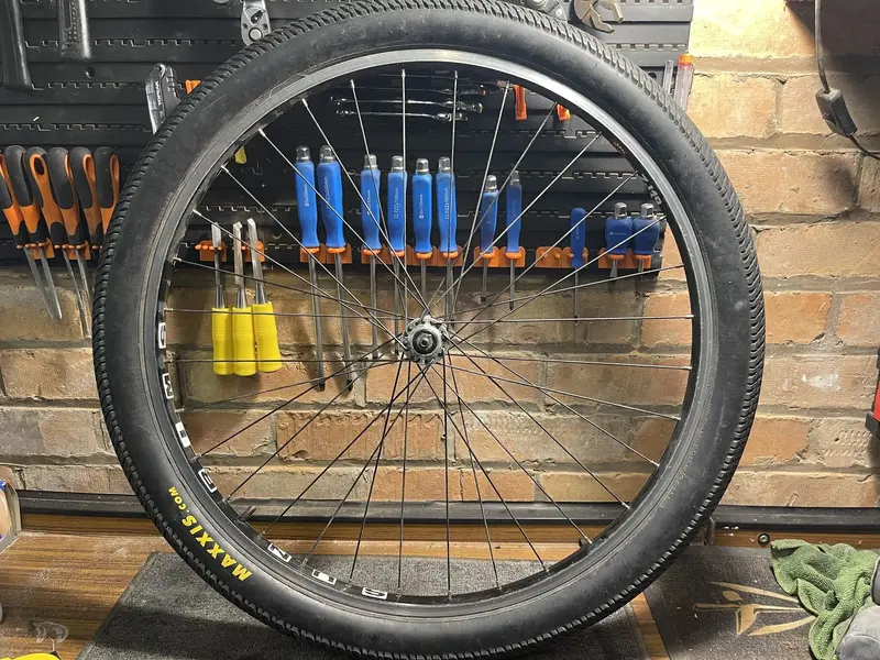

I decided that the wheels that were on the giant would make for a better looking build, and they have the added benefit of a HG hub configuration as well as being so much lighter. Love the old sun rims logo:

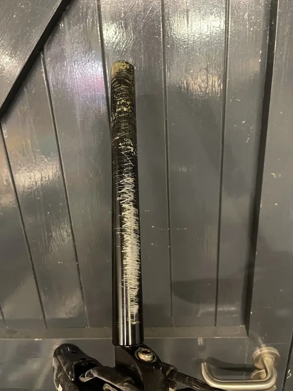

I also have fitted the seat that came with the STP, but that had more awful graphics on it. I decided to try paint stripper on the fabric material and sure enough the graphics have pretty much come off.
Whilst I had the spray can out I also treated the original seat post to some black gloss.

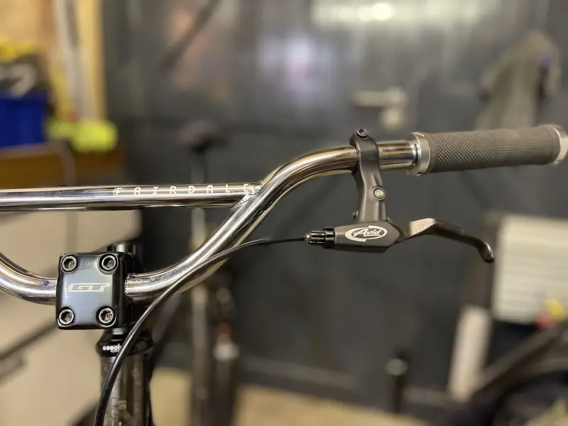

I polished up the original rear pro max v brake, reused the cable and pads and paired it with a basic but trusty avid lever that I won on eBay for £2.

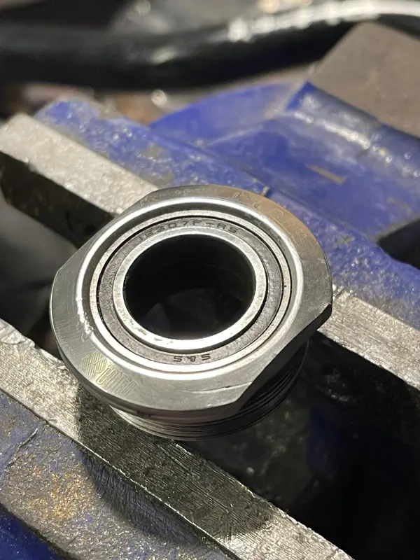

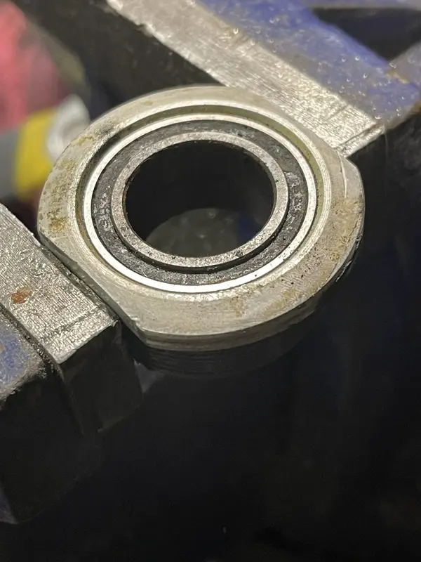

And tonight I’ve given the BB a bit of a freshen up with yet more polishing. Hoping to fit the cranks and remaining drivetrain components tomorrow
