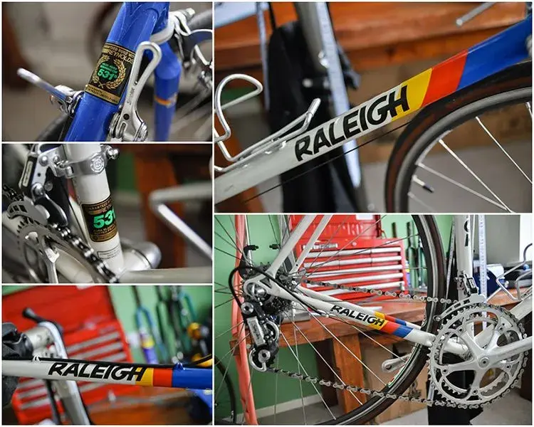

I've just acquired this Raleigh.
It is in very good, original looking condition but just needs some TLC
My knowledge on Raleigh mostly just extends to the SBDU so I don't know so much about the other light weights from Worksop/Nottingham. This is a 531 from 1985, frame number WI5000003, so that will be Nottingham.
I know that after the 1983 season, the pro TI Raleigh disbanded and Raleigh Panasonic (Dutch) & Raleigh Weinmann (British) were started - please correct me if I'm wrong on that. So, do the Panasonic and Weinmann frames share the same paint scheme? I think that Raleigh Panasonic kept with Campagnolo while the Weinmann team went with Weinmann and Simplex.

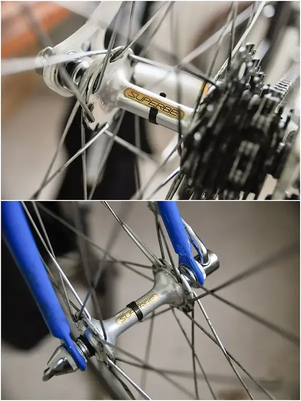

Hubs: Suntour Superbe 28H (2x front 3x rear - flat SS Spokes)

Gosh that's a peach! Some of the best kit out there from bitd.
The Weinmann team frames were 753 and the spec not far off what you have. It's just the Suntour hubs I think that would possibly have been Maillard

Thank you. I've seen a few of these but not with this kit, most have been Shimano 600. It is the kit that made me go for it. I'm guessing the wheels were specifically built with those hubs as you said, the Weinmann team I believe, used Maillard Helicomatic. I've never been a fan of helicomatic, just never seemed to be as popular.

That is lovely,I think it's an 85 as the cable runs along the top of the top tube and the 83/84 ran to the side on the frames with shot in stays. Team replicas came in Weinman/Panasonic colours also used on team Raleigh burners so I think the cour schemes where the same across all the replicas. Those Suntour hubs may not be standard but they are fantastic. All in all an excellent addition to your superb stable.
