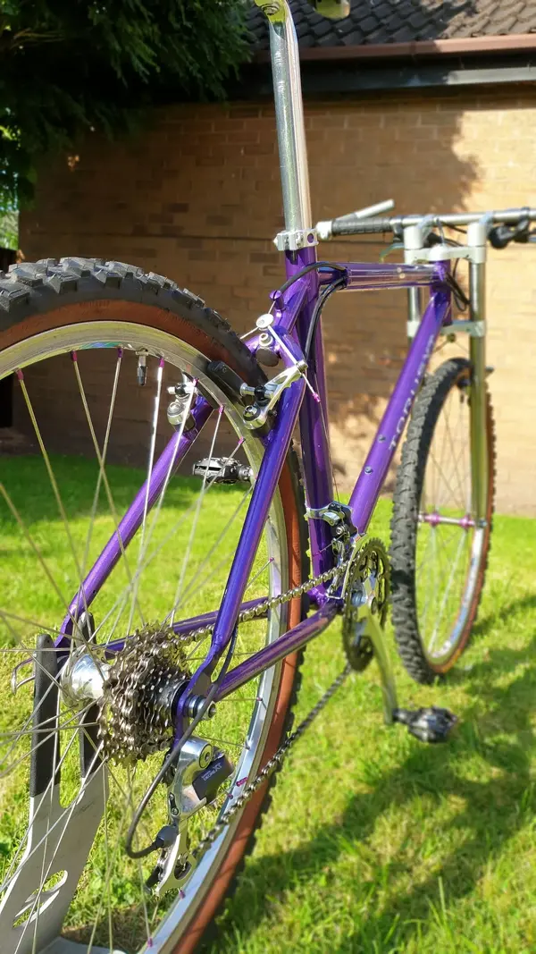

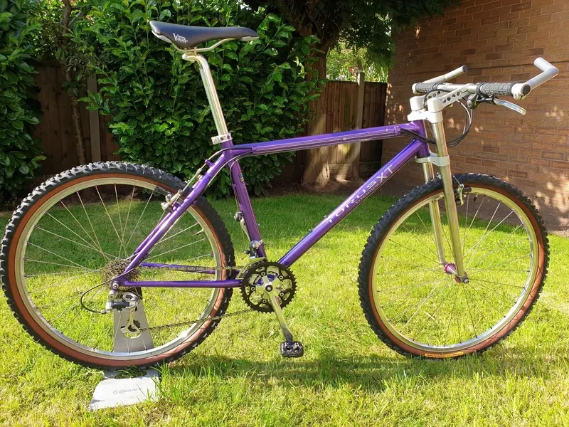

My Torus has a very thin internal shim and factory fitted post marked at 30.0, fits perfectly and I would bet all the tea in china this is the correct size for the frame. Mine is a D-Reg :)
Also supplied a friend of mine with another 30.0 post for his Torus, which also fit perfectly.
That is lovely. What a nice colour.
