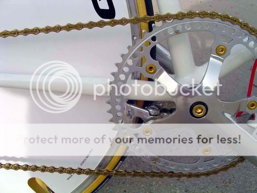

The chain Rings are decidedly Sugino SR if I'm not mistaken ?
Re: Raleigh Team Pro - SB1988
Correct, do you like them? I like the drillium effect but only if done well and I'm thinking of using them as a drilling guide for some Campag rings. The theme of holes for lightness is picked up in the brake levers and the four hole front mech.
Thanks, Mapturner. Are there many SB Raleighs in NZ?
Sugino chainrings had equal sized holes all over the chainring IIRC
Sakae Ringyo chainrings for the Royal had alternate big / small holes plus a cutout at the area above the chainring bolt ......Sakae Ringyo chainrings for the Apex had alternate big /small hole but no cutout above the chainring bolt.
There again I was much younger :D
Shaun

glpinxit":23e37uo3 said:
My MP project bike had a 54 ring Similar pattern but I drilled them all out bigger & liked the end result when they are the same diameter as below

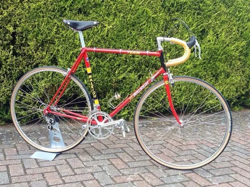

Well, finally I've finished building the bike. It has taken a while but now I have finished the build I'm a very happy bunny indeed! The bike rides beautifully and looks fantastic and everything works as it should. What could be better just in time for summer?
Looking back I find it hard to believe that it has been nearly six months. Or that my original plan changed so much. The two are related though. Originally I wanted to build a top drawer classic racing bike that I could still ride regularly and enjoy without worrying that I would spoil it or wear it out. This meant not too perfect. But as the build progressed things started to come together differently. First off the frame turned out to be in near perfect condition with no rust or damage -just the wrong paint. Then the eBay lottery started to serve up the right bits at sensible prices in near new condition. (So they are out there if you are patient.) So I gradually decided to use the right Campagnolo parts, which meant mostly Super Record and it has taken a little longer to find the last elusive bits to finish.

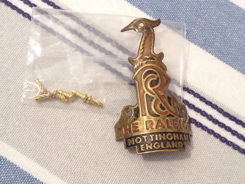

The last job was to put the head badge on. I lightly buffed it to give it a lift without turning it gold.The rivets needed to be a little shorter but all is now sorted.

Specification as follows...
Frame: Raleigh SBDU Reynolds 753 frame no SB1988 in Team Pro colours (1977)
Fork: Raleigh - built at SBDU by Sam Hudson
Headset: Campagnolo Nuovo Record -steel
Stem: Cinelli 1A -110 mm
Handlebar: Cinelli 65 Criterium - 40cm
Brake Levers: Campagnolo Super Record
Brake Calipers: Campagnolo Super Record
Brake Pads: Campagnolo
Brake Cables: Campagnolo
Brake cable clips: Campagnolo
Shifters: Campagnolo Super Record (band on)
Front Derailleur: Campagnolo Super Record -4 hole
Rear Derailleur: Campagnolo Super Record Mk2
Derailleur Cables: Campagnolo
Cassette: Regina Extra
Chain: KMC 12 - 24
Cranks: Campagnolo Super Record
Chainrings: Campagnolo Super Record - 42/52
Bottom Bracket: Campagnolo Nuovo Record
Pedals: Campagnolo Gran Sport
Rims: Mavic Module 2
Hubs: Campagnolo Nuovo Tipo
Hub Skewers: Campagnolo
Tyres: Michelin
Saddle: Brooks Professional
Seatpost: Campagnolo Centaur (for its length)
Bottle Cage: Elite
Extras: Christophe toeclips and straps
Weight: 22lb (10 kg)
