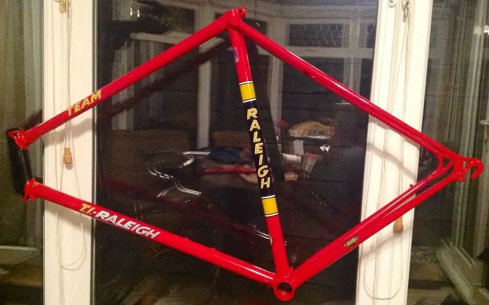

Not much progress - now clear coat lacquer is on this frame and while it hardens I've been building up another with the Shimano groupset that came on this. (And Nob has made me feel a tiny bit guilty so I've also been looking, half heartedly, for some Campagnolo cranks.)
Difficult to see in this pic how shiny it is so you'll have to believe me that it is very shiny indeed - much more than it was meant to be!

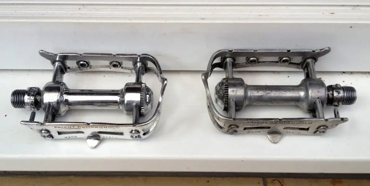

At last, a nice day and the first Sunday ride of the year with with no puncture! Perfect to show off progress with the bike. Paris-Nice on Euro Sport 2 precludes the first mow of the year though I might fit that in later.
I bought the wheels for a song last November. They turned up wonky and absolutely filthy and each sporting a random assortment of plain gauge and butted, silver and black spokes on Campagnolo Nouvo Tipo hubs with Mavic Module2 rims. Not at all promising but the rims had almost no brake wear so after the regulation month in the shed I replaced about half of the spokes. The bearings felt smooth when I trued the wheels. Yesterday was the day to service the bearings and I wasn't very hopeful. So you can imagine my surprise to find absolutely no wear on the bearings whatsoever! The races are still matt with no shiny track, even so a good clean and re-pack with grease. All very odd.

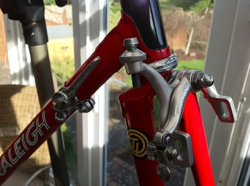

Update time and a tale of little jobs and minor setbacks.
Brake blocks arrived and are now installed. This build is turning me a little bit obsessional and "Campagnolo" moulded into them it made me happy (though at £4.50 each the four cost half what the brakes cost so happiness should come as standard).
But I need a different bottom bracket. The small chain wheel fouls the stay on the cranks that match the installed BB. With the Campag cranks it is fine but they are the wrong taper. Annoying but the delay is the main annoyance.
Front mech is on and I've chosen the four hole Super Record over the three hole alternative. This choice is because I should have painted the bands a little further up the seat tube. Not the end of the world but still a bit of a shame. The 4 hole SR is on a plain parallel sided band which helps.
Pedals are on, now with Christophe clips and straps.
Cables are also now on brakes and gears. The latter still need trimming.
The very last job will be mounting the headstock badge. The frame came drilled for it and the rivets are from eBay (advertised for a chopper). I'm inclined to not polish the badge, what do you think?
