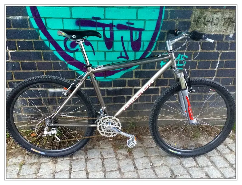

It isn't - the seat height hasn't been set . It's 16" and I'm not a midget
Finished now - changed the cables for Jagwire Ti Kevlar and shortened to how I like it.

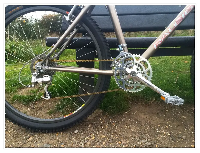

The Red flash on the fork looks out of place, Can't seem to match the fork's Red with anything (ie. Seat, Red Seat Clamp etc - as the red is an orangey red and hard to match) so will just leave it.
Since taking the brighter picture no. 2 I've Autosol'd the bars, the cranks/rings and seat post plus other metal bits to get rid of marks and scratches and it's gleaming like the door of a whorehouse and looks superb! Will take some pics and upload .
So there we are. Now for the next project.

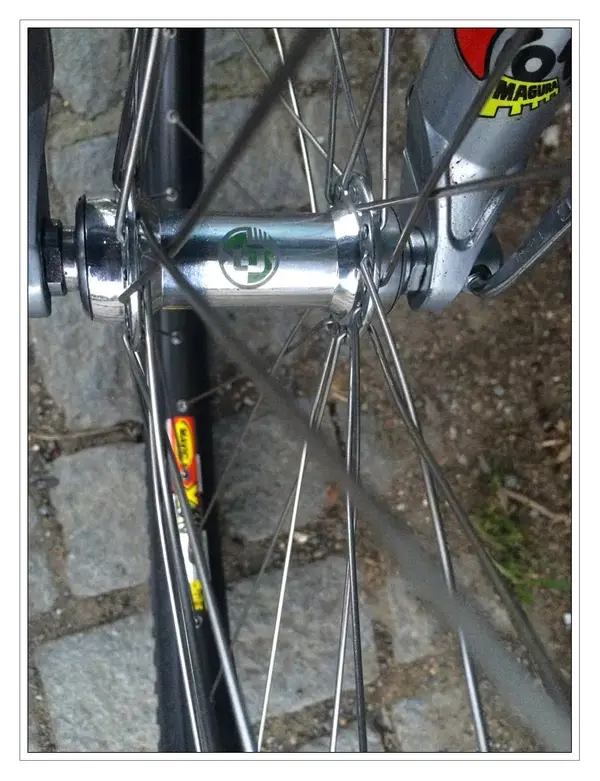

97 Sachs Quarz Hubs - NOS.

Gave the frame a slight Autosol treatment and wax.

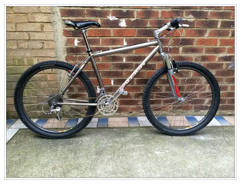

And she looks lovely, the smaller profile Ringle stem meant a spacer on the steerer - looks jacked up a bit but boy is it comfortable to ride!
Used my existing WTB grips with the shifters.
She rides beautifully, much better than before, the shifting is effortless too.
What do you think?
Shortened steerer and removed the large spacer - Ringle stem looks much better now!

Hubs - Sachs Quarz
Rims - Mavix X618 Ceramic

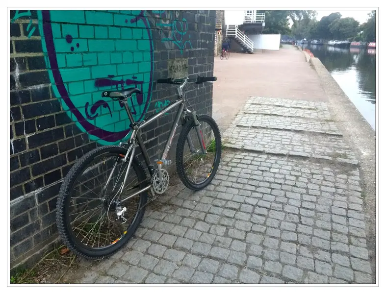

Apologies for the Ressurected thread (again) The image hosting sites seem to have deleted all of my pictures of all of my (and former) bikes which was upsetting - so thought I'd add a few for the sake of the build threads
Sachs Quarz/Plasma Syncros/Ringle/M900/Pauls Motolite Raleigh RSP Ti
