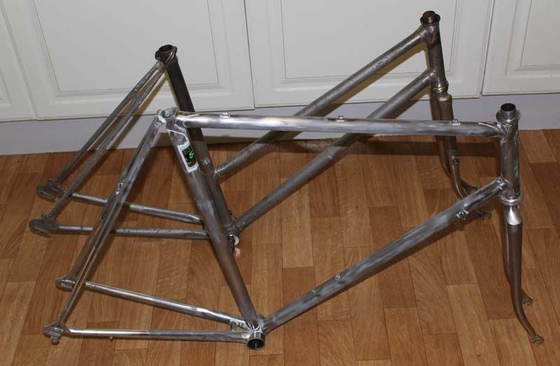

I'm not sure if anyone's interested, but I've finished stripping the frame back to bare metal. Actually I got a little carried away and also stripped a Falcon lady's bike at the same time.
There wasn't much rust on the Road Ace, what little there was I've ground away using a wire brush disc on my electric drill. All that's left to do now is wipe it down with some alcohol, mask the Reynolds sticker off and get a few coats of primer on it.

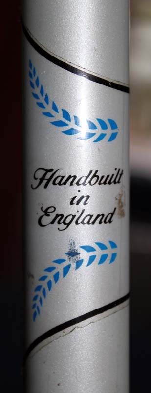

While I've been doing that, I've also been making a start with the decals - I managed to remove the seat tube one relatively intact so I scanned it and a friend has re-drawn it on Illustrator for me. I've also downloaded the correct font for the Raleigh text so I can now get a vinyl cutter to produce some pretty original-looking decals for me.

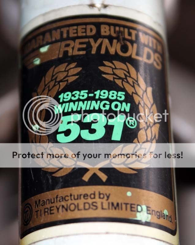

One thing didn't go as I planned though - I was trying to save the Reynolds sticker on the down tube but unfortunately the masking tape that I put over it to protect it while I was stripping the frame took the top part of the sticker off when I removed it.
I wonder where I can find another?

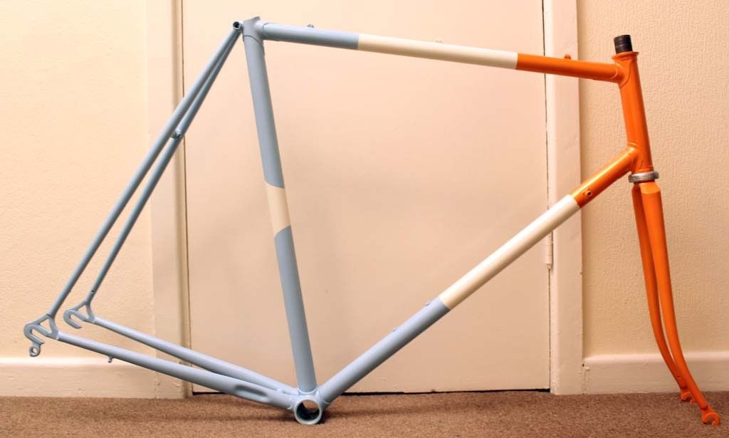

Just a quick little update.
The frame is painted and ready for the decals.

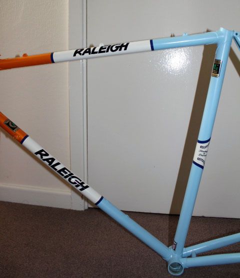

I've got the Reynolds stickers for the 531c tubes and forks and also the one that I was trying to track down above. Turns out the H Lloyd came up trumps for me!
The other Raleigh decals I'm getting made up and cut in vinyl.
They should be ready soon.

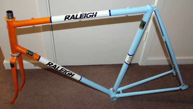

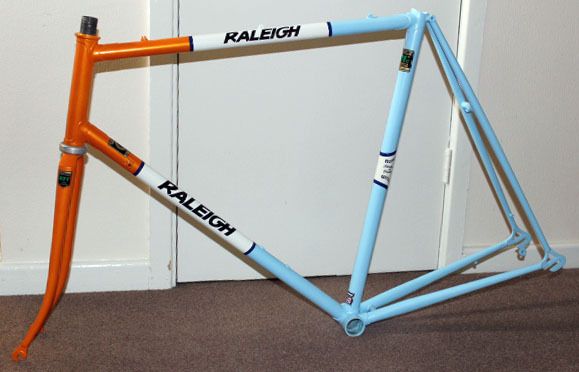

I picked up the decals today and applied them to the frame. It's now ready for lacquering.
I'm pretty pleased with how it's worked out!

By any chance would you still have that scan of the seat tube decal.
The Road ace I picked up is missing this decal and I can't find a suitable replacement anywhere.

You're in luck - I had the decal re-drawn in Illustrator! it was then printed on adhesive clear vinyl, which is pretty close to the original finish.

stevevw":ax09zqv3 said:
Nice job. I was expecting to see the chromed ends though, change your mind?
Hey there,
Yeah - when I stripped one of the seat-stays, the chrome on the inside appeared to be slightly damaged so rather than risking it going rusty I thought I'd paint the whole lot.
In some ways it's a shame, but I actually quite like the simplicity.
