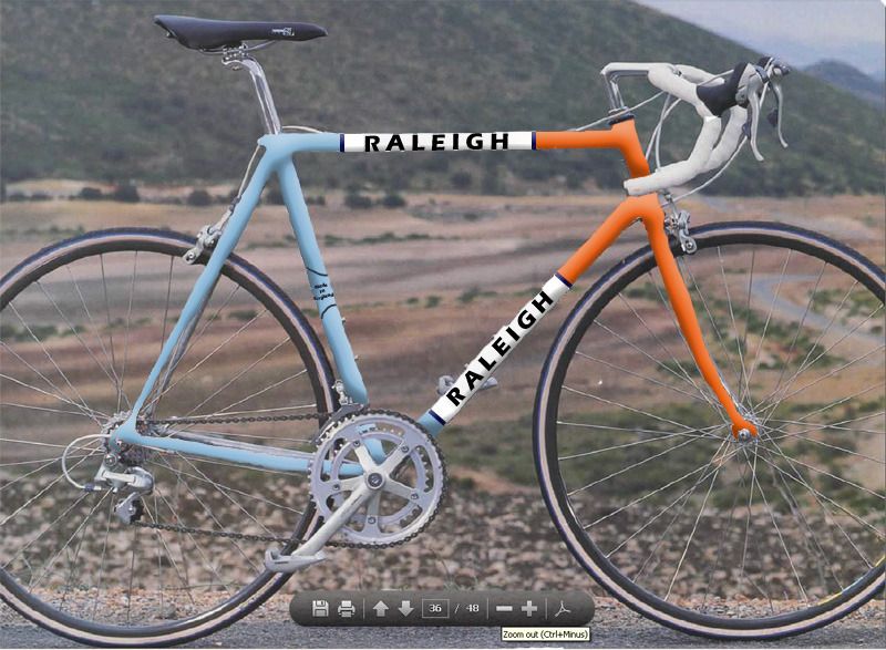

Raleigh Road Ace to Fixie Project - colour options...
Also just looking at the pics again, the transfer on the downtube, would look better being further up towards the front.
I would go for the traditional carlton team blue and perhaps orange however pink would go very well if you got some pink tyres I'm doing a similiar project which may end up with canti bosses and more of a cyclocross look

frinkmakesyouthink":y3s7msdi said:
Yep this is definitely the best. It'll look great!
This is the best option in my view.
Working as a graphic designer I see this a clean , uncluttered and the Raleigh name stands out well. The other look too fussy and gimmicky.
