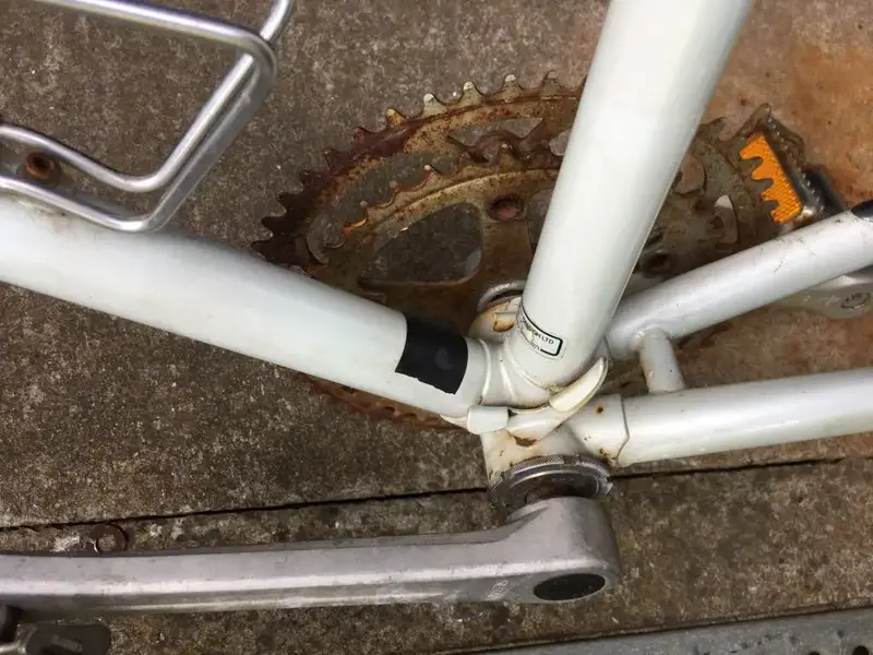

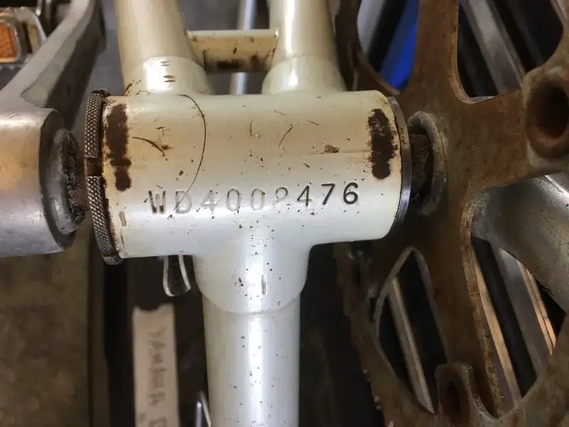

Interesting frame. 1984 model, so serial should be late '83 or early to mid-'84. Dropouts were Gipiemme. Built to be equipped with Shimano AX, hence the over-the-BB cable routing.

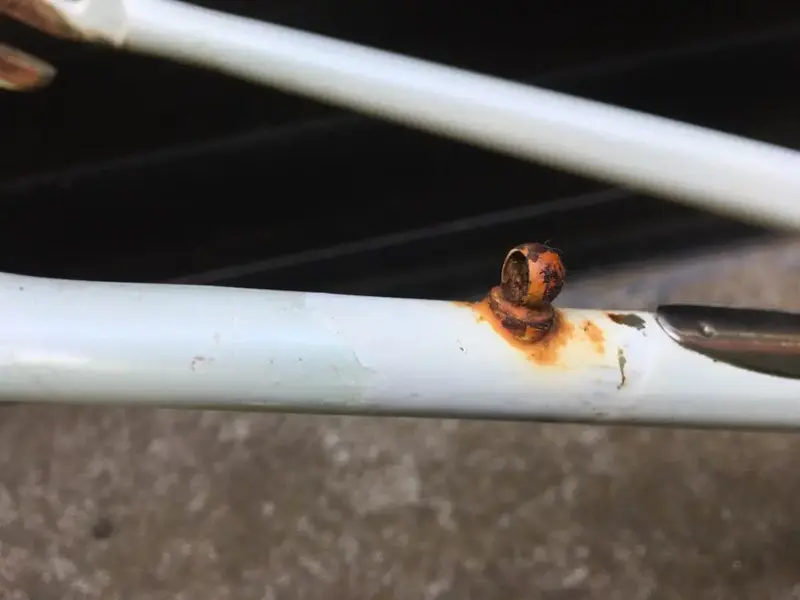

non-fixie, any idea why there is a cable guide at the rear?

That cable guide on top of the chainstay is correct for an ax rear mech and the frame looks exactly like my 84 600ax model

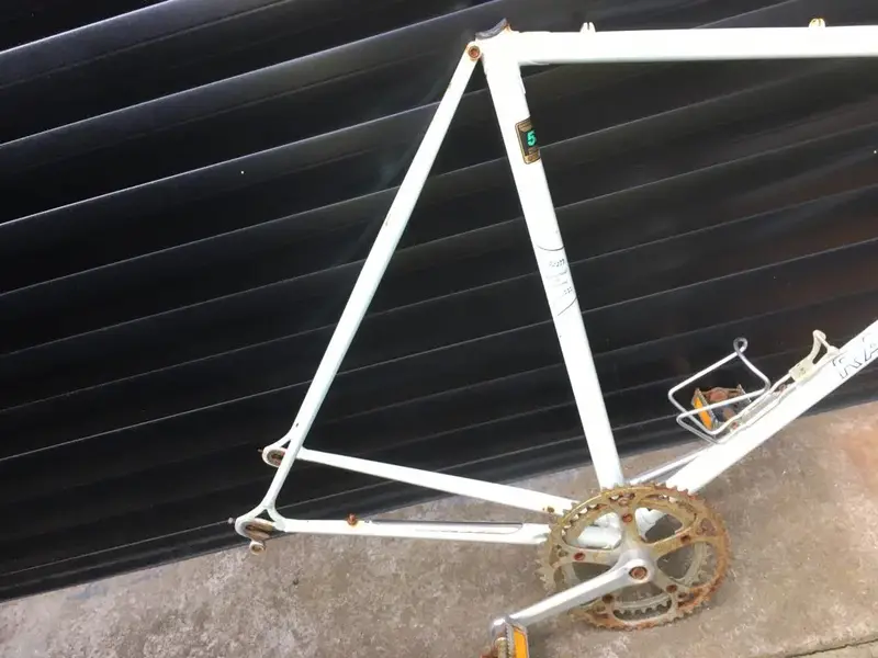

Hi All, I have picked the frame up, its better than expected to be honest.
Obviously the incorrect chain set.

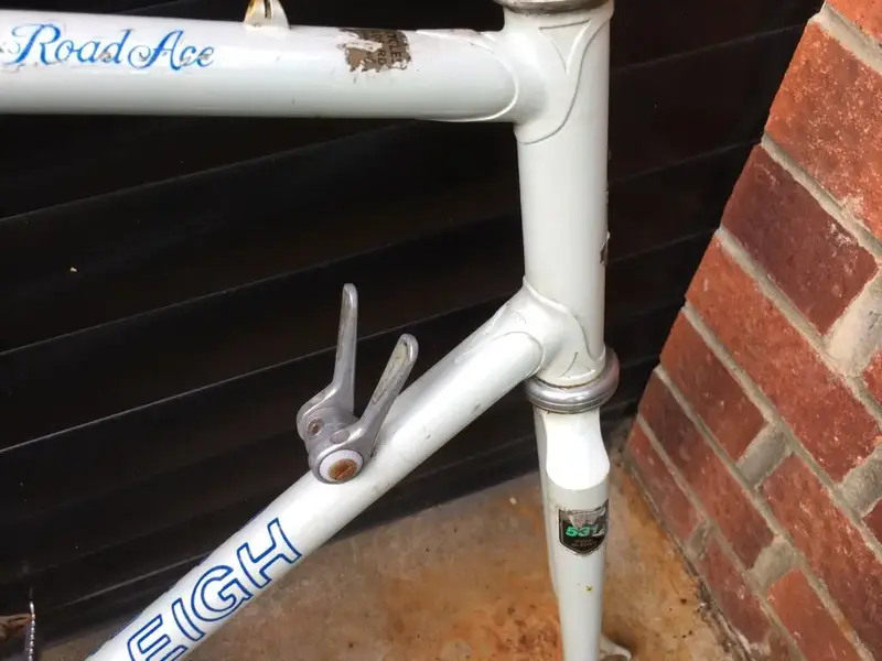

Correct headrace steering
Frame number - is it a 1984?

Sjl, thank you for that, my research found some or most of the rear frames had no cable guide for the rear mech

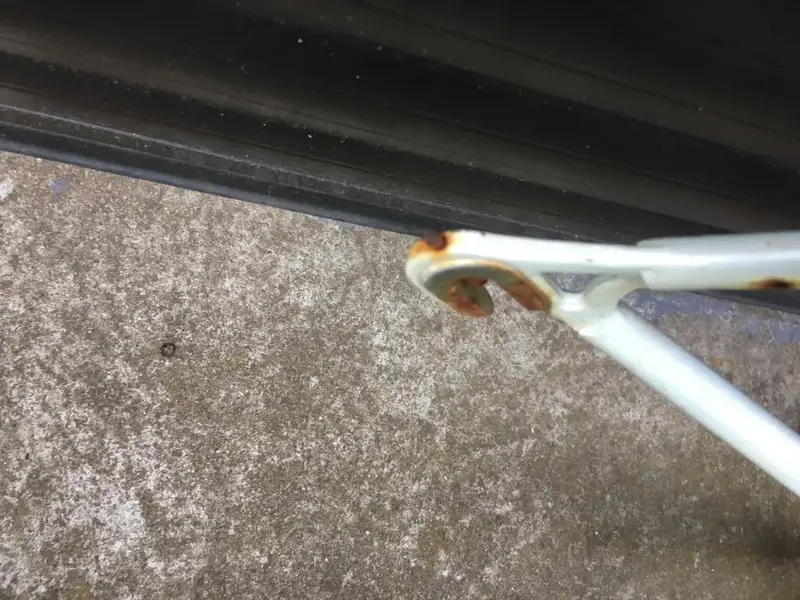

More pics, a bit more details of the rust stains etc

SR Cranks, they have made in France stamped on them

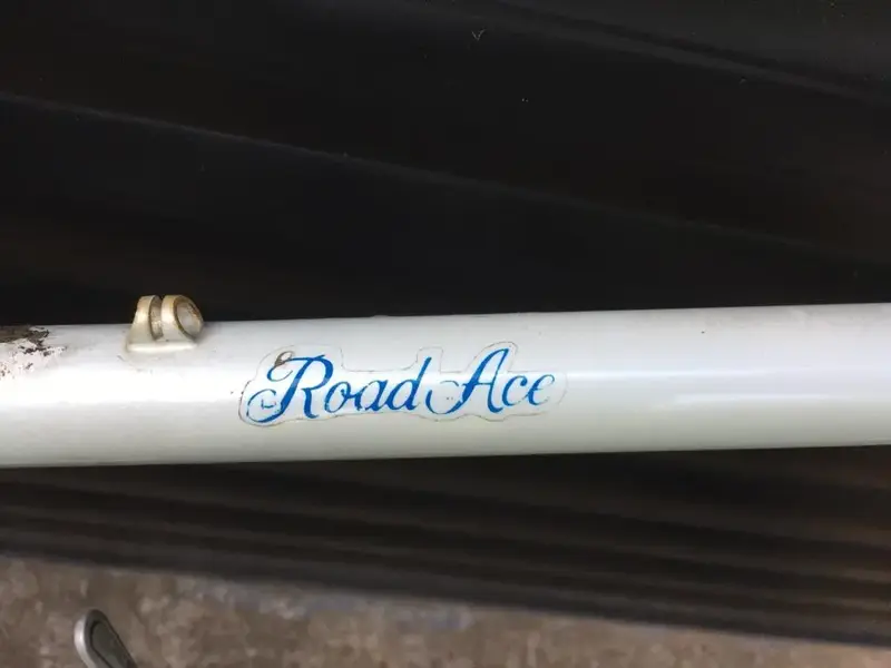

The pearl Lacquer has come off where the cable guide has been attached

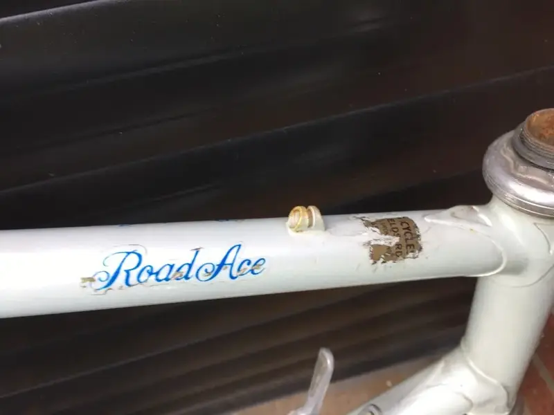

Headset looks original, still moving with a little play
Is it correct these cable guide were on the high SBDU team bikes and replicas?

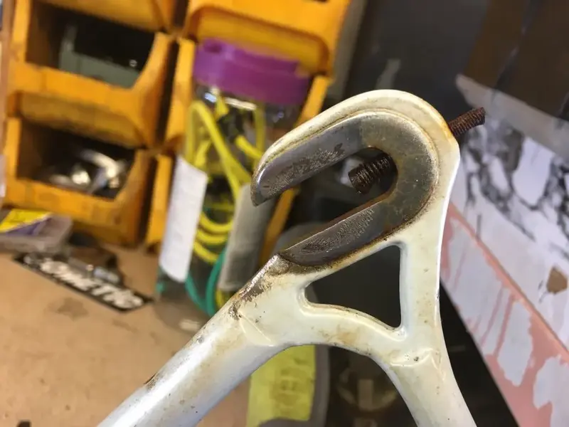

Small brass wire wheel has improved the rear drop outs.
Thread for the rear mech is sound.
Wheel stop screw freed off, I need another for the other side, a bit of Croil for half hour sorted the snapped screw.

TI Raleigh sticker and cable guide detail

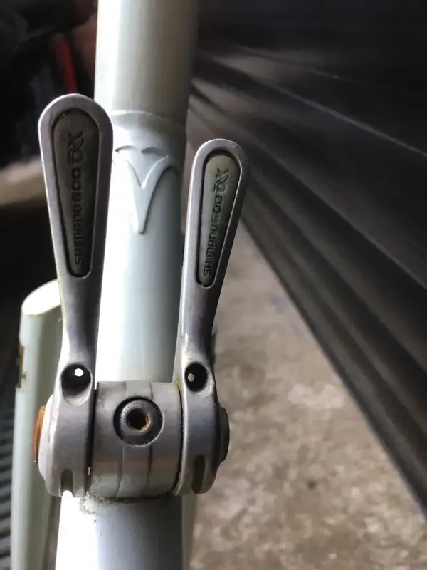

Original gear changers and I think they are AX
Was this the only model with this brazed on mounting?

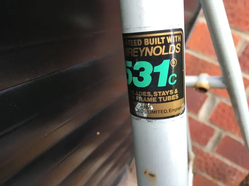

So happy this is 531c
