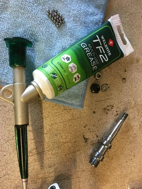

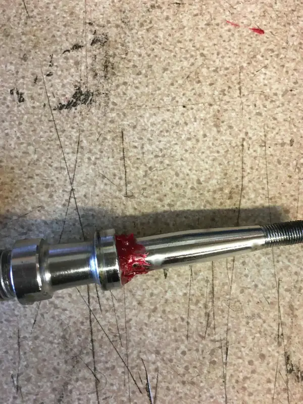

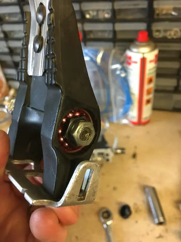

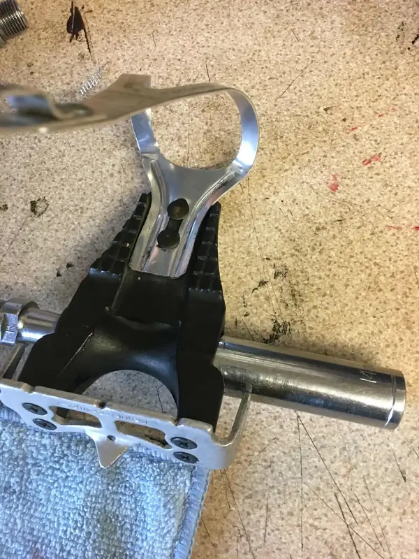

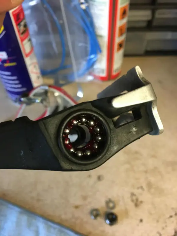

Ofmega Sintesi Pedals refurb pics

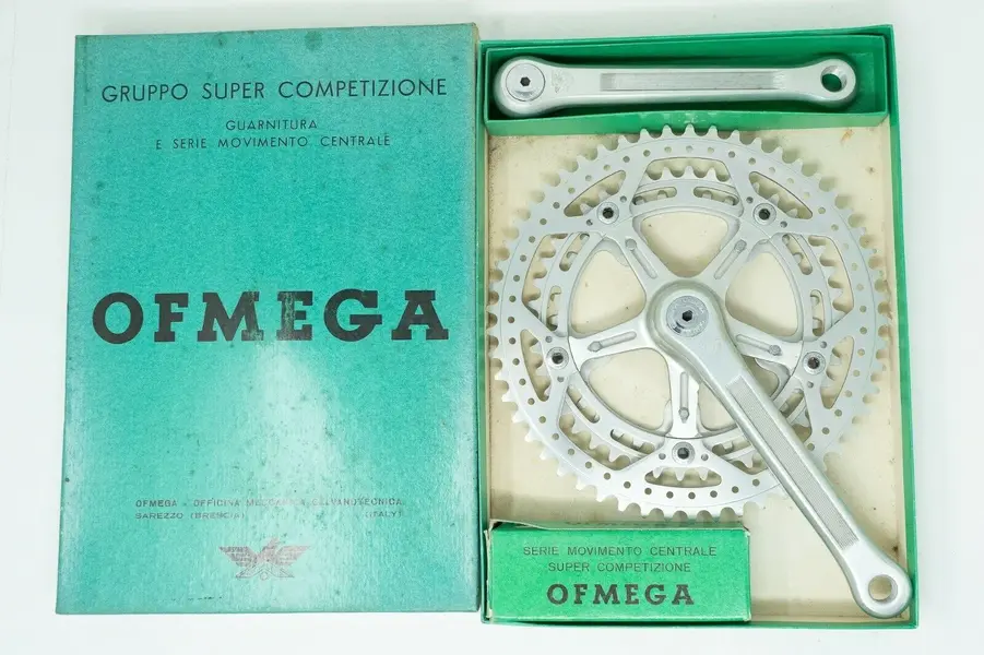

here is the manufacturer's top of the line chainset of the 1960's to early 1970's era in its presentation package -
OFMEGA Super Competizione triple chainset, boxed .webp OFMEGA Super Competizione triple chainset, boxed .webp
t'is difficult to see in this image but the floor of the recess in the outer face of the arms is marked with a pattern of very fine ridges, almost as if a dinner fork were run over a flat surface of raw clay...

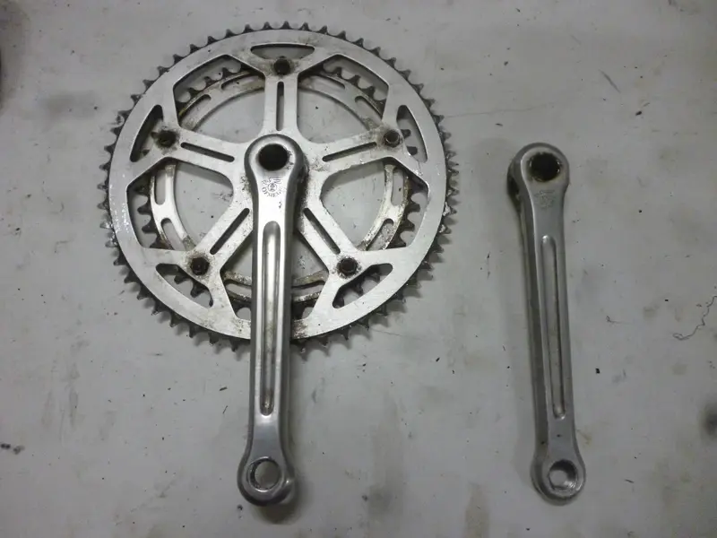

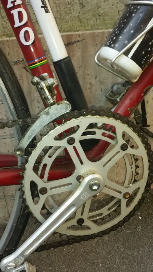

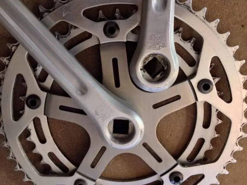

one interesting midliner alloy chainset was the Forgiato which was offered in several iterations through the years, including both cotterless and cottered. it was sometimes marked with the name of the bicycle.
OFMEGA Forgiato cottered alloy chainset .webp OFMEGA Forgiato cottered chainset .webp

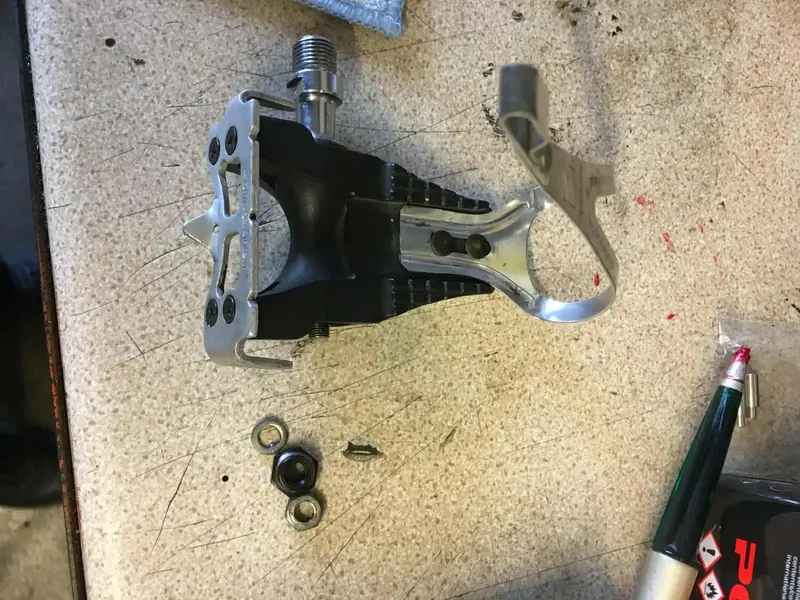

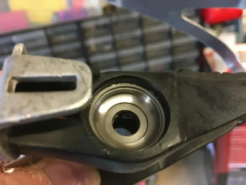

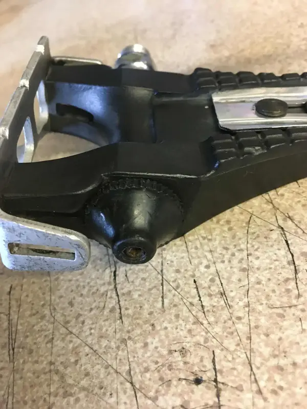

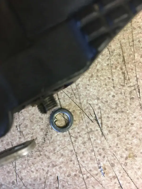

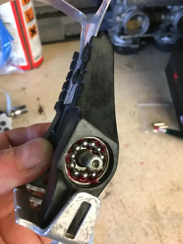

I had some sintesi pedals. They cracked with limited use. I think oil/grease causes breakdown of the plastic. Possibly using synthetic lube will avoid that or at least prolong use. I recommemd cleaning as much excess lube as possible anywhere it contacts the plastic. I wouldn't be surprised if the same thing occurred on the mechs as well. Possibly why you don't see many about.
I have Campagnolo Xenon pedals that are very similar, not using them for same reason thinking they might crack also.
Thanks for the advice and I will keep an eye out for cracks.
