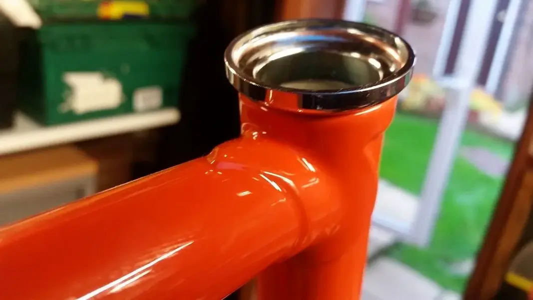

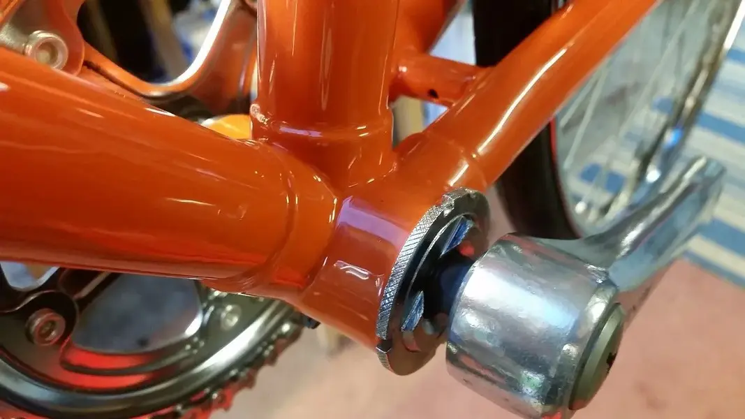

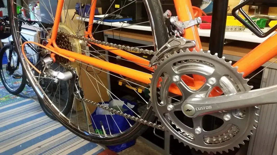

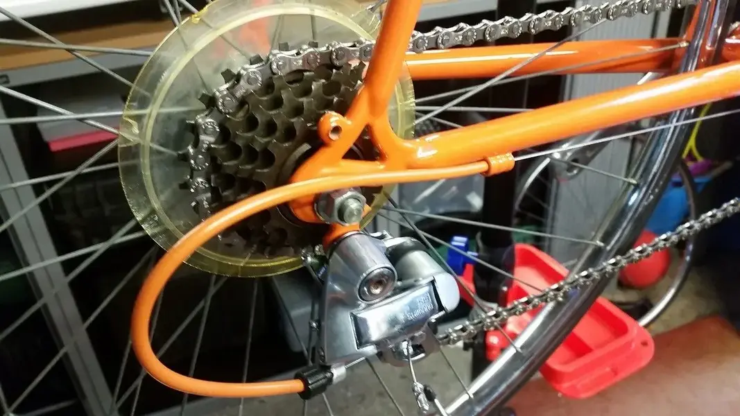

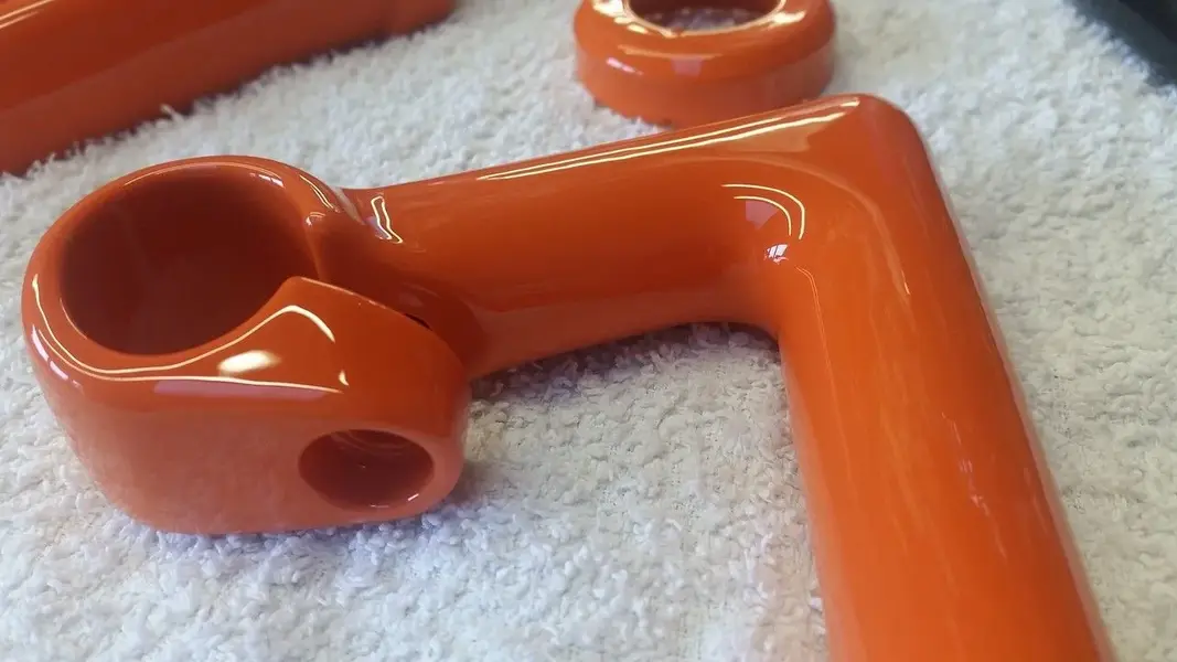

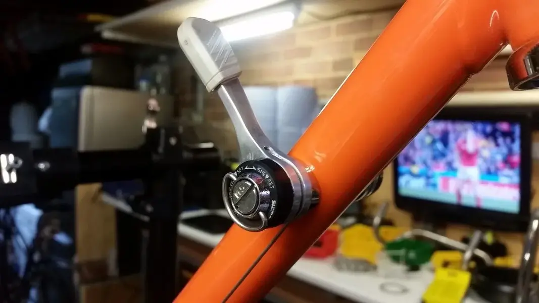

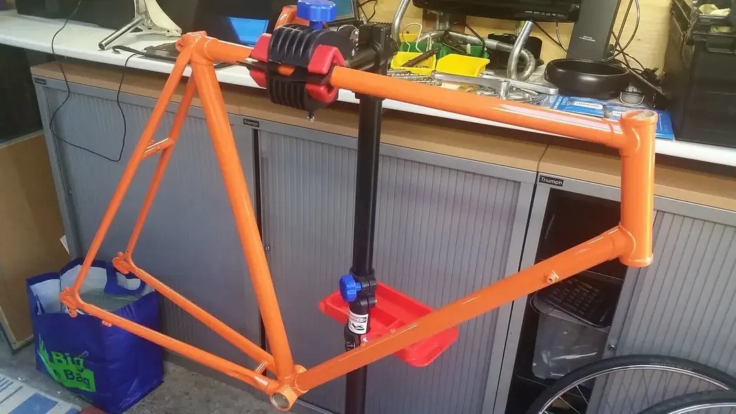

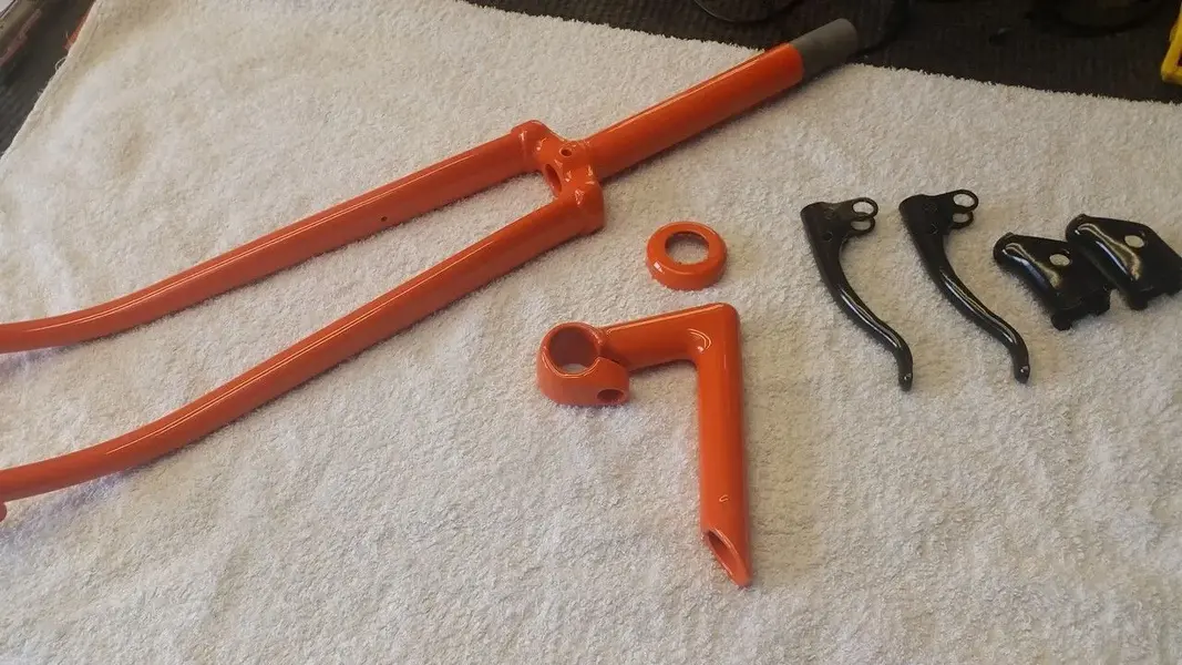

I collected the frame today. It looks superb, well finished and very shiny.
The powder coaters sprayed a clear coat over the top as well, making the finish more durable.
The main concern I had was that they didn't mask the threads and holes properly, and it took ages to clean out. Every hole had to be re-drilled to get bolts through. I am happy with the overall look. They also painted the spindle on the front forks, meaning that it doesn't fit into the tube! I will have to get them to strip it back and re-do it.

That looks gorgeous mate and i picked a similar colour many many moons ago when i had my old Dawes scorpio frame repainted in white with like patches of like a burnt orange colour which i really love at 1st then realised yellow would of been better in place of the white but yours looks nice fresh and modern ;) ..
I've noticed, the lacquered finish by Powder Coating really makes the bike look modern.
Whole different thing to spraying in terms of look and feel.
The finish looks like sweets, feel like eating your frame!!!
