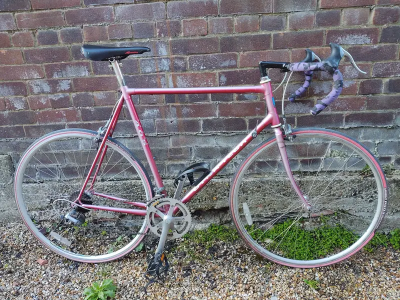

Ok, this evening I have trial fitted the donor 7-speed wheelset and I think it looks better than it did with the wheelset it came with (no doubt helped by the less agricultural rubber!). Does the retro community agree?
It has also shaved 700g off the overall weight (no doubt helped by the less agricultural rubber!)
I thought I would need a longer chain as the seven speed has a bigger biggest cog than the 9 speed it cane with, but it works. Hurrah.
