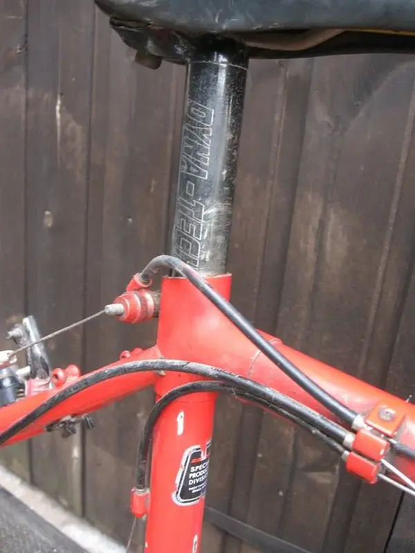

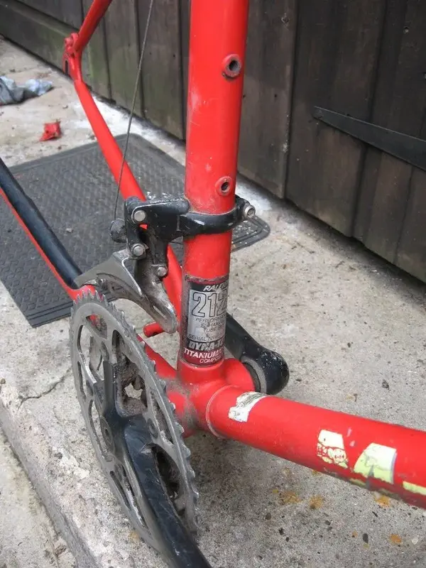

This is the bike I picked up from the tip earlier in the year, an M-Trax Ti 700, which I believe has titanium top and down tubes.
It's in a pretty rough state at the moment, but the aim is to re-build it next year for the summer.

Hi,
I don't want to hijack the thread so perhaps we should take this to PM or a new thread but I'm very interested in the what appears to be double chainring setup on that Dyna-Tech you purchased...
If it is indeed a double, is there some more detail on it? Friction shifter for the front mech using a standard XT front mech?
Cheers,
Steve
