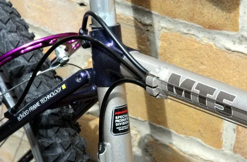

brocklanders023,
Looking at your frame photos and comparing it with my MT5 I notice a few differences. The cable-stops on the MT5 are on the top-tube for all the cables and the front-changer, therefore, is a top-pull type. On yours it looks like there is a cable-stop on the down-tube, possibly making it an MT4?
Also on my MT5 the rear cable-stop is brazed (bonded?) onto the side of the seat-tube lug. See images, below.
Don't know if this helps or not.
