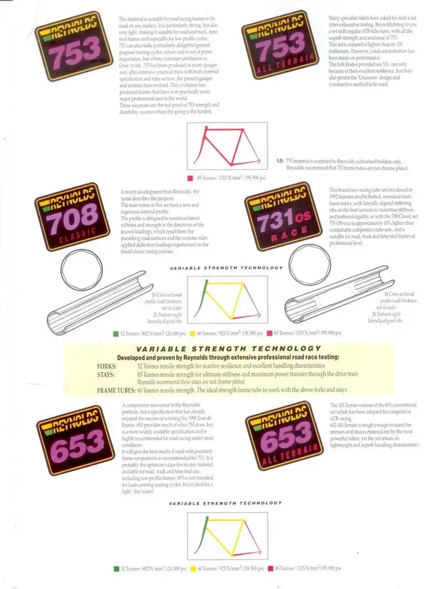

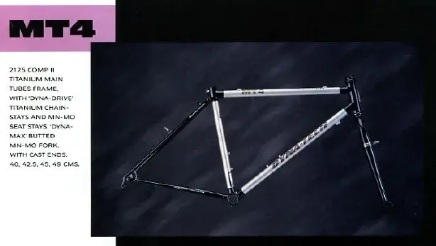

I'm starting to plan the build of my new, pristine Dynatech MT4 (the frame used for the 92 Ogre and Orge XT), and I've been trying to find out which steels were used for the seat stays and fork. The catalogue (see attachment) says they were Mang-Moly, and although Raleigh almost never revealed which grades of steel they used, it's widely known they favoured Reynolds, using 501 / K2 / Optima for their chromoly frames (including the M Trax Duo Tech series and the Diablo series).
But for their Mang-Moly models, like the Ogre or MT4, it's harder to guess because Reynolds had several Mang-Moly MTB tubesets available at the time: 531, 653, and 753. Do any Raleigh experts have a clue about which Mang-Moly was used on the MT4 / Ogre?
Edit: after asking Terry Bill (who worked at Reynolds during the Dynatech era) and looking at a Reynolds Mang-Moly brochure scan (see attachment), I think it's safe to say that the fork and seat stays of the MT4 / Ogre are almost certainly Reynolds 531.
In the case of the fork, the 753 MTB and 653 MTB tubesets both used 531 blades, so 531 is the only possibility there. For the seat stays, 753 was expensive and difficult to join, requiring brazing with silver solder (and a special license from Reynolds to be able to buy!), as overheating the 753 would cause it to revert to its pre-heat-treated 531 strength, and thus is unlikely to have been used here. Reynolds 653, a mixed tubset between 753 and 531 in terms of price and tensile strength, also (I believe) used 753 seat and chain stays, so '653' seems unlikely here too.
