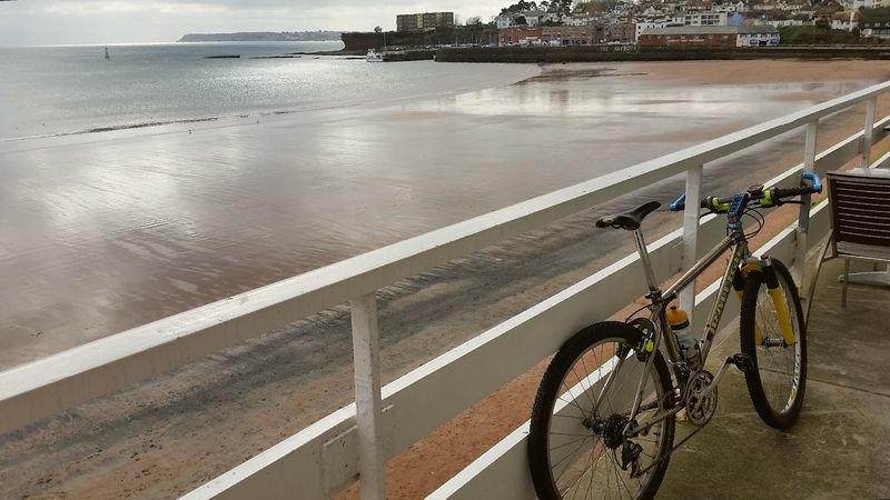

I've posted pics of my M-Trax in this thread before, but I like this pic from my coffee stop on Thursday:

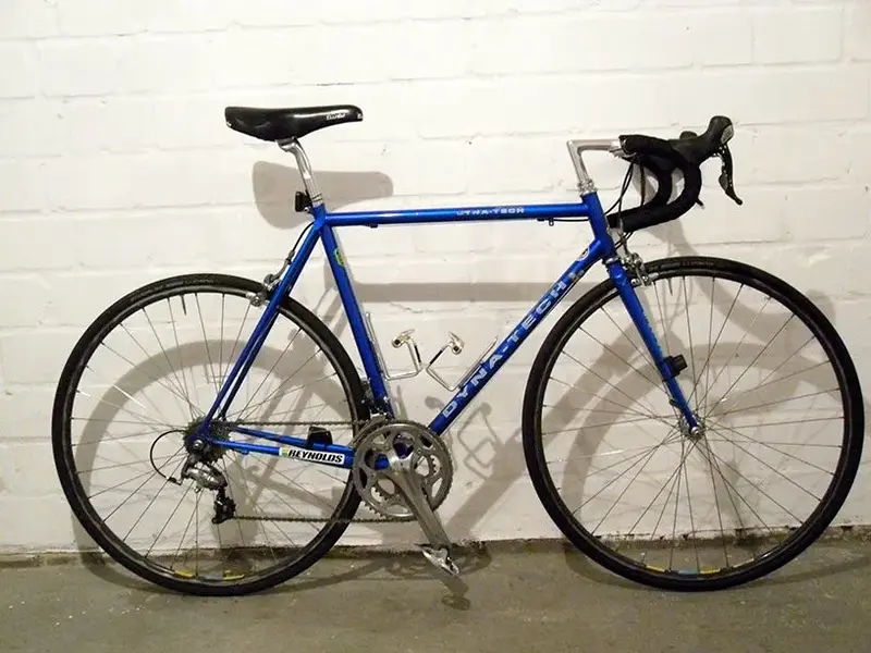

Re: Dyna-Tech Road 853
My 853 Road going strong, ready for the Alps this summer.
