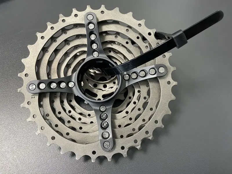

However, I have only been running it as a 7 speed rear cassette as the wheels I got had a 7 speed hub. So it’s time to upgrade and make use of all 8 clicks on the lever. I’ve got a spare 8 speed 600 hub to swap the free hub over from, I was thinking g about building a new set of wheels with Open Pro CD rims and Cx ray spokes, and I may still do that, but for now I’ll swap the free hub and re-dish the rear wheel for the extra 3/4mm of axle/hub width.

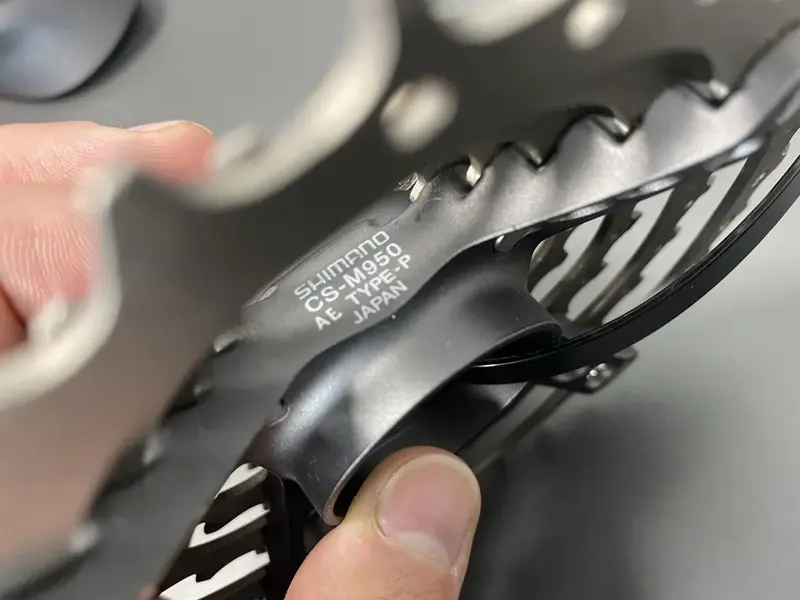

Have taken the opportunity to shed a bit of weight, needed an 8 speed cassette so have managed to find an XTR M950 cassette in 12-32 which is almost NOS, and only weighs 216 grams compared to nearly 500 for the HG50 7 speed cassette I’m currently running, not sure where else on a vintage bike you can save that much weight?!
All titanium sprockets with Ann alloy spider I think, nicely made bit of kit and even matches the colour of the rest of the 600 parts!

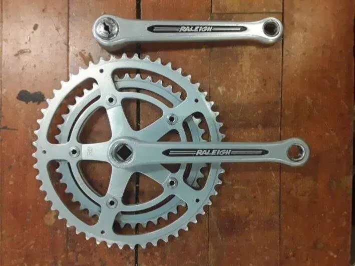

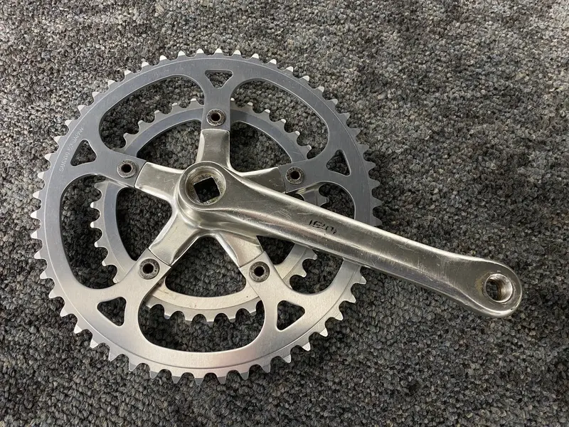

In a quest to make my life easier, I've found a Sugino GT Crankset which has a 110mm BCD, so I can get down to a 36 tooth front chainring.
The Shimano 6207 crank has a 130 BCD, so the 38 tooth inner chainring I've got on there now is a small as I can fit.
Plan is to do a bit of 'pantographing' on this, as I like the look of my current 600 cranks with the engraved Shimano logo.
This bike would have come with a Sugino GS crankset originally, so I don't think this is too off piste!

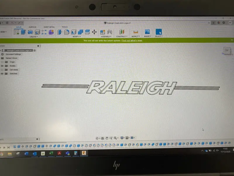

Have knocked up a CAD model of the Raleigh logo that would have been on some of the other SR crankset equipped Raleigh bikes, instead of having the recess and a decal or embossing (there are both types), I'm going to either CNC engrave, or laser etch the crank arms with the logo, and then polish up.
Found a NOS set of 52/36 chainrings, so just need to find some time on a free machine at work to get the cranks engraved now.
Still need to get the rear wheel/hub sorted for 8 speed too.
Should make my uphill efforts a little easier!
