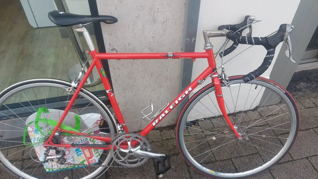

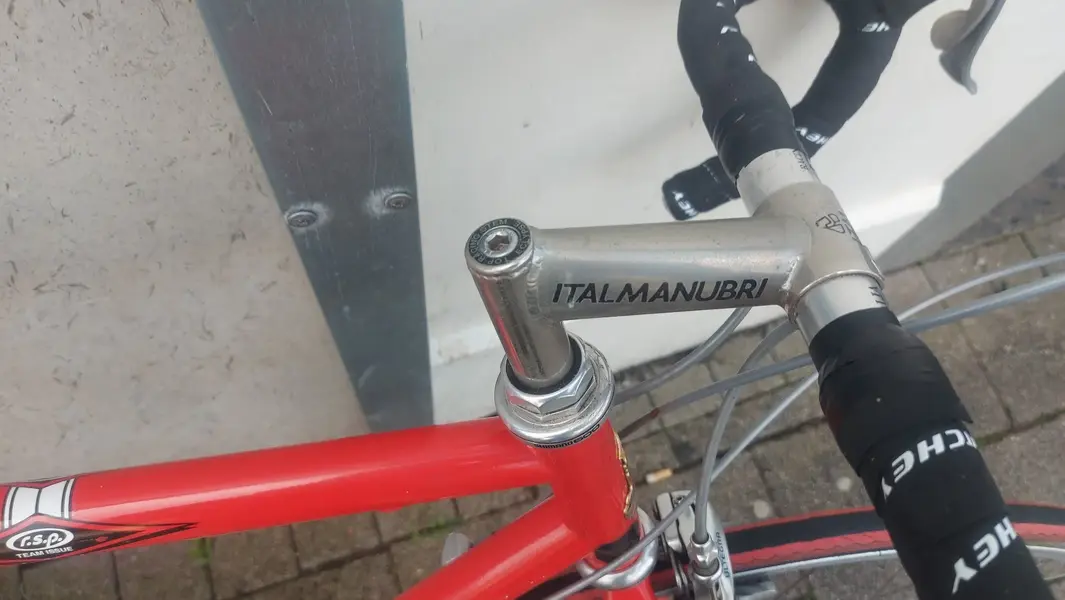

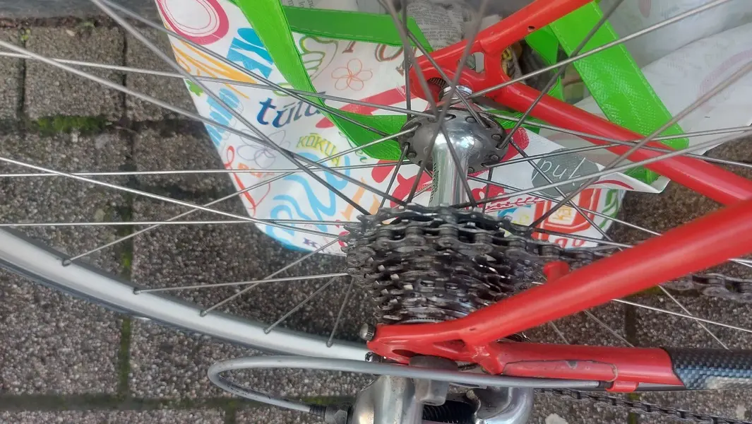

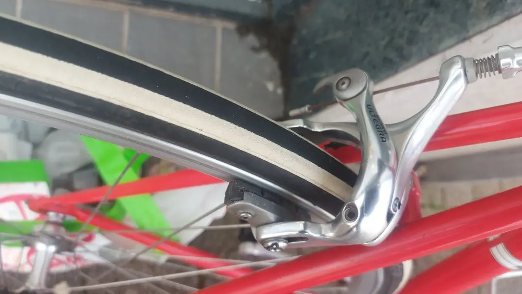

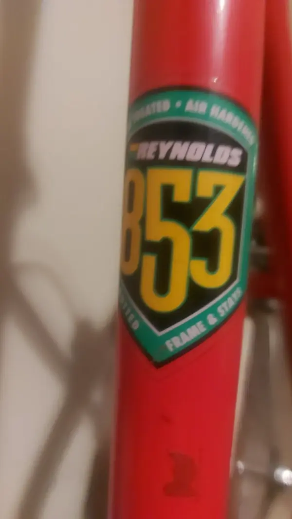

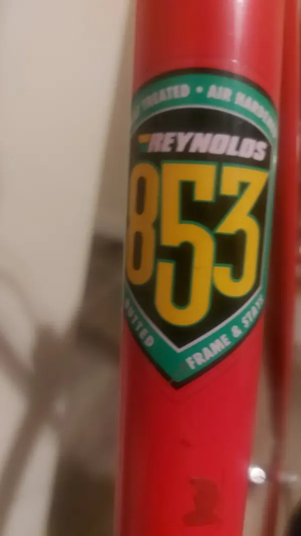

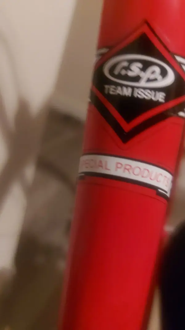

Hi I'm knew to this I always had a interest in bycles as a youth, I found this bike in a charity shop today , I would like to know if it is a genuine Raleigh.853 "RSP team issue " " special products"
As the decals say , I've pics here
