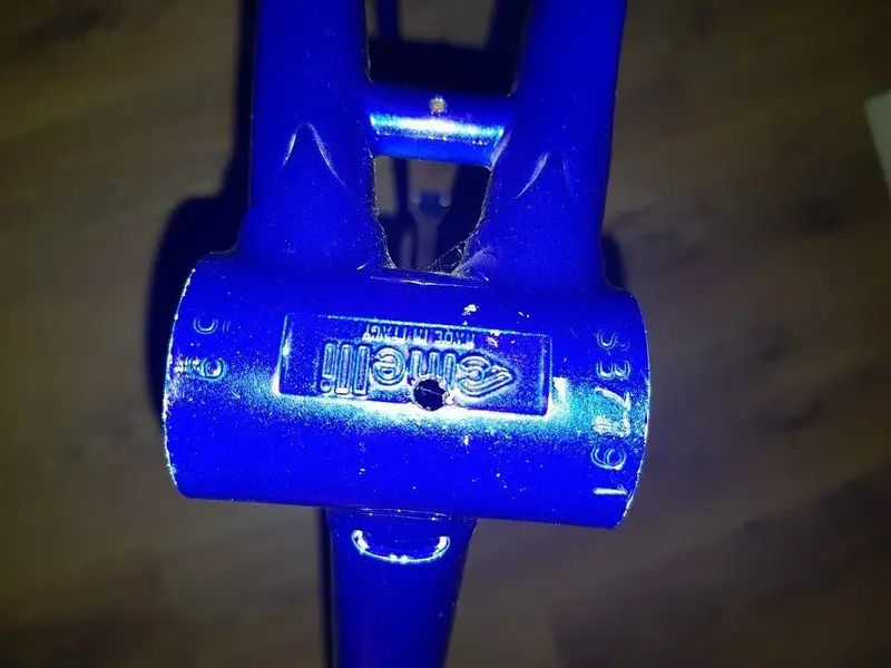

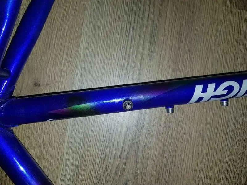

Thought I'd start a thread on this build now that its about to start.
Going back to some point last year Hillary Stone was parting out some of his own frame collection. Being a Raleigh (SBDU) fan I noticed this one straight away.
SB7191 .... early 1985

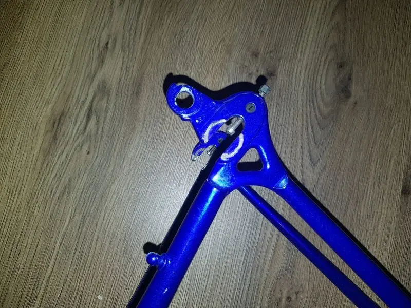

It was a 753 but in a custom paint job. On closer inspection as well as having things like a number plate tag it also had the unusual (for Raleigh) simplex drop outs and front mech bolt.
Hillary advised that it had been sold to him as an ex Malcolm Elliot team frame, while he could not 100% prove it nor did he have any reason to disbelieve the person he got it from. A deal was done ..... it was my size after all.
Once I had the frame in my possession I did some more research to try and confirm was it or wasn't it. I can't be 100% sure but I'm 99.99 % it was / is a Malcolm Elliot frame.
So what did I find out ....
Its the right size to be and ME frame.
Its 1 digit away from another known ME frame which is SB7190 (also has the simplex fittings).
It was only the team bikes that SBDU really fitted with the Simplex bits.
The domestic Weinmann team did not stamp riders initials on the BB.
So based on this the decision was taken to fully restore it to team spec:

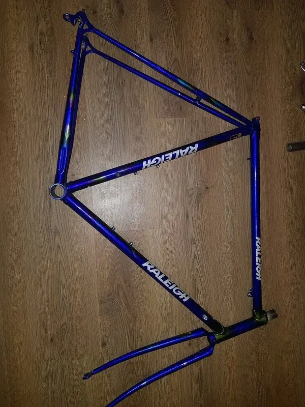

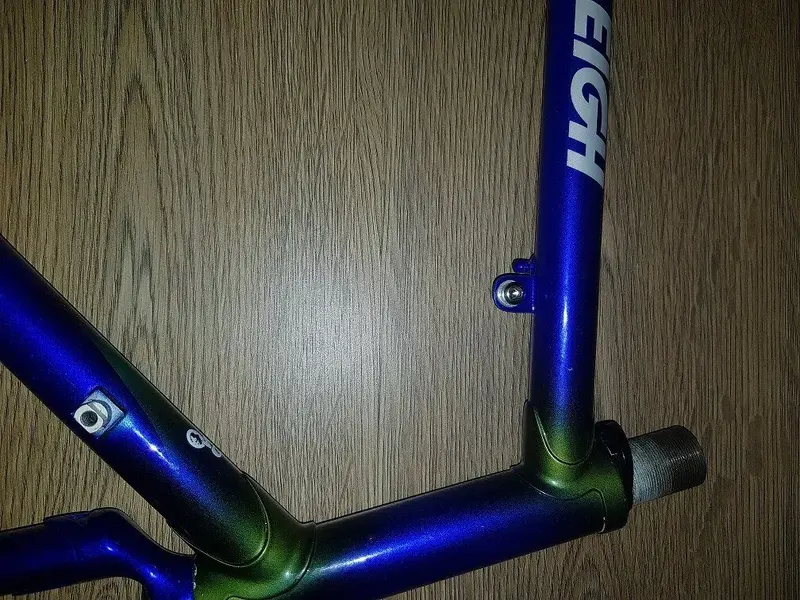

Heres the frame as it stands.....

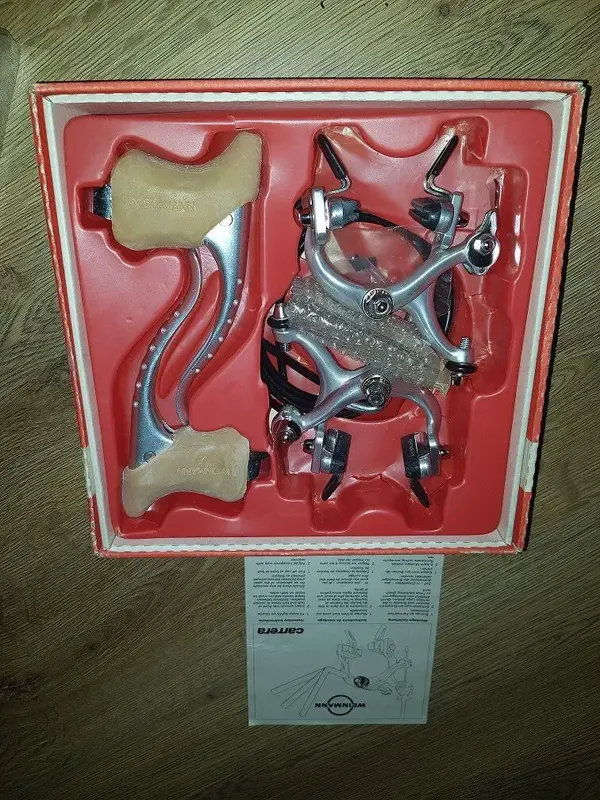

As I mentioned I've had the frame for a little while and didn't really do much with it as the parts looked like they were going to be very hard to find indeed. So as we all do I guess I kept looking and kept doing random searches.
But nothing much ever came up, it was the brakes that seemed to be one of the hardest bits.
Then quite by chance while looking at a Facebook page a few weeks ago there they were. A virtually NOS set of Weinmann Carrera 400 brakes.
The callipers had been used (but not much), but the levers, cables and blocks hadn't. The seller was asking if they had any value ........ hello ... Yes !!! :)
A deal was done which I felt was very fair, the seller was happy to know what they were going on and that they'd be used.
A week or so later and after a smallish fee (they came from the states) these little beauties were with me and they kick started the build.

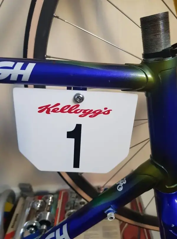

Had a bit of spare time today so knocked this up, will never be exact but close enough I think.

Re: Raleigh 753 SB7191 Malcolm Elliot's - Team Weinmann
I had a set of those brakes. I think they have an alloy spindle. DO NOT use the Weinmann centreing tool (like an inverted allen key) on the hex in the middle of the spindle - it will round it off pretty much instantly, then you'll have to cannibalise a set of old Weinmann 500 calipers to get the (steel) spindles. Centre the brakes using more conventional means, i.e. turning the brake and the fixing nut at the same time.
