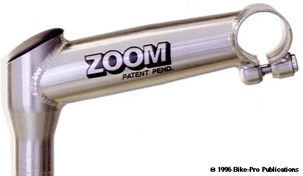

I definitely have a Zoom zero-rise 135mm stem that'll fit your bike (see below). You can have it for nowt, gratis, if you want it, just pay me the postage. (Same as photo below)
I have a a couple of other 1¼" stems, but can't remember what they are. I definitely don't have any Alpinestars branded ones left though.
Re: Quill stem to threadless
Oh, and by the way, you can't use the original Alpinestars handlebars in a non-Alpinstars stem, as they used oversized bulges. (Pardon the term :lol:) So if you take the Zoom stem, you're going to need new bars.
