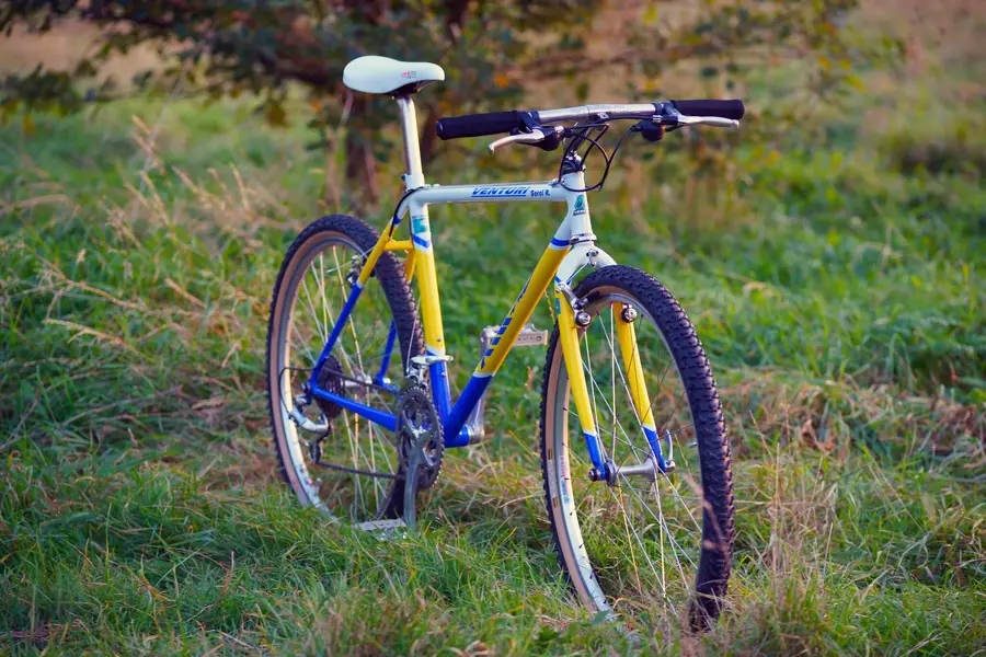

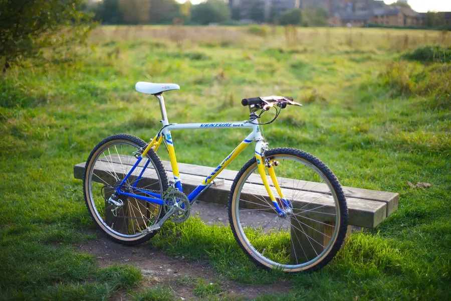

Yes on my Venturi - which I sold a few years back - it’s a beauty of a stem
@kingoffootball has the shorter version
