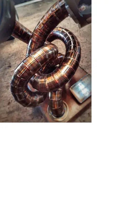

Yeah, as Greencat says, you could lobster back it
