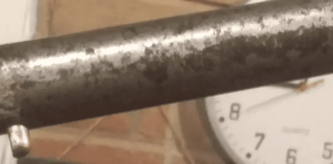

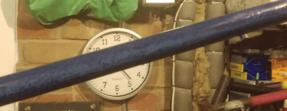

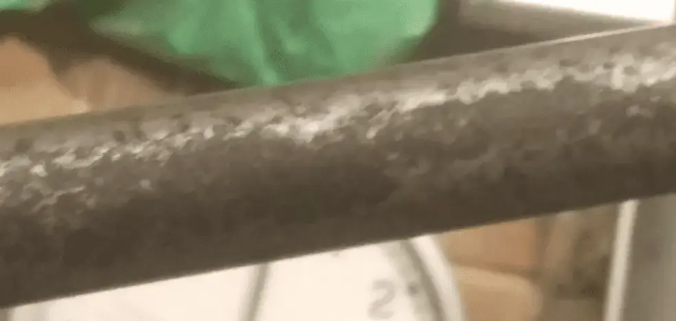

Got the worst of the rust off now, it seems to be only badly pitted in a few places like along the sides of the top tube. I guess that's where its been lent up against things and taken the paint off. I'll rub it down carefully and get the rest of the paint off so as to start treating the rust.
Getting down to some bare metal. The pitting is worse along the sides of the top tube, but could be worse. Trying some curerust prior to filling with primer.
