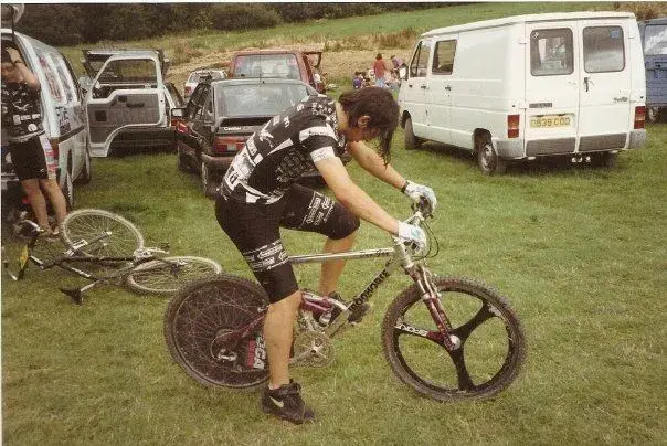

What a gorgeous build and in prime condition . I used to have one back in 93 which i used for DH racing , at the time full suspension was really just starting to come through .Unfortunatley one of my swingarms snaped but was able to get hold of another one fairly easily .They did what they were built for and that was to go downhill fast . It is still one of my favourite looking bikes as it wasn't to over complicated and just looked right . I wouldn't mind getting one again . Heres a photo of me with it with disc drive and tri spoke
