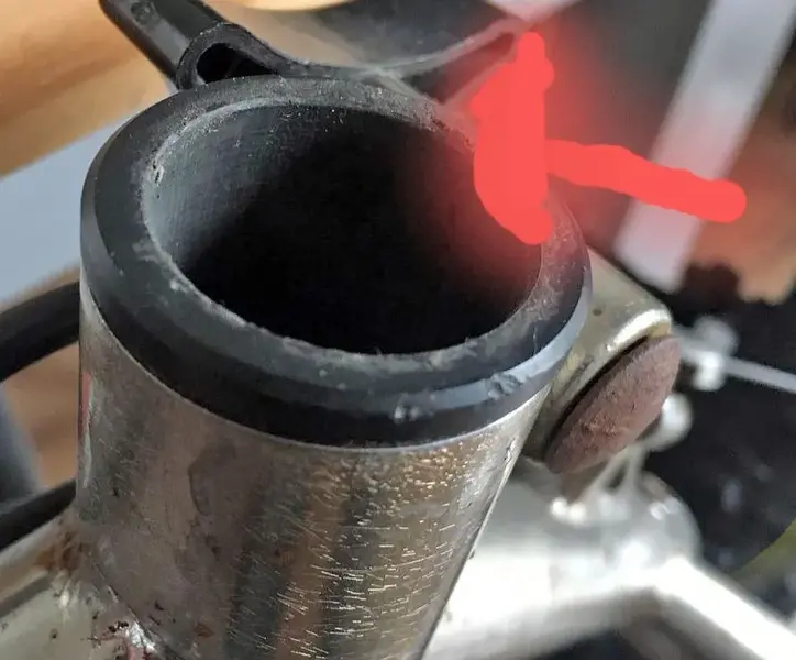

Anybody know the safest method to remove the seat post shim? I dont want to go in gung-ho and risk damaging it.
Handlebar stem is stuck inside forks :( Soaking in Plusgas as i type
Consider using a narrow, flat screwdriver or similar and attack in
The gap at the rear where the frame splits.
Tap upwards below the shim flange.
i guess that might work but dont want to risk breaking the plastic.
decided to leave in place.
