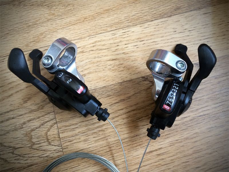

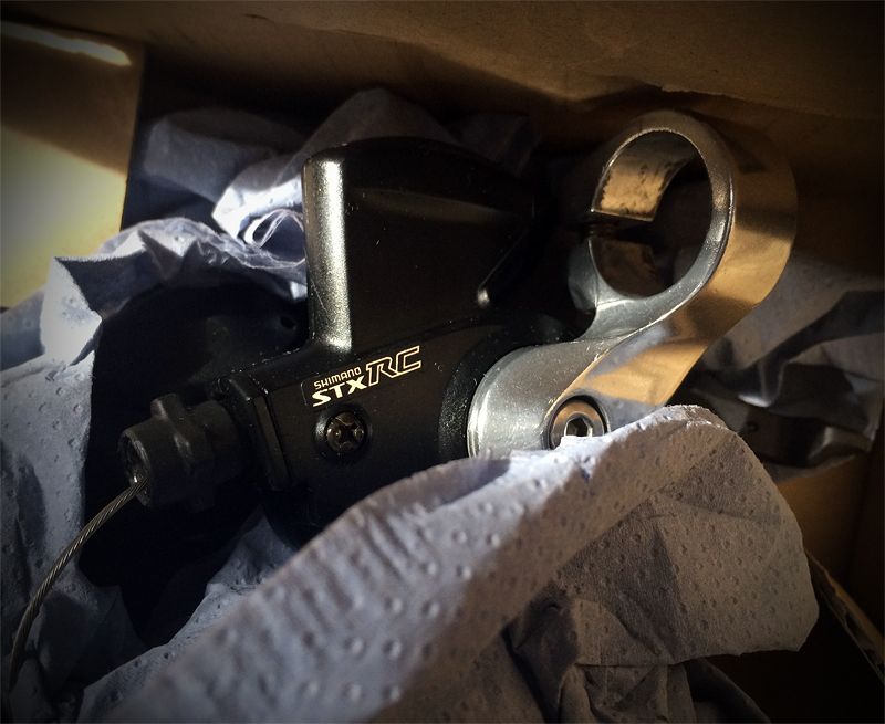

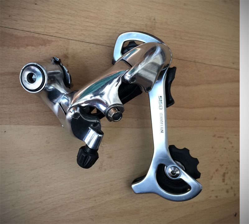

postman called with my ebay swag... makes a change to receive an ebay purchase to find the item better than it looked in the add :shock: 8)
was well packed too :D

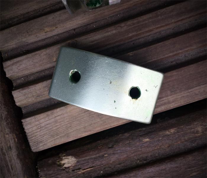

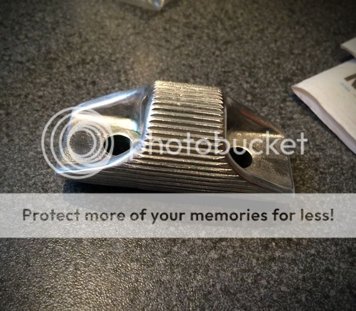

Refined the seat post clamp a bit....
So this is how it looked after a caustic soda bath ...

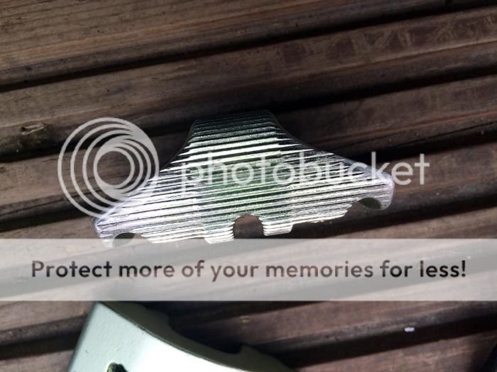

Anodizing 90 percent cleared but still a hint of green remaining. i didnt want to risk further caustic dipping as i feared it may have started eating into the splines. Pitting marks on the top side clamp .... pretty certain they weren't there originally. First attack with wet n dry, as always used wet with a shot of washing up liquid to stop the paper clogging.....

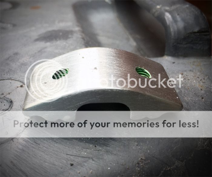

side ...
bit smoother ...

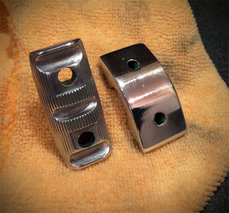

final rub with 1500 grade ...
Break out the Dremel ....
Finished. Not perfect but they'll do.

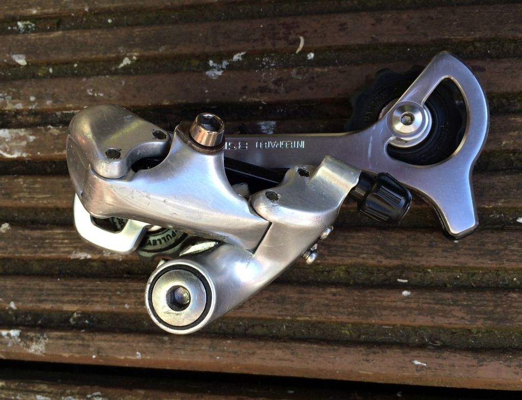

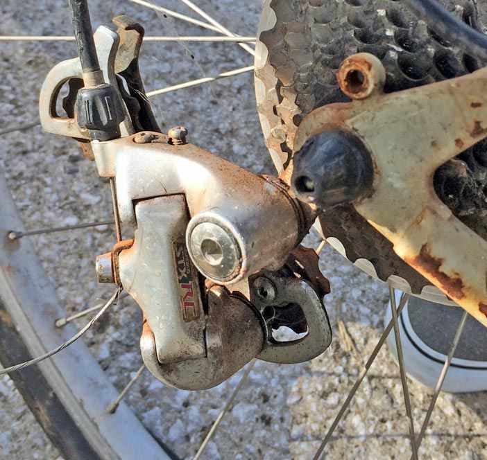

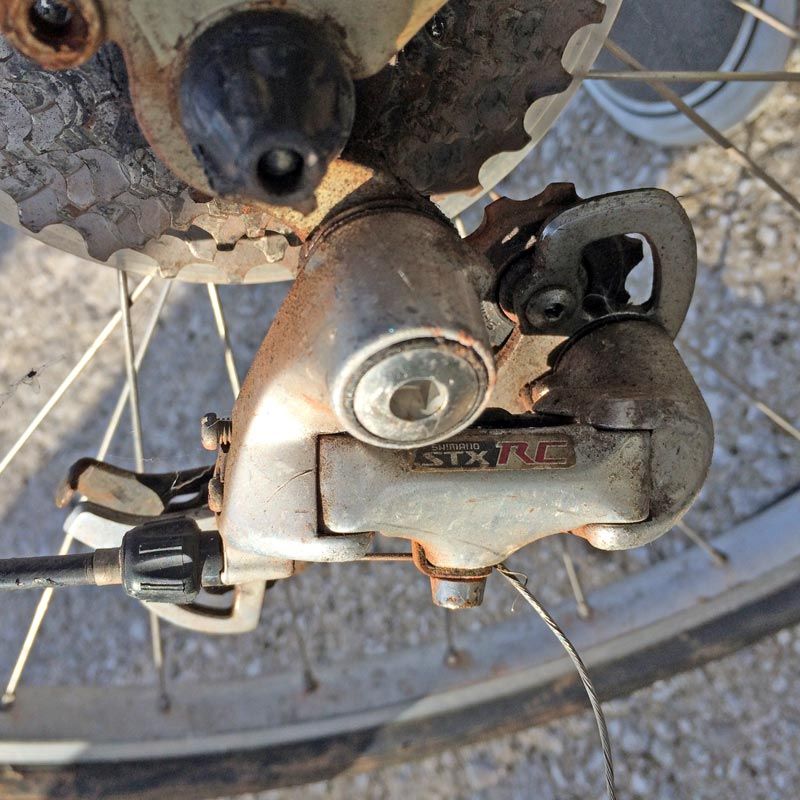

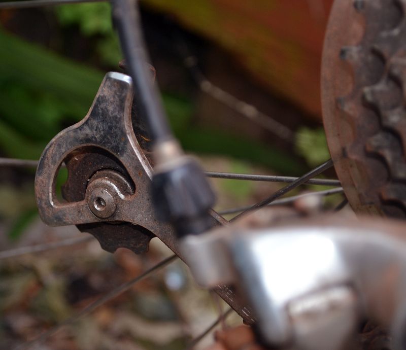

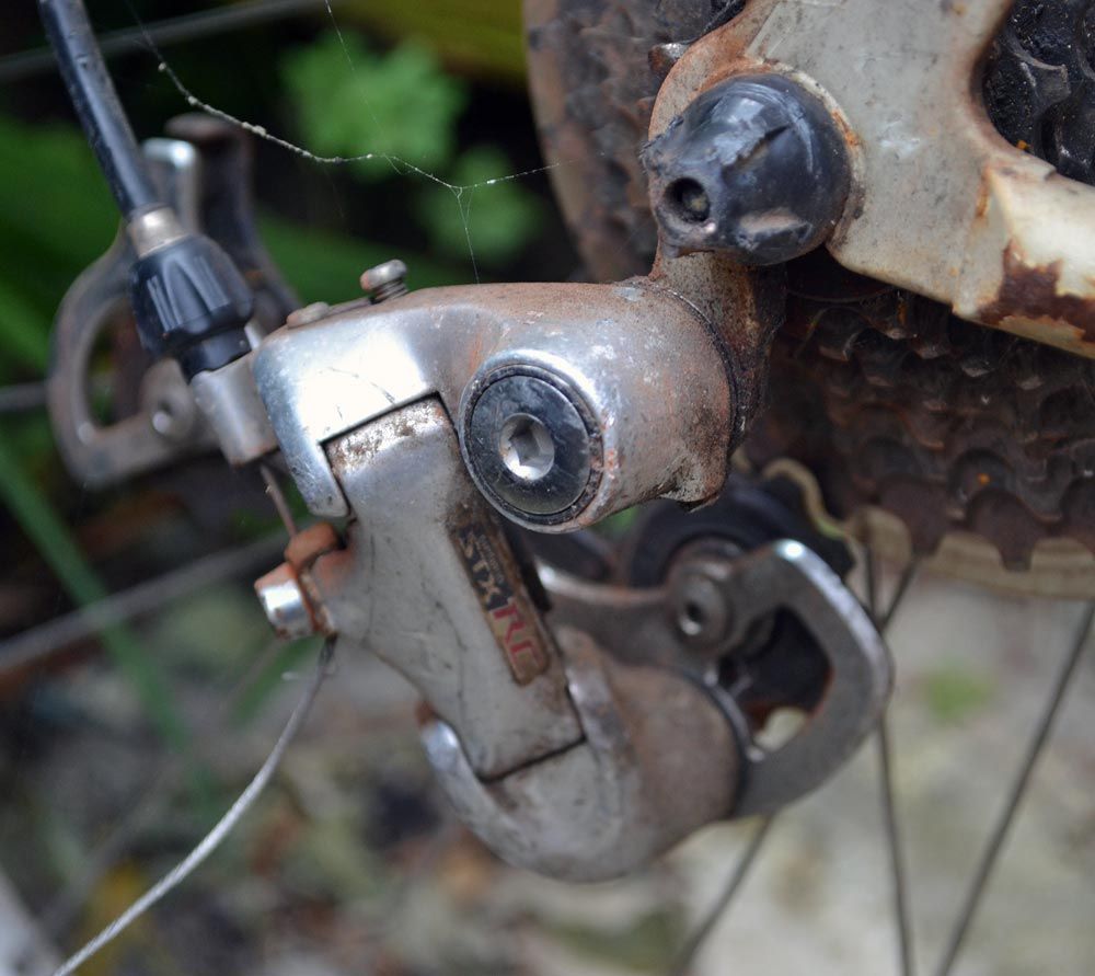

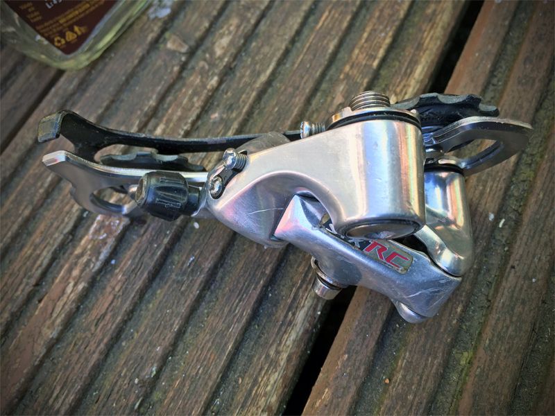

Rear mech clean up time ...

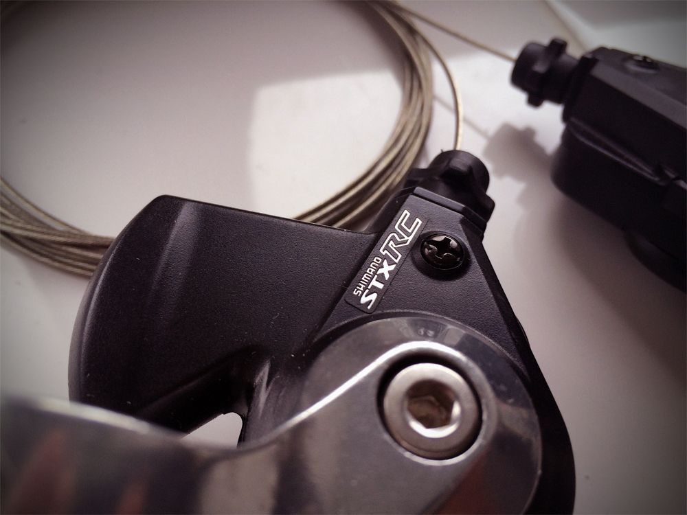

STX RC on donor bike :( ....

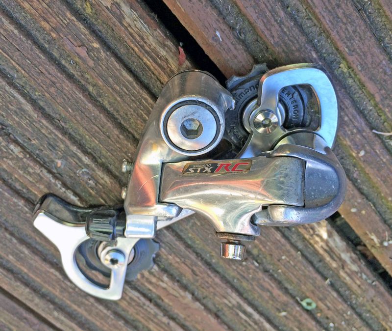

Its been a while then :facepalm:
After Initial clean with paraffin ...

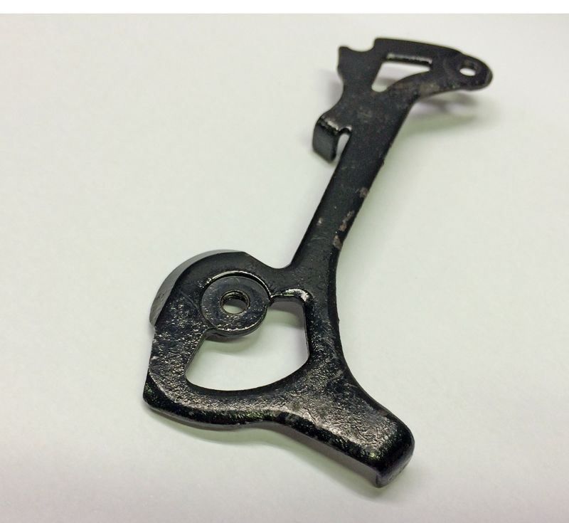

Badge remeoved for deeper cleaning. Hopefully ill be be able to re-apply...

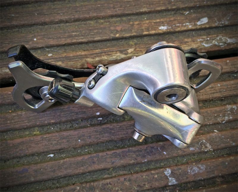

Autosol, fine wire wool and polishing wheel on Dremel ...
Poorboys alloy wheel sealer should keep the surface bright.
Just need to need to remove the corrosion from the cage, treat for rust and repaint ...
