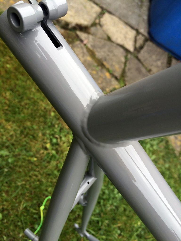

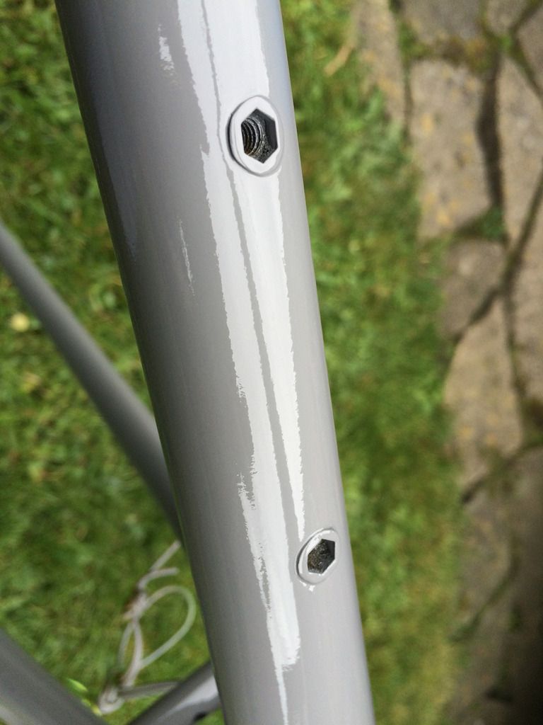

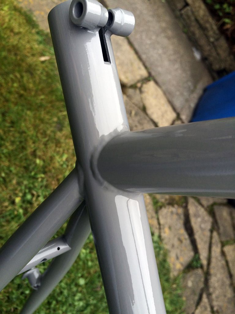

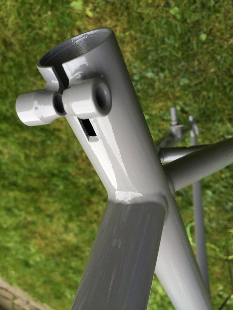

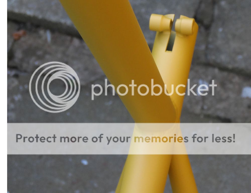

The Upol, etch was playing up... it started to spit :evil: the left hand rear down tube took a hit and i tried flatting it before it was fully dry :oops:
managed to sort it... it'll just need blowing in to finish :)

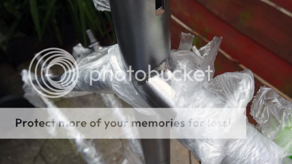

this odd looking image is of shrink wrapped sections of frame where Bilt Hhamber rust eater has been applied ..
Pain to paint without a proper Jig :?
Tis a bugger when spraying then it starts spitting which can sometimes be rectified with a little thinners to just smooth it out a little but judging just the right amount of thinners can be a real mare so leaving it to dry then a little flatting off is my normal oice of action and although clear coat is nice it can yellow a little after a bit of time but your choice of colour will look quite well so keep up the good work ;/0 ..

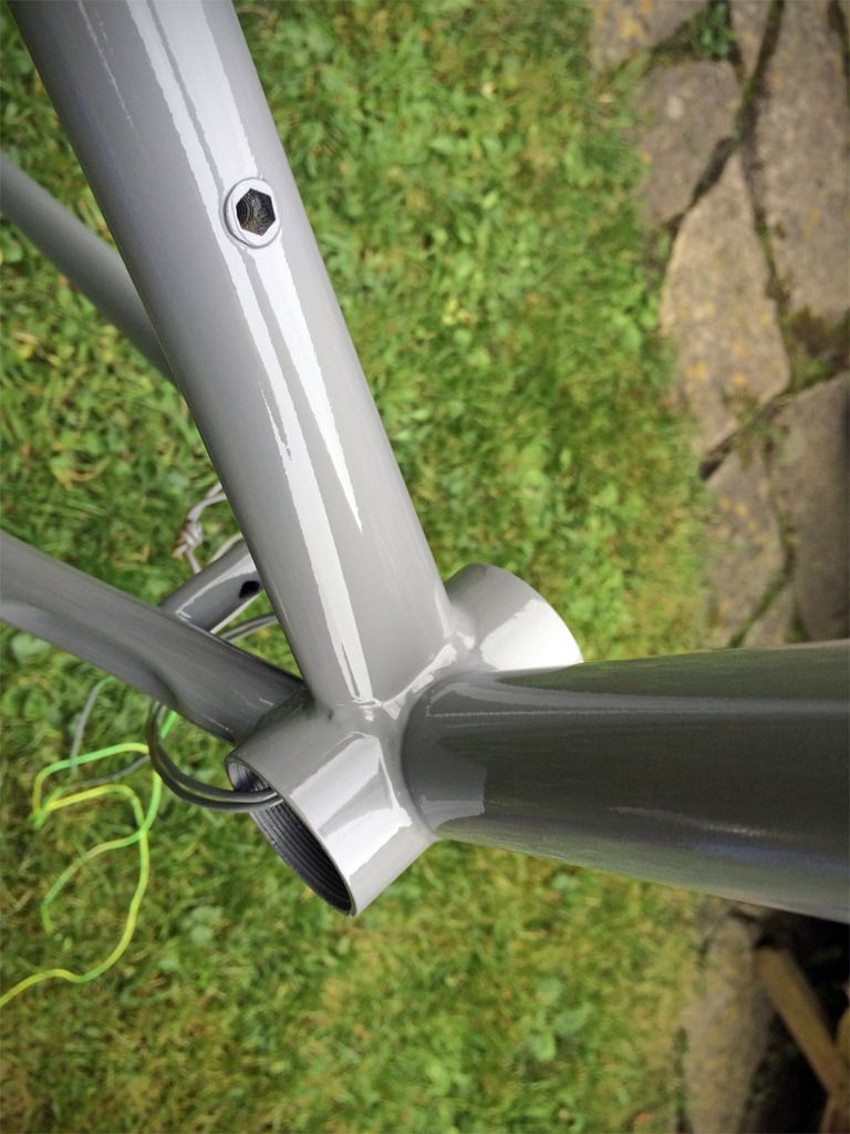

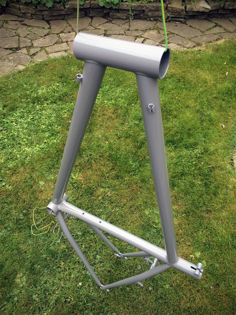

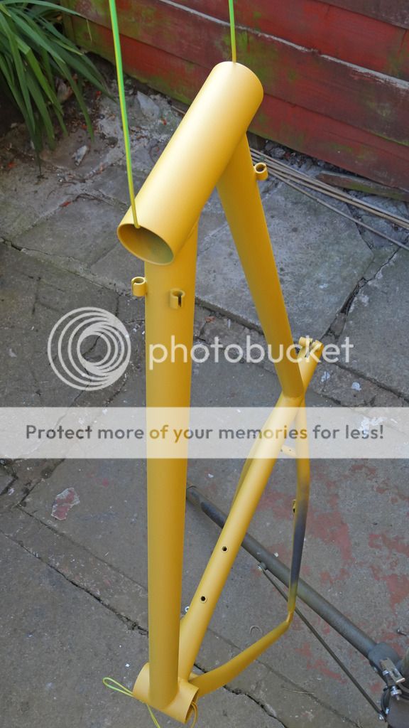

The weather was kind to me again this morning so i took the opportunity to paint the frame.
Now, ive been known to Paint the odd car part ... brake calipers, alloys etc but Ive not painted a bike frame since the early 90's. im not going into detail in this build thread but i will do a separate frame painting guide at a later date.
Of course i could have shipped it out to my local powder coaters and saved a hell of a lot of time .... and possibly money :roll: :lol:
But wheres the fun in that ?
Most of the materials used here i had "in stock" in the "how to" thread ill add up what this would cost to DIY.
Im pleased at how the frame has turned out ....
One aerosol and a bit over for emergencies :D
