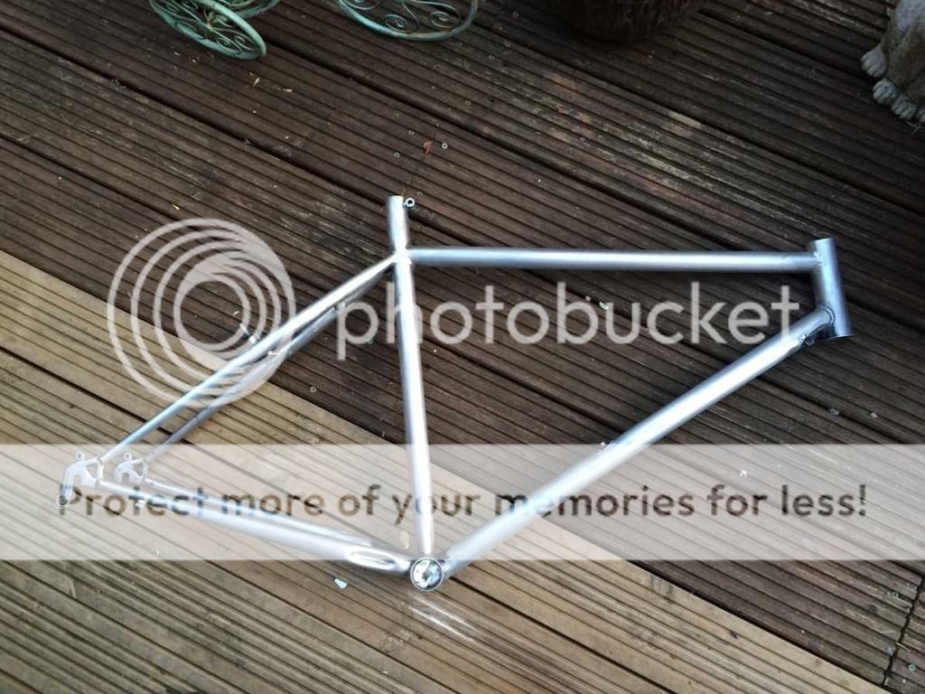

The frame will be painted out doors or in my garage with open doors, so with the cooler and wetter weather drawing in, its time I got some paint on the frame.

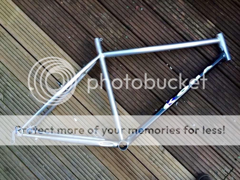

only the down tube and crannies under the head tube, crank shell and cable stops had paint remaining. As with the rest, the main tubes were hand sanded with p80 used wet. Crannies were attacked with wire brush drill attachment ... Some of these areas will need further refinement with the Dremel.
Surprisingly, considering the rust patches on the frame there is very little rust pitting to be found.
Bye bye KONA ...
Last of the paint removed ....
So with the prospect of some decent weather this coming week end (fingers crossed) the plan is ...
Refine surface with up to 2000 grit wet and dry
De grease
Etch prime
High build primer ( where required)
Prime
Colour coat
Clear coat.
