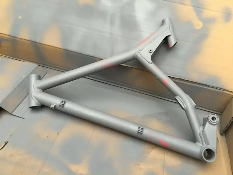

This has been a labour of love and has taken weeks. The original paintwork was a bit tatty and blistering in a number of places so I stripped off the decals and wire brushed anything that might be loose. I followed this up with plenty of sanding to flatten out any significant chips. In the past I have completely stripped frames back to the bare metal but even with acid etch primers the ‘home done’ finish never seems as resilient as the original factory finish, so where possible I have left the original paint in place so as to get a good key. Anyway, I primed over the original paint and quickly found the areas that needed further preparation.
After this I re-primed a few areas and put on a couple of coats of red primer followed by a couple of enamel top coats. I used Halfords Enamel paints (RAL 3020) which looks as close as I could find to the original colour. Lots of flatting, painting, flatting, swearing etc and I managed to get a consistent flat finish. Decals applied and a couple of coats of lacquer. At each stage the frame was dried using a homemade ‘oven’ consisting of a heater, tin foil and some large boxes.... i am not looking forward to the electricity bill!
Now on start putting it back together.

I'm loving your work and commitment to detail as it's really inspiring but what i would like to know is what were all the grades of wet n dry paper that you used for
the polishing mate as i might be giving it a go myself .
Hi, thanks for the feedback. I am really enjoying the project. For the paintwork I used 600 grit paper followed by 800 to prepare the parts. I then used 800 grit between the various coats of paint followed by 1500 grit between the final colour coat and lacquer. I did not bother sanding between the lacquer coats, instead I let them dry for 15 mins using a heater and then re-sprayed. I wanted to ensure the decals were fully covered before a used the sandpaper again. After the frame dried ( I gave it 2 weeks) I lightly sanded with 2500 grit and then gave it a once over with T-Cut and a wax polish.
With regards to the metal polishing, I used 800 grit if the surfaces were damaged or scratched, then used 1500 grit and autosol. I fitted a buffing pad to my drill which made the job easier, however it is messy. I cleaned the parts up afterwards using alcohol gel ( the stuff you get in hospitals to clean your hands) and a cloth. That said wire wool or Brillo pads do a good job as well. You can get the 1500+ sandpaper from Halfords.
I have read loads of threads about the best way to protect polished aluminium and for now I have waxed them, however the decals seem a bit vulnerable so I am planning to put helicopter tape on the sides of the swingarm and the fork legs to protect them. I will be ordering some spare decals as well in case it all goes wrong!

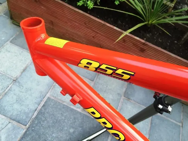

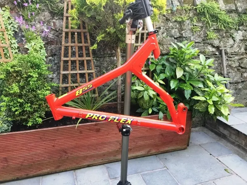

Re: Proflex 856 Restoration... turned into an 855 Resto!
Well the original 856 frame has been sold on eBay, but the 855 is finally finished, off for its inaugural ride this weekend. It’s pretty much all original, the only concessions are:
• Hope Ti Glide Hubs
• Some modern SPDs (Whilst I track down some M737 pedals)
• Charge tyres
• Springs, I may try elastomers in the near future, but I fancy yellow ones so may be obliged to manufacture my own.
• Cheap cantilevers – these will be swapped for XT ones in the near future
The cycling jersey was a present from the wife :D
