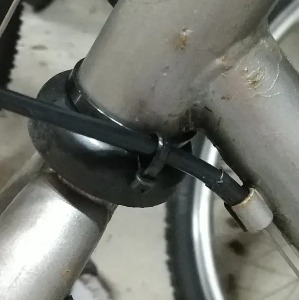

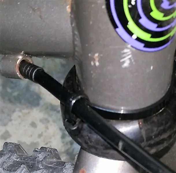

I use three cable ties to stop head tube rubbing - a large one around the head tube which holds two smaller cable ties to hold the two gear cable outer casings. You have to leave some slack on the smaller ties tho.
This is my "beater" so the paint was already well rough.

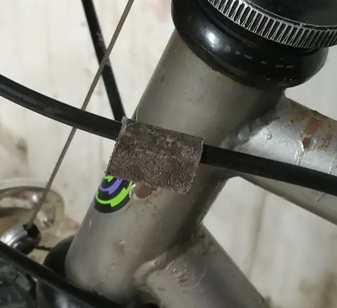

You could also put something softer around the cable casing....like this leather patch that I found on this.
