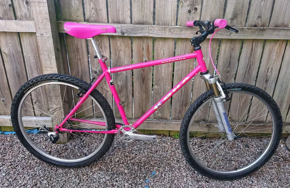

Out in the sunshine this afternoon, I've actually re-used the 200GS rear mech and shifter as they cleaned up nicely, and also the Bontrager "Trail Connection" tyres have gone back on.
Finally found a use for the pink Charge Bucket saddle I've had kicking around for ages! :lol: and pink Burgtec grips from a recent modern bike purchase, it really is a "bitsa" build!
Still cabling, chain, and fettling to do yet...

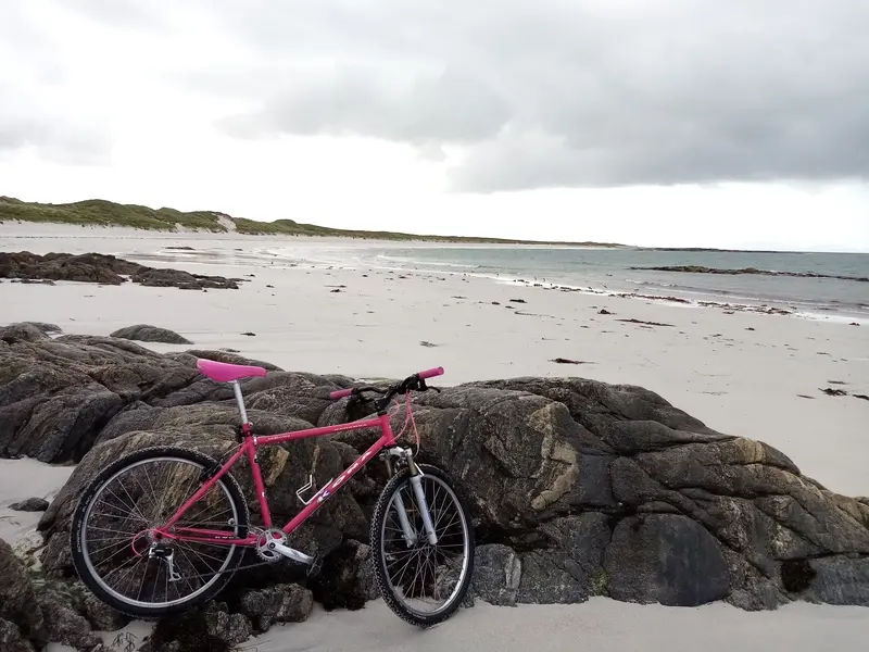

Well the Hahanna has been finished for several weeks now, but remained unridden. Cables and chain were added, and tyres changed for some Schwalbe Black Jack in 1.9 width from another donor bike as the Bontrager 2.1's left very little clearance at the chainstays.
We went for a few days on North Uist in the Outer Hebrides last week, I took my road bike and the Hahanna as well , Mrs jimo746 didn't feel like bike riding :roll: no surprise there :lol: so I raised the seat and took the pink Hahanna for a ride around some of the beaches on the island.
It rode just fine, brakes work, suspension works, and the 1x7 gearing was fine for the flat beaches and local lanes.
To be honest, I might give it a ride now and then as it was quite good fun to ride :D and the cost to build it has been minimal. Win Win!
