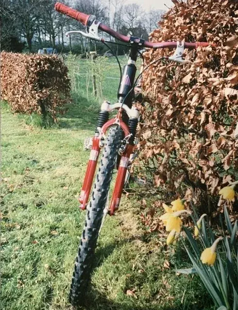

Here’s mine shortly after I did the conversion in 1995.

That is exactly my problem. Affixing a fork looks doable, but will it look good with that darn oversized headtube?
Thanks for the pictures!
