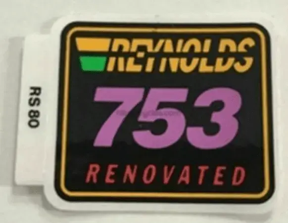

The 753 Pro is a quality frame and usually comes equipped with Shimano 600 or Campagnolo Chorus groupset. Not a repaint. 753 decal is original and correct. For info the "renovated" sticker for post 1989 Columbus frames looks like this if the resprayer chooses to indicate it!
Thanks, great to know and I did think the paint was original, as the buyer I bought from said he had owned the bike for the last 20 years and had no reason to doubt him. Yes, has the Shimano 600 groupset.
