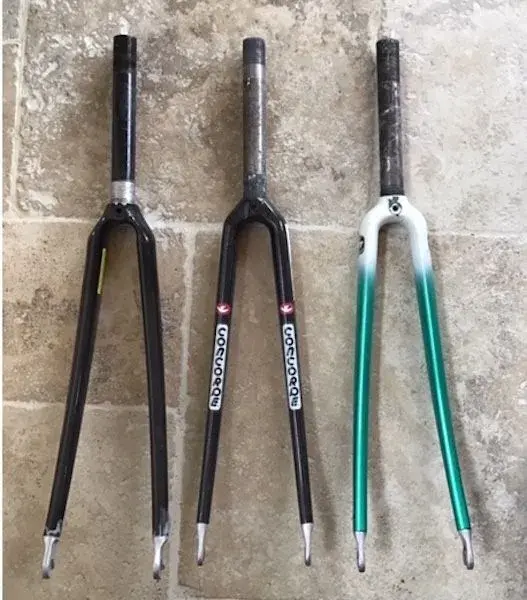

Hi Thomas,
I looked at two other forks a Nashbar - which was too wide from a side view and the Look fork - the crown of the Look fork is slightly different, the rest of the fork is a good match

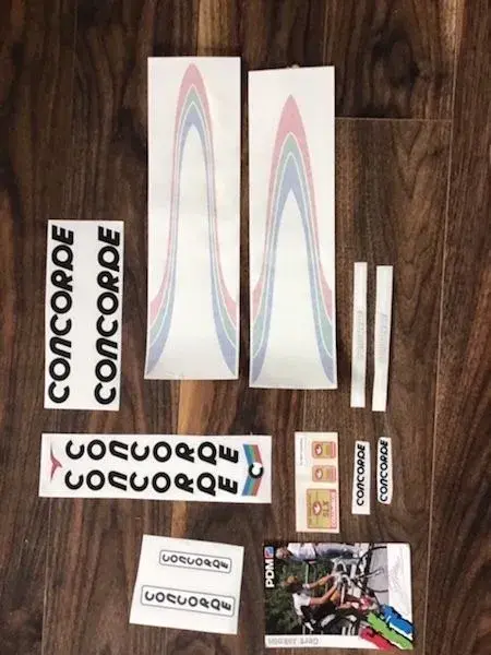

Just waiting on two decals to complete, hopefully I will get these on the frame next weekend

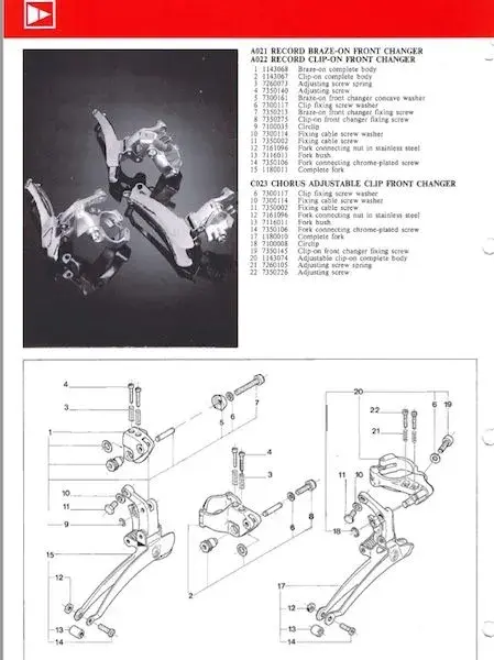

Hi Thomas
On the components, I will look again at the rear deraileur, a 1990 C Record or 92 Athena 8 speed might look better. They look similar.
I am happy with the front deraileur, it has the adjustable band-on. I have the C-Record version on my Greg Lemond TVT and they are expensive and hard to get in any case.
Interestingly the chorus adjustable front deraileur was listed as part of the C-Record Group in the 1988 catalogue
Pat yes, I know ...but this is for my opinion the simple and cheaper version, normally you need for C-Record type especially
the version with the graved Shield Logo and the flat front baffle. And absolutley you will build a most authentic PDM teambike
replica
I have done within my 1990 Team Z TVT92 (with the divided steering tube) with a Record type braze version in combination
with a simple no-name clamp-on adapter. The origin clamp-on Record type version is very difficult to find and the braze version
with adapter look more better than the Chorus type clamp-on FD
Hi Thomas,
Yes, the C Record front deraileur does look better, the chorus looks more thinner and more modern if anything!!
I will look at it again and try and find some photos!!
Pat
