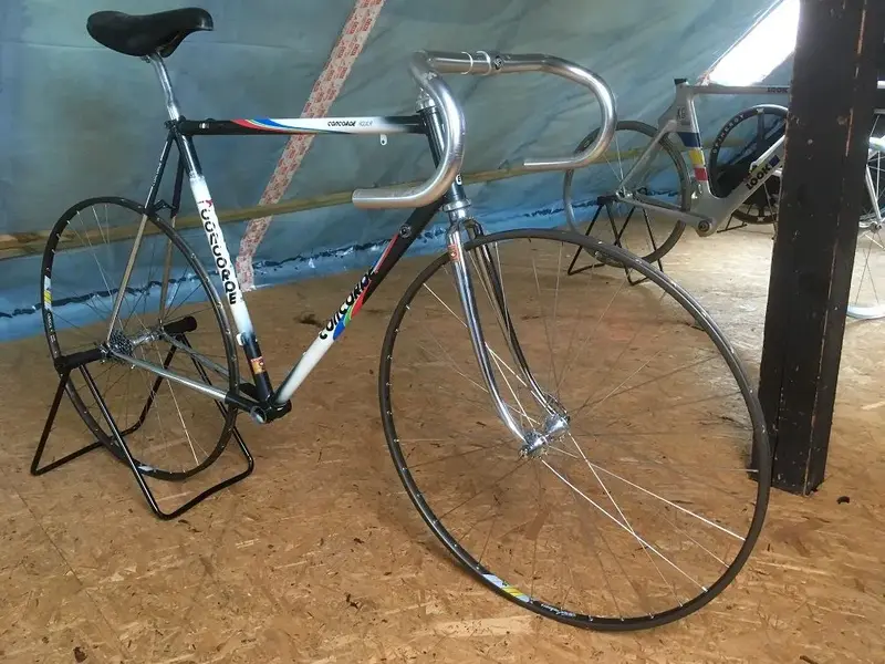

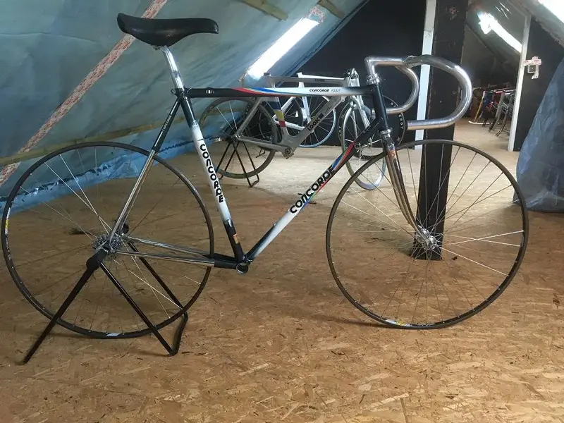

here are the last pic I saw of the unfinished PDM TVT Project of our unforgotten @Stringfellow1946
I have a similar project based on a steely Concorde AQUILA

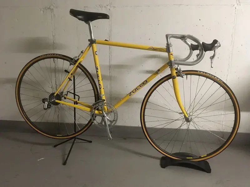

… and here first pics of my current TVT-Project - here a pic of the original in 1992 of TVM-Sanyo Team and their rider Gert-Jan Theunisse
and here my rebuild

I absolutely love the TVM Zullo project. I do notice that Theunisse's original TVT "Zullo" does sport the "marble effect" paintjob. Are you going to get that replicated?
and here my rebuild
T92
@Ruimteaapje
Sorry No - it wasn't too much for the painter who paints the TVT in yellow, but I think the yellow coulouring should be enough.
But I will open my own thread for the construction of the yellow Zullo TVT92 Carbone, where we can discuss all these details
... and so don't hijack Pat's fantastic thread for rebuilding a PDM called TVT92 :mrgreen:
