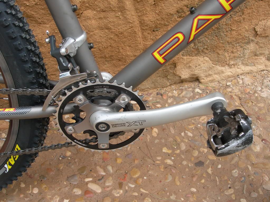

coghog (from the original build) - they definitely improve shifting!

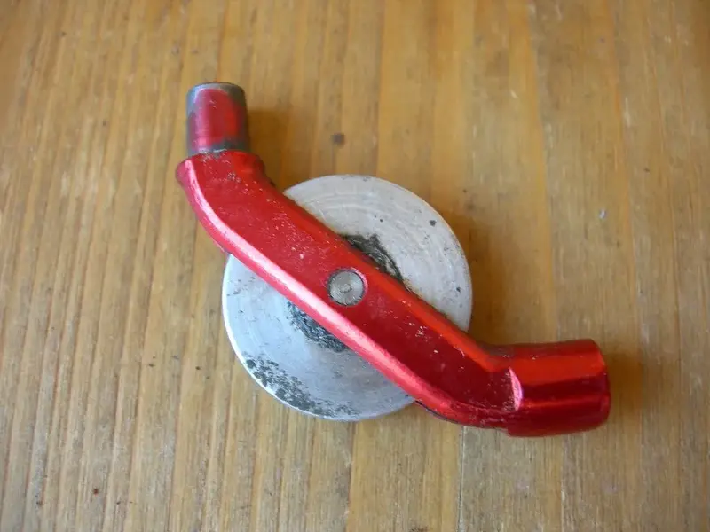

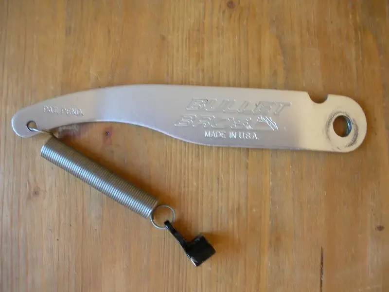

bullet bros chaintensioner - I had a red one BITD that worked great, then sold it on here. when I decided to build the bike up again a knew I wanted another one, and silver fits perfectly!

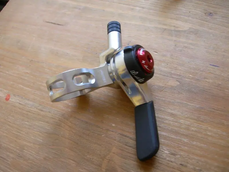

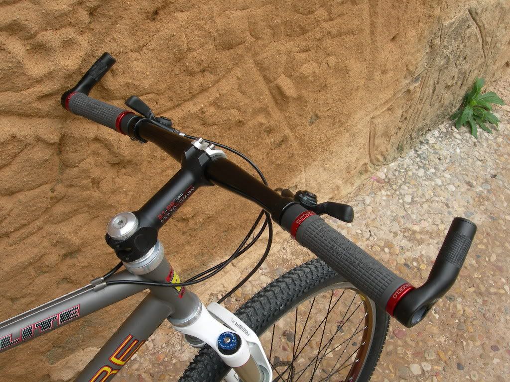

but I just got a parcel - my thumbies arrived! From taiwan to spain in a week - faster than some stuff that comes from the UK!
I wanted thumbies as I like the simplicity, and they keep the retro style nicely. Going to a 9 speed drivetrain meant I was a bit limited though. In the end I went with the new microshift 9s index thumbies, which now have a friction option. only 112g the pair (not including cables and outers, which were included in the box!). They look and feel quite similar to the old suntour thumbies - a lot sleeker than shimano - and have a very solid feeling click and nice ratchet.
now i just need my forks back from the LBS, and my bars should have arrived by now too!
Do these thumbies index properly so one click and it is in gear? Also what is the friction option?
Also good updates so far :)
Well I haven't fitted them yet, but playing around with them a bit there 8 very solid clicks (the tension can be adjusted to require more or less force to move the lever), and they're supposed to be shimano 9s compatible, so I see no reason why they won't work just like any other indexed thumbie (deore, XT, suntour, etc) - one click per shift.
The LH lever is a power ratchet type feel, so infinite adjustment of the front mech.
The friction option on the RH/rear lever is just that - friction. Means they can be used with any rear mech and cassette (without indexing), or if something goes wrong midway through a ride (bent mech or hanger, for example), then you can just select friction and still have gears :)

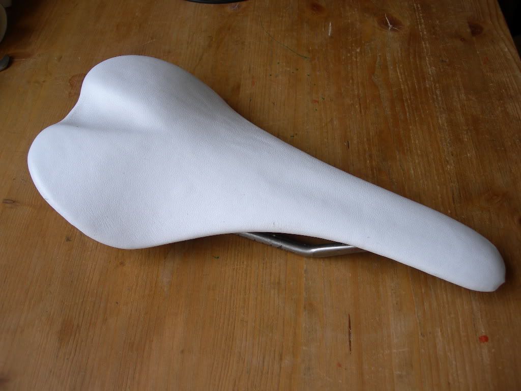

I got my saddle finished though - an SLR that I bought on the forum. It had already been stripped down to just the shell, so a quick clean and recovering with artificial leather has left it looking decent. Now I just have to decide if it fits my arse, and the test saddle I have on while building is black, which I think might look better than white :?

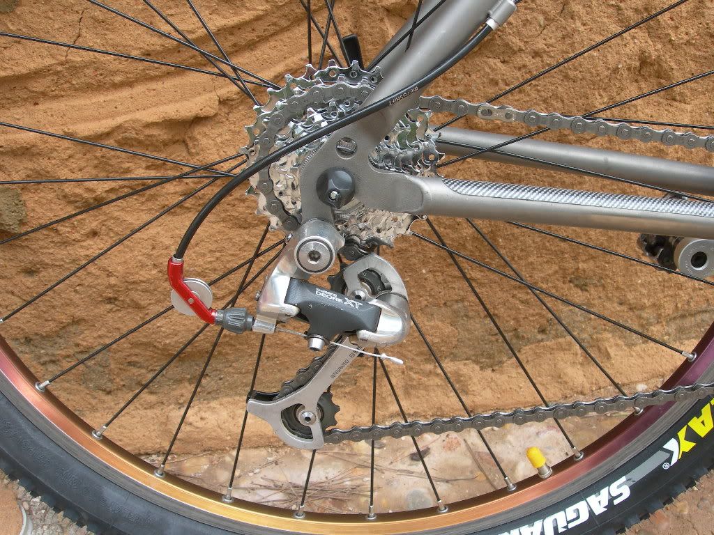

I found some great condition suntour XC pro thumbies at an unbeatable price, so have decided to stick with 8 speed. Why I can't just make my mind up before starting I don't know, but then half the fun is just taking a build as it comes and seeing what it ends up like!

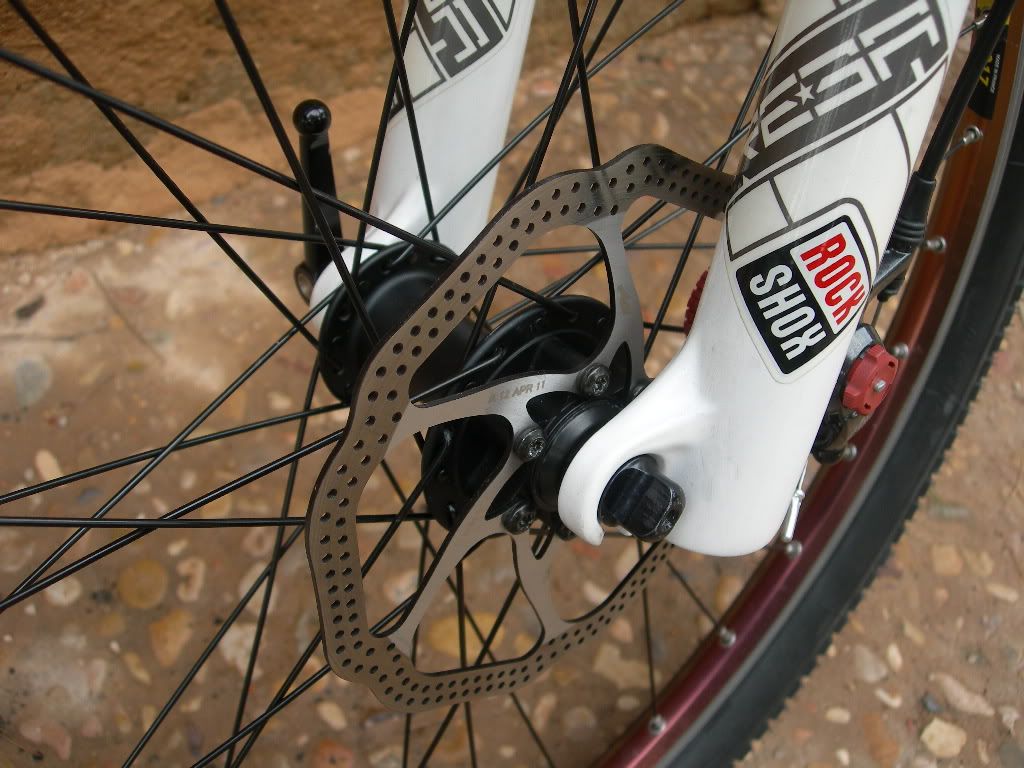

My early avid mechanical disc brake exploded and I lost bits all over the place (I'm still find them occasionally!), so I ordered a new one, 2012 model, which arrived this morning.

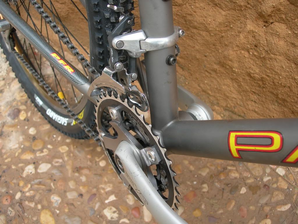

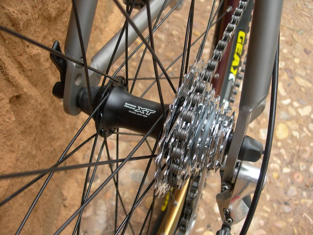

Got a sunrace 12-28 cassette from the LBS too, and changed the goldtec chainring for an FSA which looks a lot better and is slightly thinner, so I don't need to find washers to space out the inner. Swapped the inner from a 26t middleburn to a 24t, since I'm only going to 28 on the back and not 32 (or was it 34?).

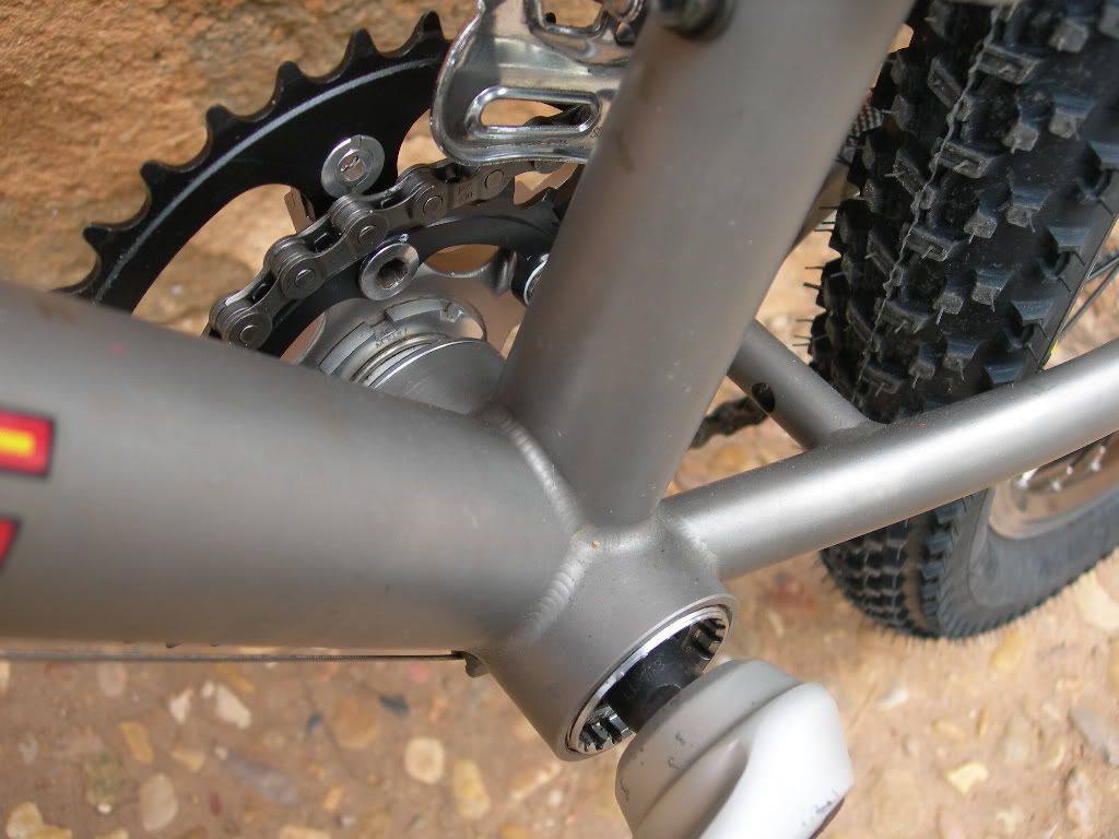

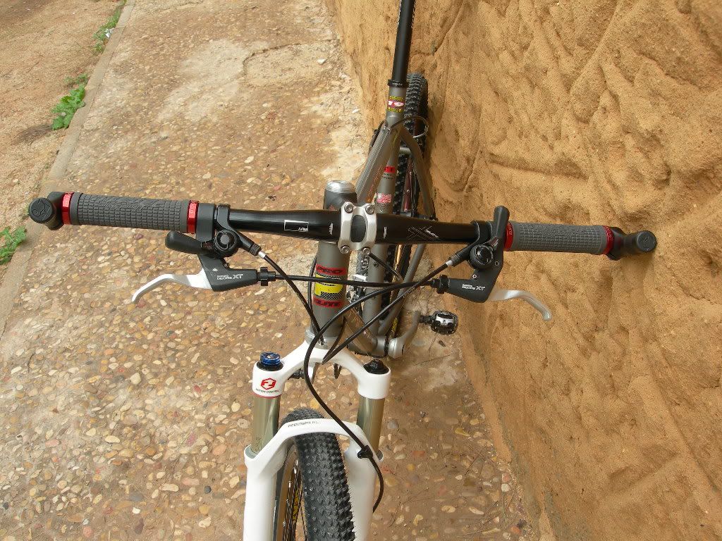

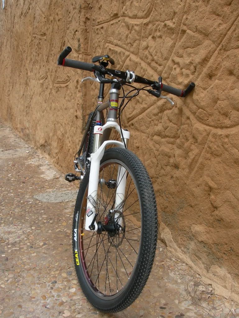

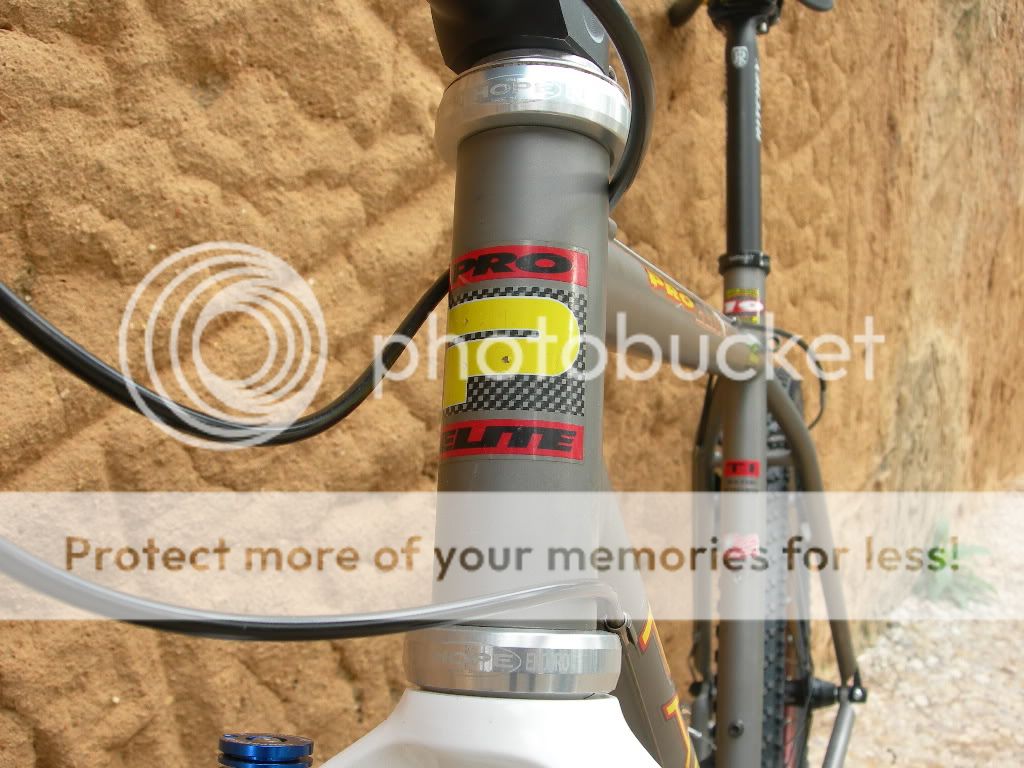

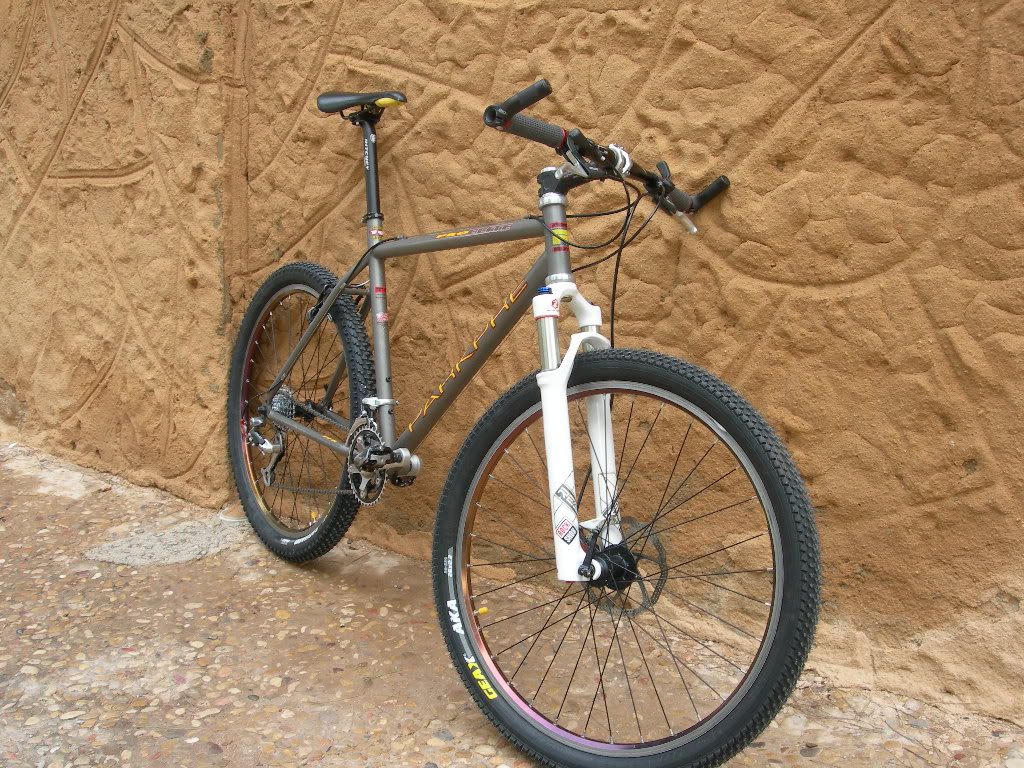

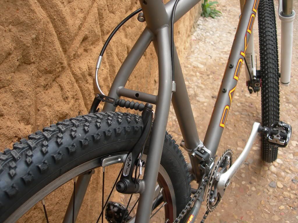

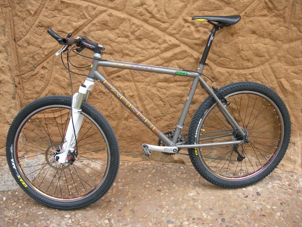

Finished! I got the avid sorted this morning, and went out for a short ride. It squealed like no brake I've ever heard before, but after bedding it in it's nice and quiet and very very good! it's the first time I've ever ridden a disc brake of any sort, and I'm well impressed - I can raise the back wheel off the ground while seated and braking with one finger! :lol:
The gears all index perfectly, front and rear which is good news - I was a little bit worried the suntour shifters wouldn't play nicely but they do :)
The saddle is only temporary while I get another one sorted, but it's actually not uncomfortable and might end up staying on there! I forgot to put the bar end caps on too :oops:
Full build spec:
Frame: Parkpre Pro Elite Ti, 19" (1995)
Fork: Rock Shox Reba RL set to 80mm (2012)
Headset: Hope Enduro 1_1/8" (2003)
Stem: Deda Newton Road 31.8 / 120mm (to be changed when I'm sure of the length) (2006)
Bars: XLC Comp Flatbar 31.8mm (2012)
grips: Peaty clamp-ons (modern)
bar ends: UNO stubbie (2012)
Seatpost: Ritchey Comp 27.2mm (2012)
Saddle: Iscaselle/Gipiemme Road saddle (early 90's)
seatclamp: M.Part (modern)

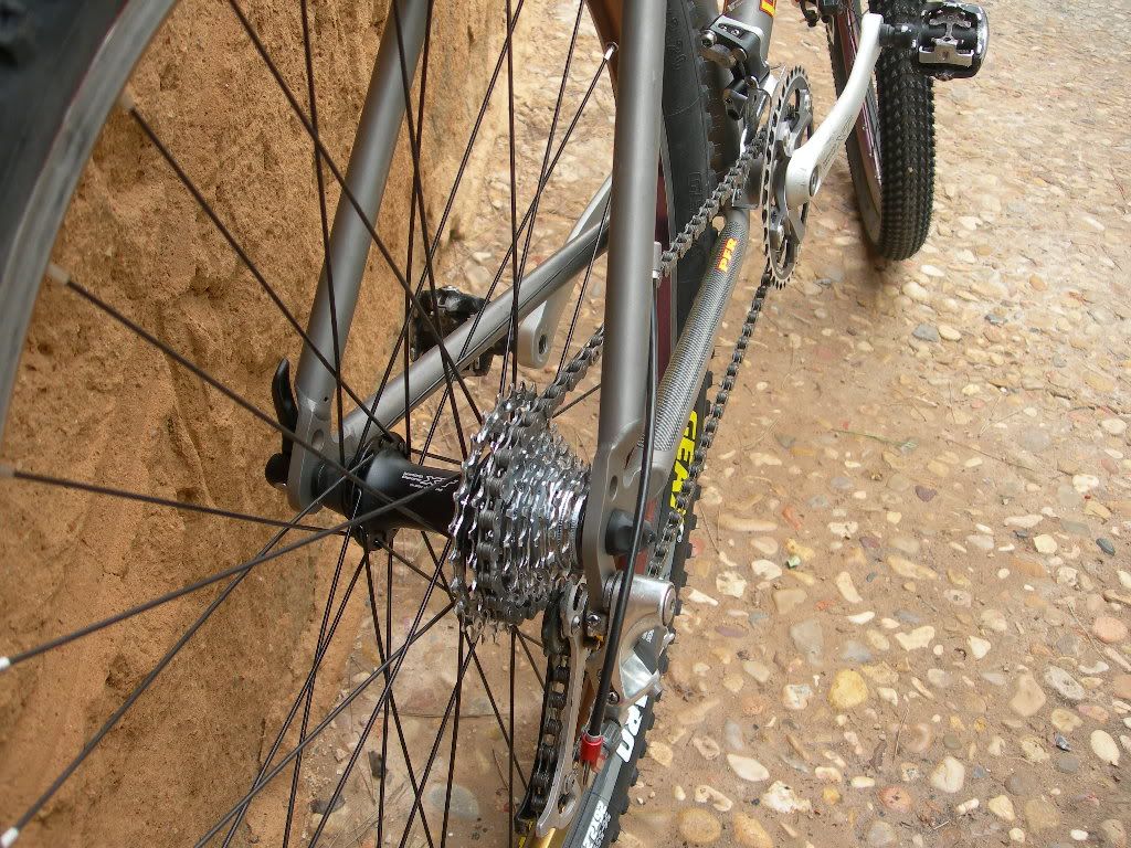

Gear levers: Suntour XC Pro 8s thumbies (mid 90's)
Front Mech: shimano XT M737 (1995)
Rear Mech. shimano XT M739 8s (1995) with a cog hog (1995)
Cranks: Shimano XT M750 175mm (early 00's ?)
Chainrings: FSA 38t middle/outer, Middleburn 24t inner (both modern, I think!)
BB: UN51, 113mm (1995(
Cassette: Sunrace 12-28 8s (2012)
Chain: Sachs 8s (modern)
cables: jagwire/microshift (modern)
Brake levers: shimano XT M739 (1995)
Rear Brake: shimano XT M760 (2012)
Front Brake: Avid BB7 mechanical with HS1 160mm rotor (2012)

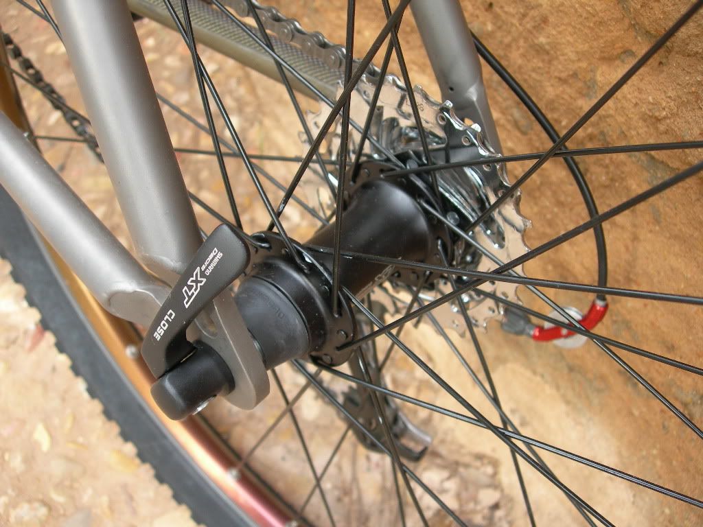

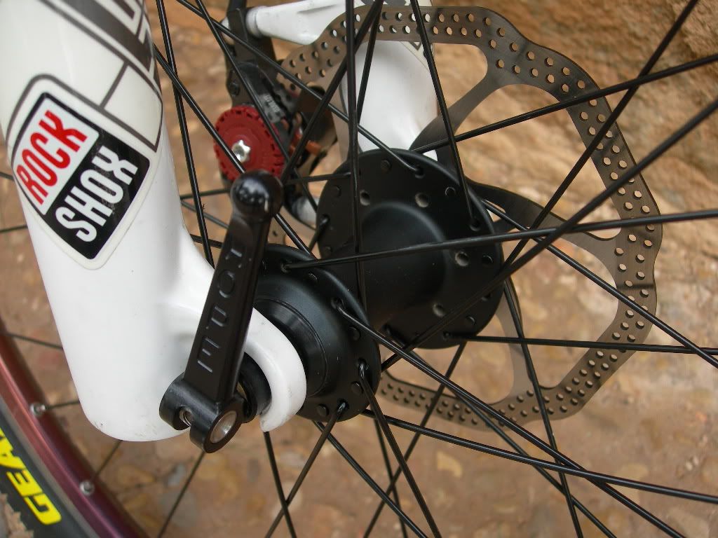

Front hub: bontrager disc (modern? not sure!)
Rear hub: shimano XT M750 (modern)
rims: mavic 217 sunset (1995)

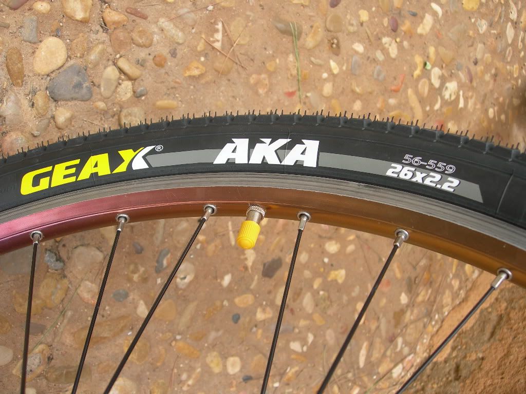

tyres: Geax AKA/Saguaro 2.1 (2012)
QR skewers: original hope (early 90's ?) and shimano XT M750

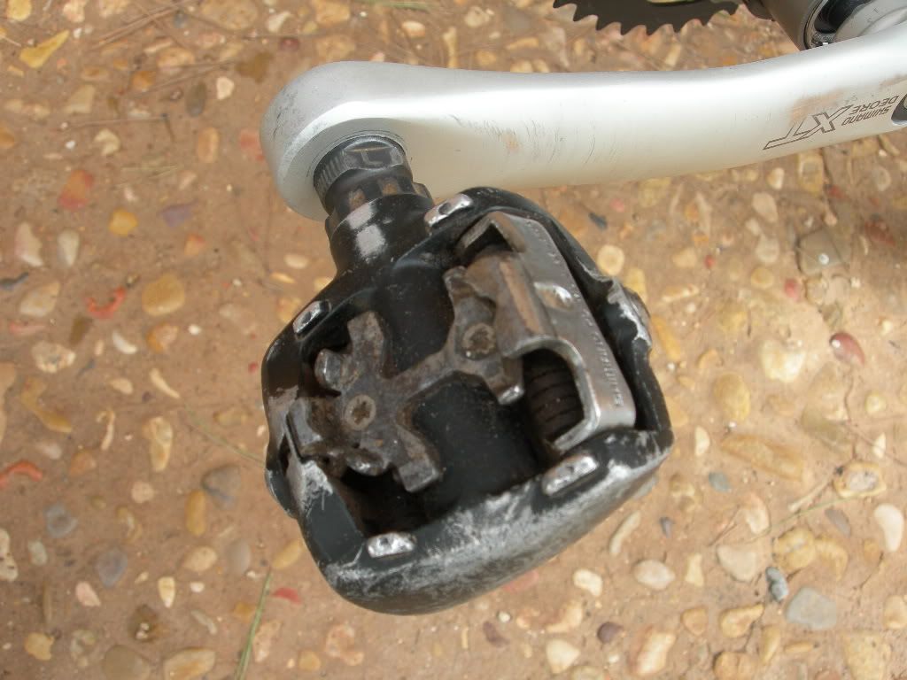

pedals: shimano M535 (I think), (1994)
I think that's everything!
