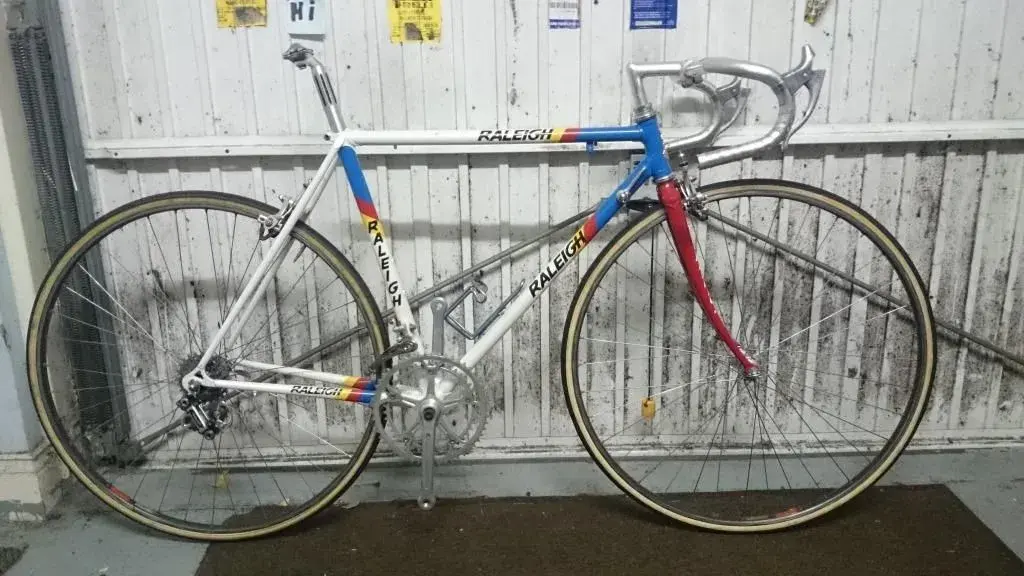

Update...
Frame arrived :) Surprisingly the fork numbers match. PJ2 87. I checked to see if the original number was possibly interfered with & ... no its good.
Slatanic":2y59j5ti said:
Update...
That's very good news :D
A quick dry build to see if everything fits... All good except....
I had a Campag Super Record Italian thread 115mm bottom bracket ready to go on the bike. The bike has Campag British thread 111mm bottom bracket (Sealed Bearing). :?
Also & I ran out of time to have a proper look but the crank arm securing bolts on the
Super Record axle do not fit the sealed bearing axle :?
So.... Can I assume its ok to fit the Super Record crankset to the 111mm BB ? & any information or gentle abuse on my lack of crank bolt knowledge would be greatly appreciated.
The front forks match but were definitely resprayed. The Rayleigh decals were not laquered & despite being a good paint job there is plenty overspray on the tube .
The wife is out of the house tonight so I can have a good look at things :D
Thanks Shane.
