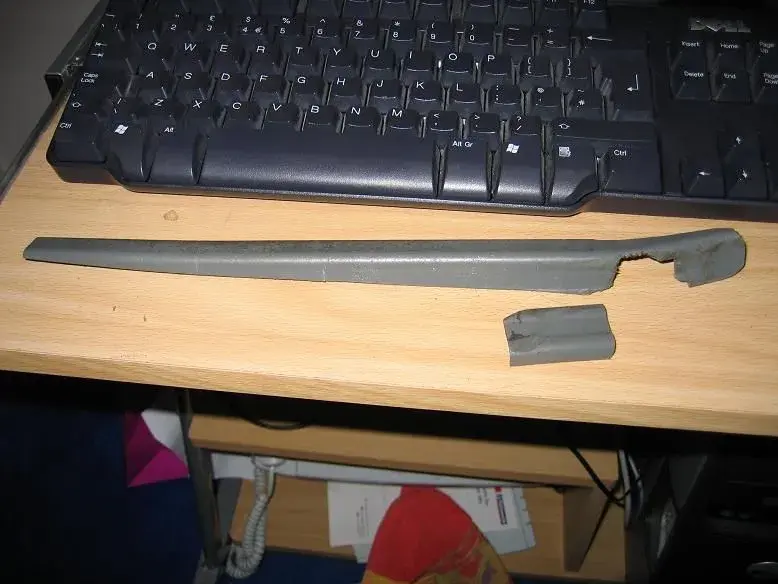

Eh up andy,
I have a complete chainstay protector and seatstay shield which i am trying to get copy's made. I will keep informed as I get more info!
