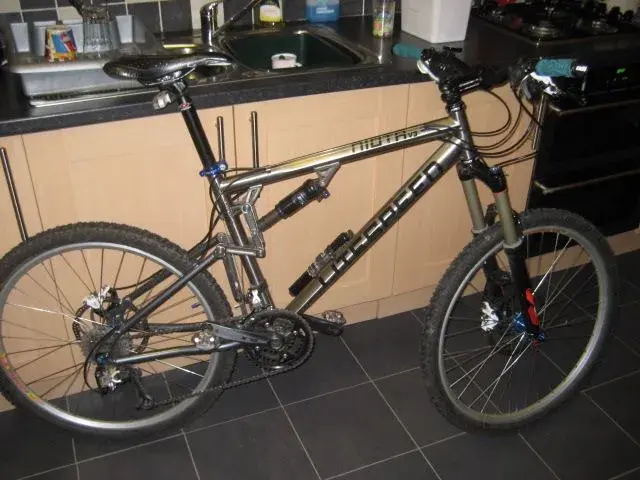

thought i'd put a pic of my other bike.
its nice to have the best of both worlds, this was my first full susser and was almost responsible for me turning my back on the retro bike world, but i have seen the error of my ways.
