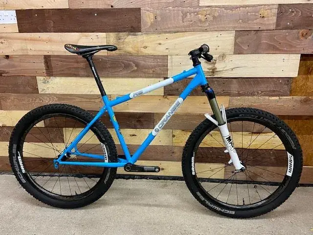

So I managed to pick a rather nice 17" R8 a week or so back - been keeping an eye out for a while.
I have a number of Sram X0 bits for it - but a lot of them have red highlights - which I'm not sure suit the light blue and white frame. I also have a set of black Magura - which won't really suit it either.
I do have a set of wheels that will suit the frame - but I have had major chuffing issues getting them to take a set of tubeless tyres - until today (more of that later)
As I type it - I'm kinda wondering why I'm bothering

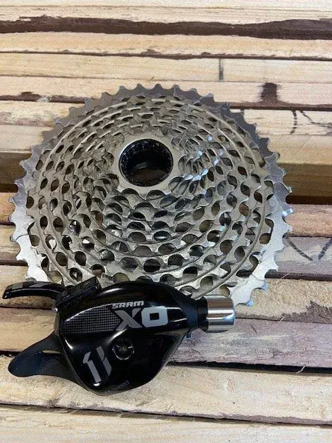

So out with the 3x9 Sram X0 - and there's 1x11 kit going on it. Partly cos the wheels are XD and I have a spare 42-10 cassette - and I have a set of XX1 cranks that are just too nice to leave idle.
I've manage to find a pair of 120mm Magura Durin - in white. I'm going 120mm instead of 100mm as two previous R8 owners were highly complimentary of the longer fork on it.
I'll throw some pics up tomorrow - and might just stand a chance of getting it done for this month's BOTM
