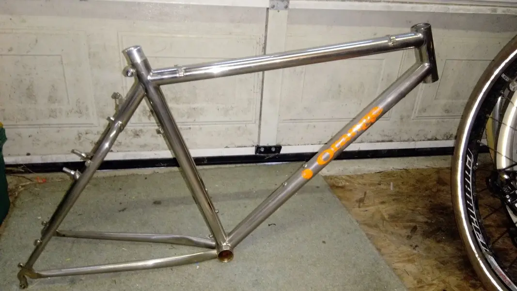

I've acquired a P7 frame, the serial number shows it as a December 1993, nickel plated. From Scant.
The plan was always to simple transfer all the parts from the X1 to a P7 and use it more often.
So that is still the plan.
I'm off to bed now, but here are a few pics of the frame.
It's in better condition than I had expected, just need a good clean, polish, new decals and a wax?
Not very exciting, but it's what I've got.
I may need some tips on dealing with the frame, polishing and sealing wise, I'd rather not clear coat it, just wax, is that ok?

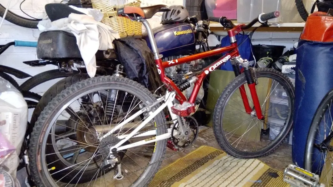

The Orange looks good. Seems a shame to split it? Also what is the Kawasaki? I am going to guess a GT due to the shocks on it.....
grey-beard
Orange 🍊 Fan
It is a shame to split it, but I don't ride it anymore, I won't get rid of the frame, know one would want it anyway, and if I don't get on with the P7 then I can always go back.
It's a GT750, it was a winter project about 2 years ago, that is on the list of things to get rid of too. Interested?

Lovely P7 - an Orange favourite and the one classic Orange which I have retained. Best treatment is Spontex cleaning balls (stainless steel swarf balls from any supermarket in the kitchen cleaning aisle) and GT85. Don’t use wire wool, just don’t. The chemistry is simple - the Spontex removes the rust through abrasion, without damaging the nickel, and the silicon in the GT85 leaches into the rust pits and repels water. It’s a simple, cheap and surprisingly enduring approach. There are some great build threads on here which have used this approach to very good effect.

Thanks, that's all very useful.

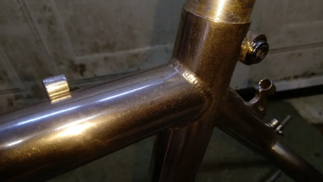

The problem I seem to have with the finish is that where the decals and front mech clamp have been removed, I'm left with a very shiny "shadow" which I can't seem to have any affect on. Autosol isn't touching it.
I'm wondering if there is still remnants of lacquer on there so I'll give the paint stripper a go next.
2manyoranges
Yes that shadow likely to be unoxidised lacquer, protected from UV by the stickers and mech clamp. Yep, the next step will be to remove the lacquer on all areas of the frame. Will you want to use it in wet conditions in future? My nickel P7 is a working bike which gets out in all sorts of rubbish weather. It’s had the lacquer removed, and I just clean and polish it with silicon polish every now and again (about every three years....) and the rusting is entirely stable.
