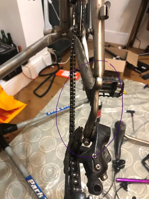

Hi, I'm new to the site so hopefully this is the right forum. I recently got hold of an Orange P7 from I think '95 but clearly didn't do my due diligence and turns out one of the rear dropouts is severely bent (see pic attached -- hopefully that's clear enough). I'm assuming this isn't salvageable (at least by me, anyway), but just wanted to check. Thanks in advance!
I've stuck one in a vice and straightened it up a bit before. I'm sure a bike shop will be able to do it more accurately too.
That should be salvageable. Cold setting is the term I've heard, but just means bending. However, toy don't want to bend it fast, this will weaken the metal more, take your time with whatever you choose to use to straighten it. I had to adjust a dropout a touch as it was a teeny bit off and found that a hub axle is the same thread as the mech hanger, so you can pop am axle in there and gently lever it back into position, slowly and carefully.
Steel frames are pretty robust, just bend it back carefully - I did it to my orange multiple times, in fact sometimes would tweak it mid ride with my heel to fix alignment issues
Your LBS should have the tool to do this correctly, I've called on them several times over the years & I prefer the shop and tool approach. Good mech alignment would makes all the difference and you also then know any remaining gear issues thereafter are not the fault of the frame anymore.
If the entire dropout is bent, you need a dropout alignment tool (or somebody who's got one).
Bending job doable with a couple monkey wrenches, but it's a real pain and you'll struggle with alignment. A dedicated tool is so much easier to use.
You'll probably need a hanger alignment tool too, after you've adjusted the dropouts.
Just make one......£4 ( well probably £6 now given price rises). Bit of old boxcand a fine thread bolt and a few nuts.....bobs your uncle.....etc.
If your going to bend it, put something in the tread......else it might start to deform / bend across the hole and then your going to be in trouble .
Im with LGF. Big big adjustable wrench, which should negate the above issue.
Deffo saveable.
