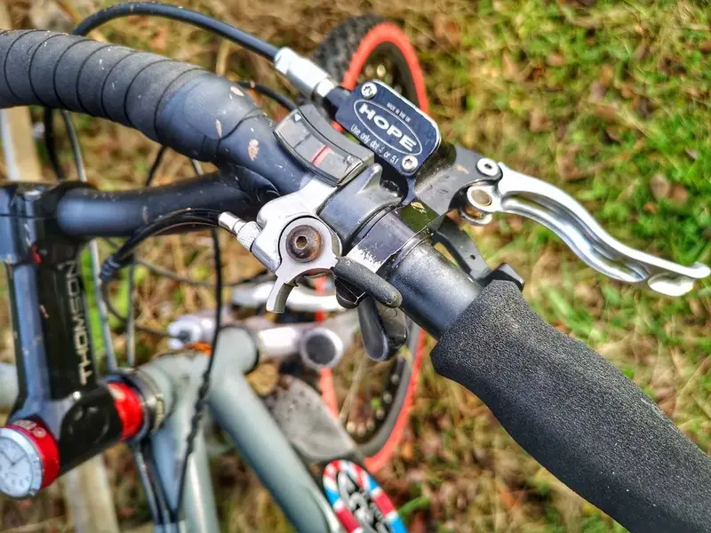

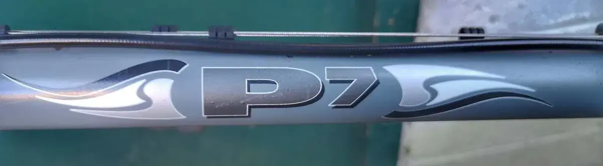

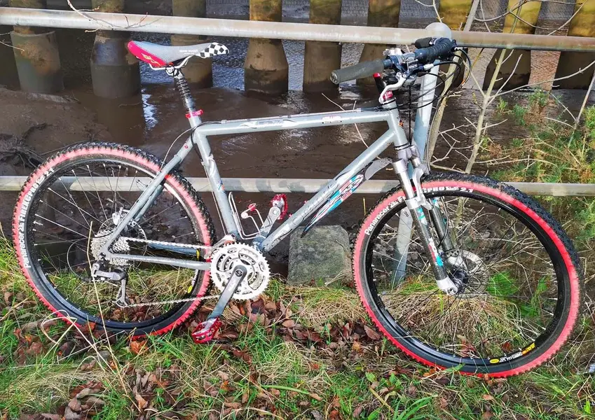

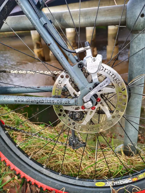

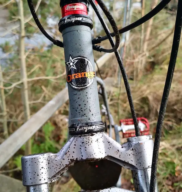

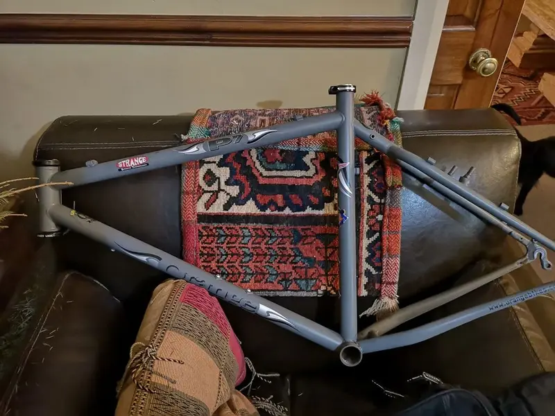

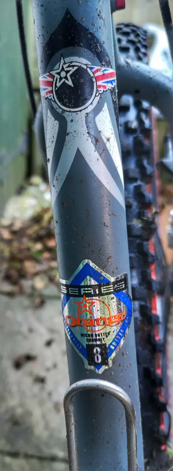

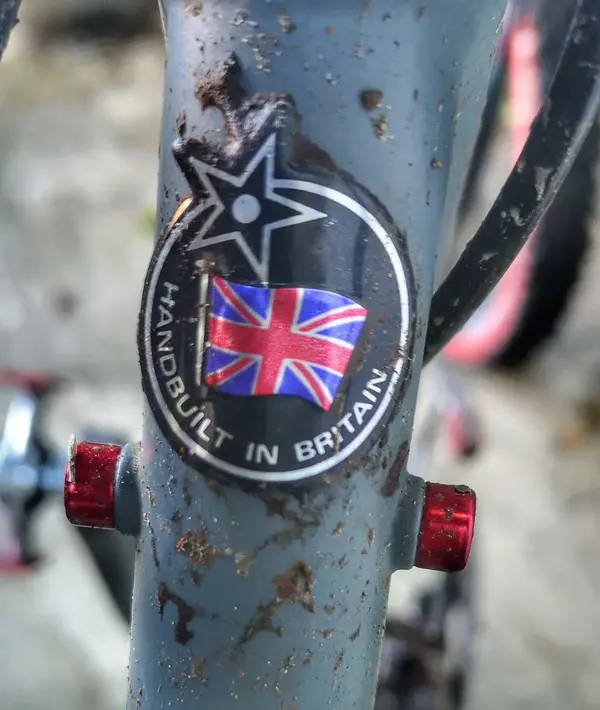

Bought this as a spare frame to put aside if my 2001 ever gets too far gone but can't resist building it up. Going to take advantage of the disc option. I love the decals on this. Going to winterfy the 2001 & run that in the grotty weather. frame.webp

Like the decals also. Super versatile frame and perfect for a winter bike.

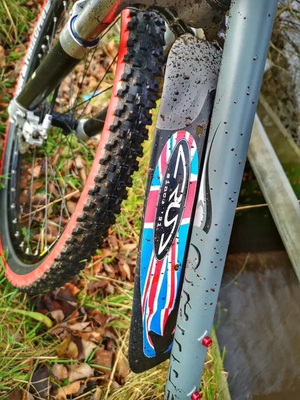

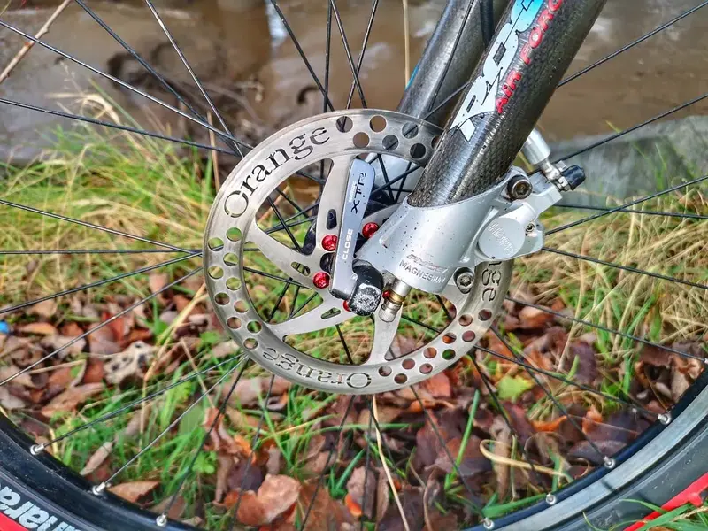

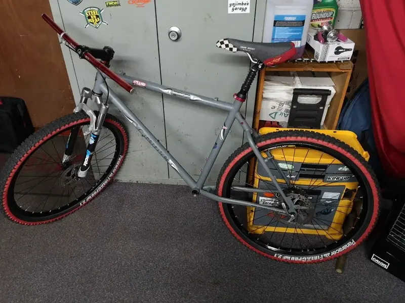

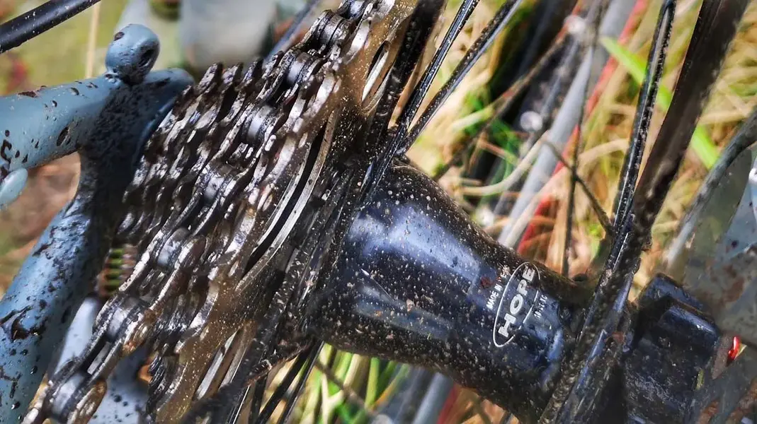

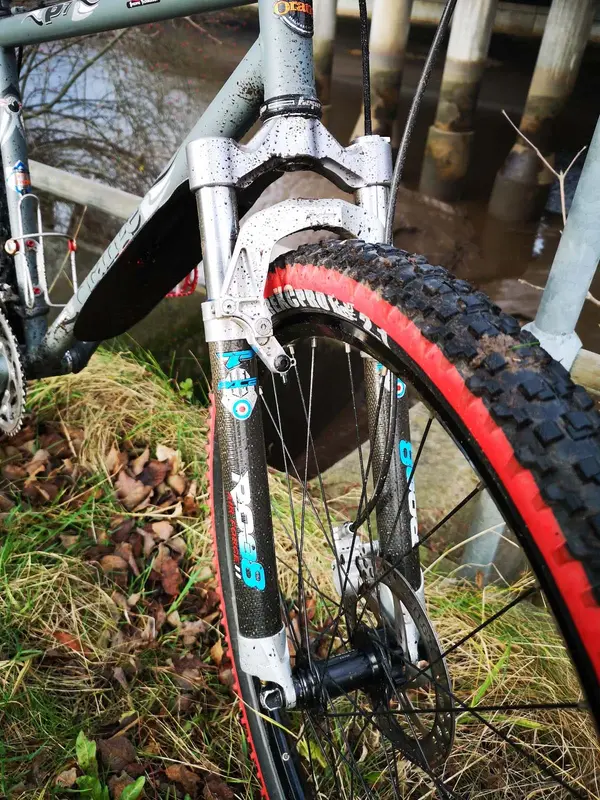

It's complete & rides like a dream. I kept the Renthal RC30 bars for another build. This is going to be the bikepacking bike & occasional snow & ice commuter as I have a spare disc wheelset with studded tyres.
Frame: 2002 Orange P7 19" YM201 (Jan 2002 Build)

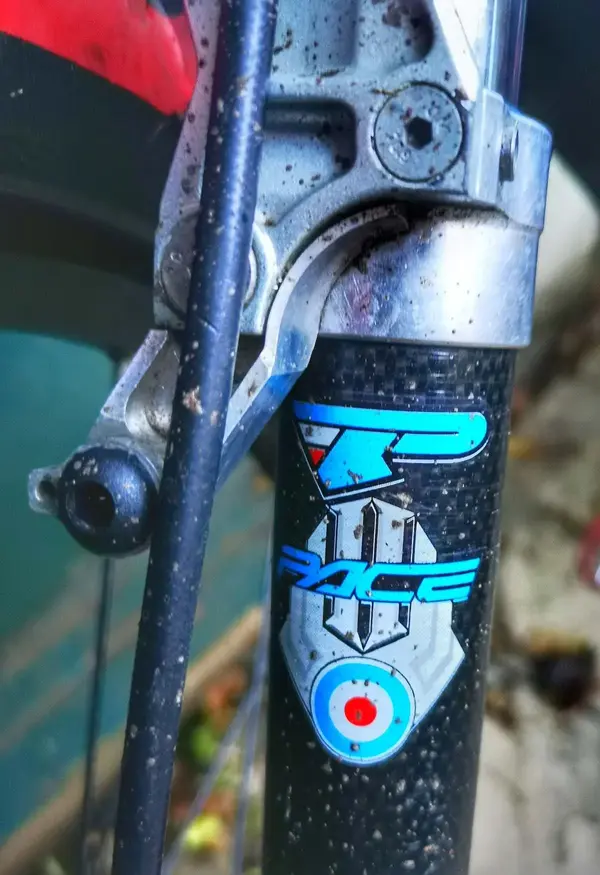

Fork: Pace RC36 EVOIII (disc) - updated 8/3/20
Headset: Hope (modern)
Stem: Thomson
Stem Cap: Stem Capt
Handlebar: Humpert Space Bugel
Grips: Ritchey
Brakes: Hope Mini 5 & 3
Brake Rotors: Orange 165
Brake Levers: Hope Mini
Shifters: Shimano XTR M952
Front Derailleur: Shimano XTR M953
Rear Derailleur: Shimano XTR M952
Cassette: Shimano HG50 9 Speed 11-32
Chain: KMC X9 93 9 speed
Cranks: XTR M952 175mm
Chainrings: Shimano XTR M952 46/34/24
Bottom Bracket: Shimano XTR M952 Octalink v1 68mm x 112.5mm
Pedals: MKS BM-7
Hub Skewers: Shimano XTR M950
Rims: Mavic XC717

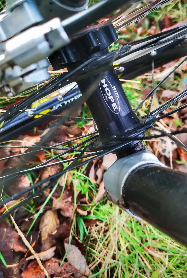

Hubs: Hope XC
Saddle: Selle SMP Lite 209 - updated 8/3/20
Seatpost: Ultimate Use Sumo XCR suspension 27.2mm
Seatpost Clamp: Hope
Bottlecage: Ciussi
Chainstay Guard: Shimano XT M730 Shark Fin
Front Mudguard: Crudcatcher
IMG_20191214_100727-01.jpeg.webp IMG_20191214_100804-01.jpeg.webp IMG_20191214_100814-01.jpeg.webp IMG_20191214_100844-01.jpeg.webp IMG_20191214_100854-02.jpeg.webp IMG_20191214_100915-01.jpeg.webp IMG_20191214_100929-01.jpeg.webp IMG_20191214_100959-01.jpeg.webp

Thanks. I was wondering if the bars might raise a few eyebrows! They are comfortable & hopefully good for lashing a drybag too.
