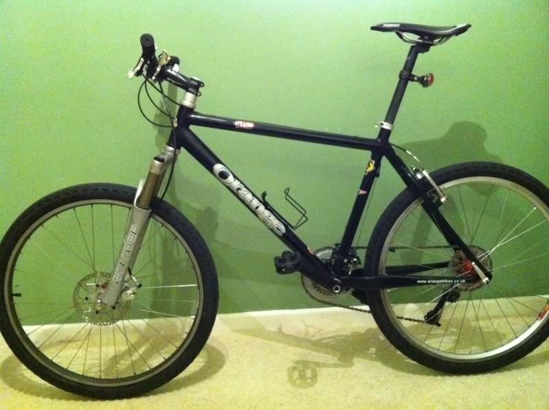

This one's mine.

Your bike could be a 2000 E4, but to be honest it looks more like a 2000 evO2 in that picture. The down tube decal is the same as on the 2000 evO2, but if they made some of the 2000 E4s in black (which I wasn't aware of), maybe they used the same decal. The picture of the E4 in the 2000 catalogue shows it in orange and no sign of any option colour. The picture of the evO2 is polished, with a black one shown as an option (see Archive section). That does look like an Easton Elite sticker on the seat tube though, I must admit, so if that is original it is an E4.

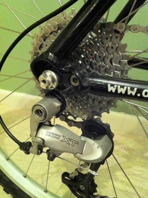

More detailed photos might help to identify it (in particular, the dropouts). Also the full serial number, as the number you quoted isn't the serial number.

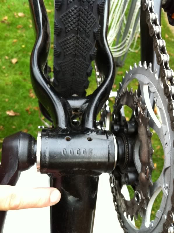

It did occur then that the Frame numbering then was a little TOO convenient, but having said that, the stamping seems extremely regular and well-spaced, and not like you'd get from some Herbert with a hammer in his garden shed.
This is the only number I can see :
(ignore the 'ding')

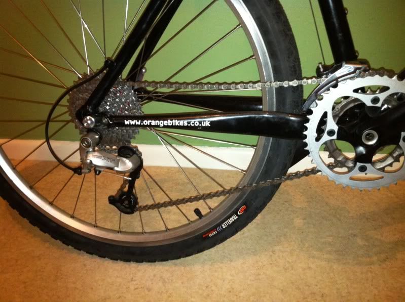

I'll upload some pics:
Looking at the Catalogue 'link' kindly supplied by sylus, I see what you mean that somebody could 're-badge' an O2, as they are nearly identical in dimensions, the E4 being a little lighter.
The O2 has pannier bracket lugs, which mine doesn't, but as they could have been ground off, I'll have to measure the seatpost diameter which would be impossible to 'fake' and should be the clincher.

OK, that is definitely a 2000 E4.
The serial number should be just visible along the non-drive side of the bb shell, sometimes easier to read if you shine a torch at an angle. I doubt whether it's going to indicate anything terribly special though - the 200 thing is just that there were only ever 200 E4s made each year (1998-2000 model years), and with the frames selling for £599 a piece that may have been just as well.

Ive just been out to the bike now and it's definately a 27mm seatpost
(to my eyes and tapemeasure)
