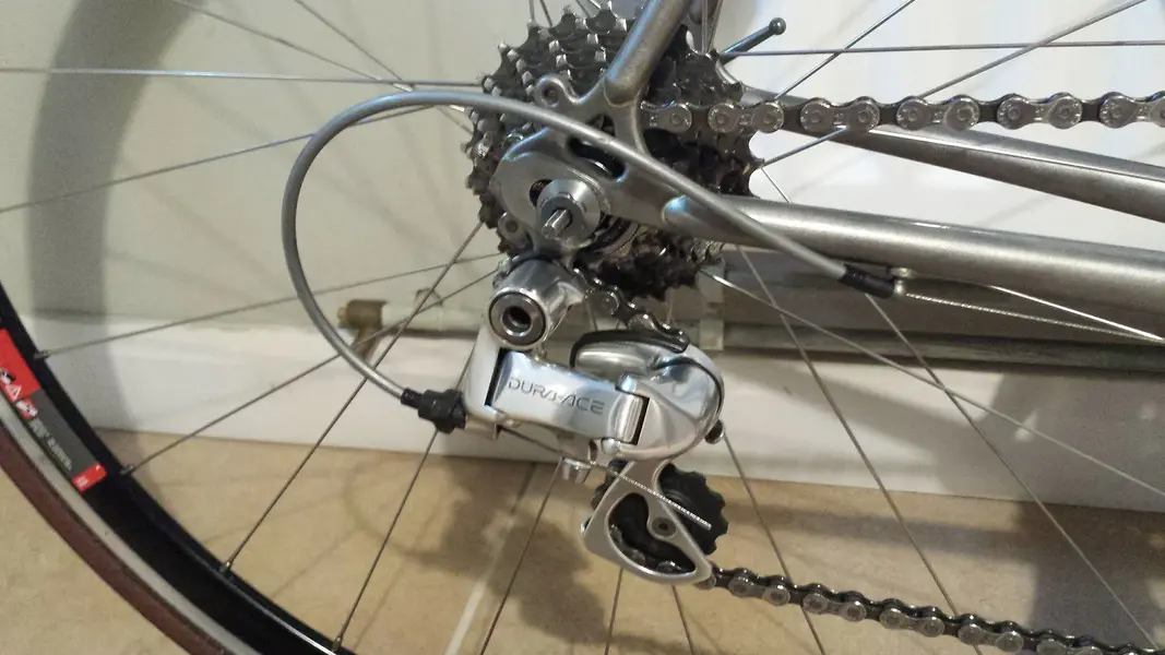

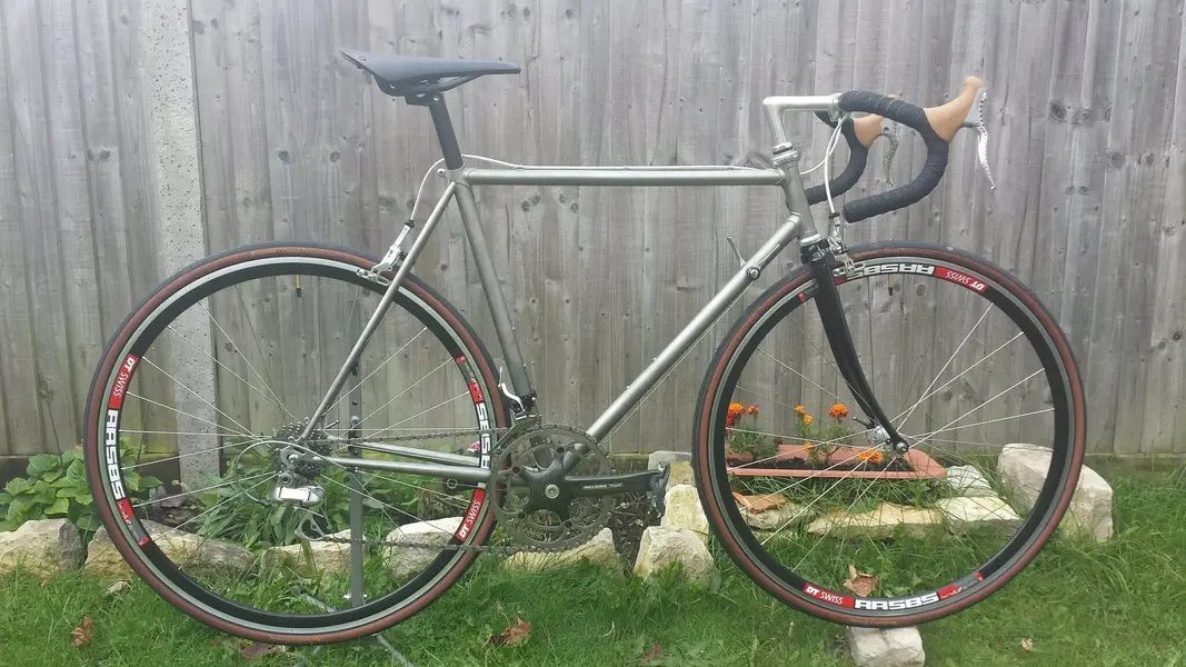

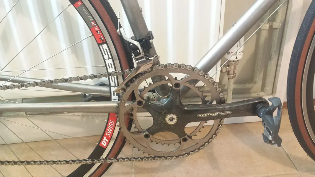

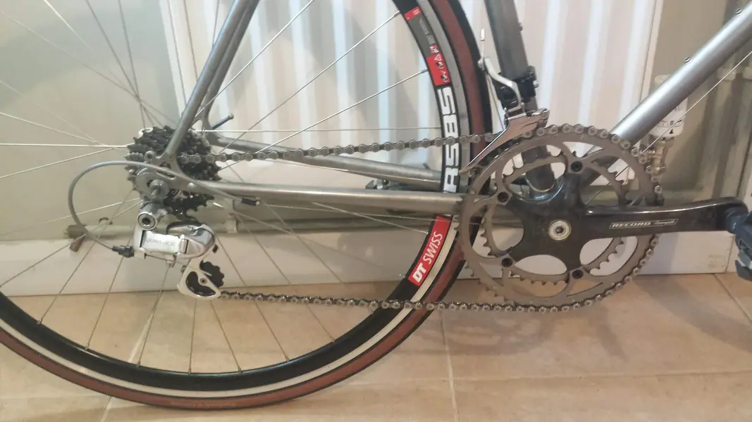

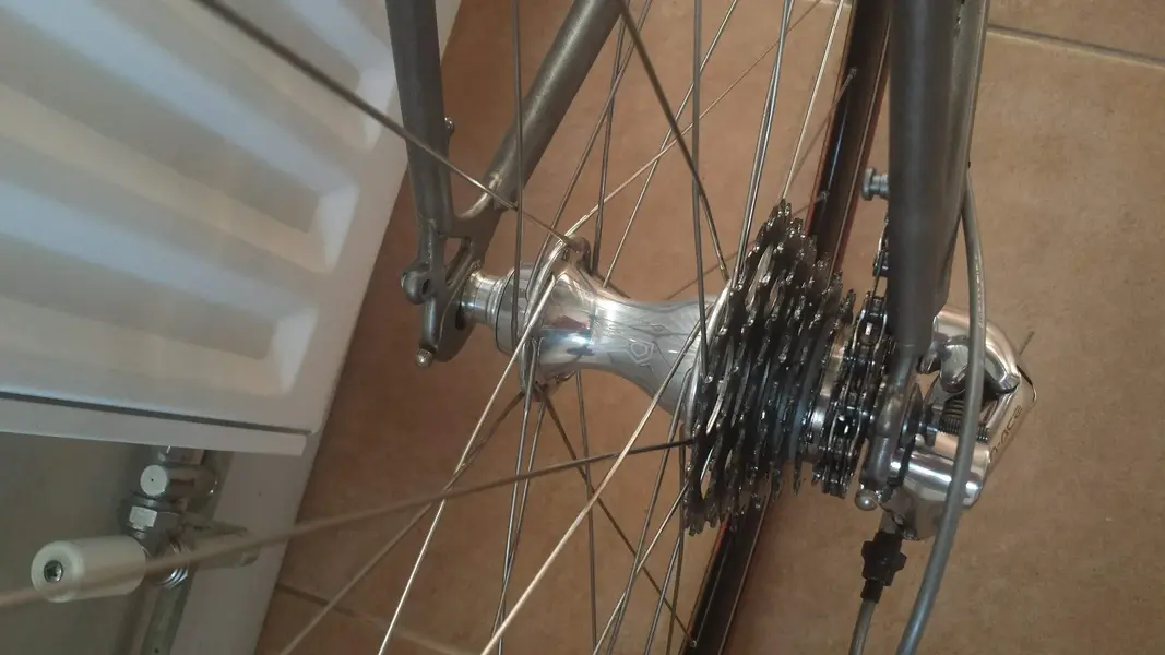

On my Ribble I wanted to run an 8-speed cassette with a Dura Ace 9-speed rear mech which is okay but the 10-speed Dura Ace down tube shifters were the problem. When I bought them cheap on eBay (£30 i think) my thinking was that they are the same pull ratio as 8-9 speed.... they aren't, the cassette spacing on 8-9-10 speed is different as I found out when they didn't work, I put it down to an impulse purchase senior moment 🥴 Any way all was not lost, by moving the cable on the rear mech to pull from the top of the clamp bolt instead of below they index perfectly..phew. So a bit of a weird setup on the Ribble with Dura Ace 9-speed rear mech, Dura Ace 11-speed front mech, Dura Ace 10-speed shifters, Shimano 8-speed cassette, KMC 8-speed chain and the ultimate sin.. a Campagnolo Record Carbon 10-speed chainset which all seems to work more by luck than judgment 👍

Ok, don’t do that ^ :D
Make your life easier and use:
-8-speed cassette with 8–speed shifters
-9-speed cassette with 9-speed shifters
-10-speed cassette with, well, you can see where I’m going here.
You can’t use 10-speed shifters with an 8-speed cassette. The pull ratio is the same, but the gear spacing is different. It won’t index. But, @vcballbat a 10-speed cassette will fit in the same space as an 8-speed so you could just switch to a 10-speed cassette and it’ll all work correctly. You might need to swap the chain too because I think 10-speed chains have flush rivets to clear the tighter spacing
